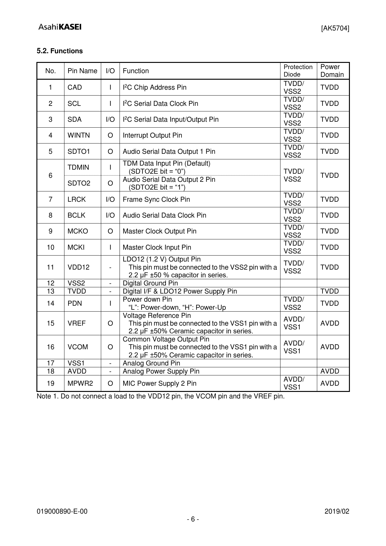

5.2. Functions
[AK5704]
5.2. Functions
Protection Power No. Pin Name I/O Function Diode Domain TVDD/ 1 CAD I I2C Chip Address Pin TVDD VSS2 TVDD/ 2 SCL I I2C Serial Data Clock Pin TVDD VSS2 TVDD/ 3 SDA I/O I2C Serial Data Input/Output Pin TVDD VSS2 TVDD/ 4 WINTN O Interrupt Output Pin TVDD VSS2 TVDD/ 5 SDTO1 O Audio Serial Data Output 1 Pin TVDD VSS2 TDM Data Input Pin (Default) TDMIN I (SDTO2E bit = “0”) TVDD/ 6 TVDD Audio Serial Data Output 2 Pin VSS2 SDTO2 O (SDTO2E bit = “1”) TVDD/ 7 LRCK I/O Frame Sync Clock Pin TVDD VSS2 TVDD/ 8 BCLK I/O Audio Serial Data Clock Pin TVDD VSS2 TVDD/ 9 MCKO O Master Clock Output Pin TVDD VSS2 TVDD/ 10 MCKI I Master Clock Input Pin TVDD VSS2 LDO12 (1.2 V) Output Pin TVDD/ 11 VDD12 - This pin must be connected to the VSS2 pin with a TVDD 2.2 μF ±50 % capacitor in series. VSS2 12 VSS2 - Digital Ground Pin 13 TVDD - Digital I/F & LDO12 Power Supply Pin TVDD Power down Pin TVDD/ 14 PDN I “L”: Power TVDD -down, “H”: Power-Up VSS2 Voltage Reference Pin AVDD/ 15 VREF O This pin must be connected to the VSS1 pin with a AVDD VSS1 2.2 μF ±50% Ceramic capacitor in series. Common Voltage Output Pin AVDD/ 16 VCOM O This pin must be connected to the VSS1 pin with a AVDD 2.2 μF VSS1 ±50% Ceramic capacitor in series. 17 VSS1 - Analog Ground Pin 18 AVDD - Analog Power Supply Pin AVDD AVDD/ 19 MPWR2 O MIC Power Supply 2 Pin AVDD VSS1 Note 1. Do not connect a load to the VDD12 pin, the VCOM pin and the VREF pin. 019000890-E-00 2019/02 - 6 - Document Outline 1. General Description 2. Features 3. Table of Contents 4. Block Diagram 5. Pin Configurations and Functions 5.1. Pin Configurations 5.2. Functions 5.3. Handling of Unused Pin 5.4. Pin State In Power-down Mode 6. Absolute Maximum Ratings 7. Recommended Operating Conditions 8. Electrical Characteristics 8.1. Microphone & ADC Analog Characteristics (AVDD=3.3V: AVDDL bit = “0”) 8.2. Microphone & ADC Analog Characteristics (AVDD=1.8V: AVDDL bit = “1”) 8.3. Power Supply Current 8.4. Power Consumption for Each Operation Mode 8.5. ADC1/2 Short Delay Sharp Roll-off Filter (ADVF bit = “0”) 8.6. ADC1/2 Digital Filter for Voice (ADVF bit = “1”) 8.7. DC Characteristics 8.8. Switching Characteristics 9. Functional Descriptions 9.1. Internal Pull-down Pin 9.2. LDO Circuit 9.3. System Clock 9.4. PLL 1. PLL Output Frequency (MCKO pin) 2. BCLK Output Frequency 3. Internal Block Diagram of PLL (3-1) PLL Reference Clock Divider (PLD) (3-2) PLL Feedback Clock Divider (PLM) 4. Adaptive Frequencies 5. Example of PLL Frequency Setting 9.5. Audio Interface Format 9.6. Synchronization with audio system (SYNCDET) 9.7. MIC/LINE Input 9.8. Microphone Amplifier Gain 9.9. Microphone Power 9.10. MIC Input Start-Up Time 9.11. ADC1/2 Initialization Cycle 9.12. Mono/Stereo Mode 9.13. Digital Microphone 9.14. Digital Block 9.14.1. Programmable Phase Adjustment 9.14.2. High Pass Filter (ADC1/2) 9.14.3. ADC1/2 Digital Filter 9.14.4. Microphone Sensitivity Adjustment 9.14.5. Monaural (MIX) Selection 9.14.6. High Pass Filter (HPF1/2) 9.14.7. Low Pass Filter (LPF1/2) 9.14.8. ALC Operation 9.14.9. Input Digital Volume (Manual Mode) 9.14.10. ALC 4ch Link Mode Sequence 9.15. Digital Voice Activity Detector 9.15.1. VDLY 9.15.2. HPF, LPF 9.15.3. ABS 9.15.4. NLD (Noise Level Detector) 9.15.5. MAX 9.15.6. MULT (X) 9.15.7. Comparator (>) 9.15.8. Guard Timer 9.15.9. Interrupt Output (WINTN pin) 9.15.10. Output Selector 9.16. I2C-bus Control Interface 9.17. Register Map 9.18. Register Definition 10. Recommended External Circuits 11. Control Sequence 11.1. Clock Set Up 11.1.1. PLL Master Mode 11.1.2. PLL Slave Mode (BCLK pin) 11.1.3. PLL Slave Mode (MCKI pin) 11.1.4. External Slave Mode 11.1.5. External Master Mode 11.2. Voice Activity Detection (1ch Mic) 11.3. Microphone Input Recording (4ch) 11.4. Stop of Clock 11.4.1. PLL Master Mode 11.4.2. PLL Slave Mode (BCLK pin) 11.4.3. PLL Slave Mode (MCKI pin) 11.4.4. External Slave Mode 11.4.5. External Master Mode 11.5. Power Down 12. Package 12.1. Outline Dimensions 12.2. Material & Lead finish 12.3. Marking 13. Ordering Guide 14. Revision History IMPORTANT NOTICE
