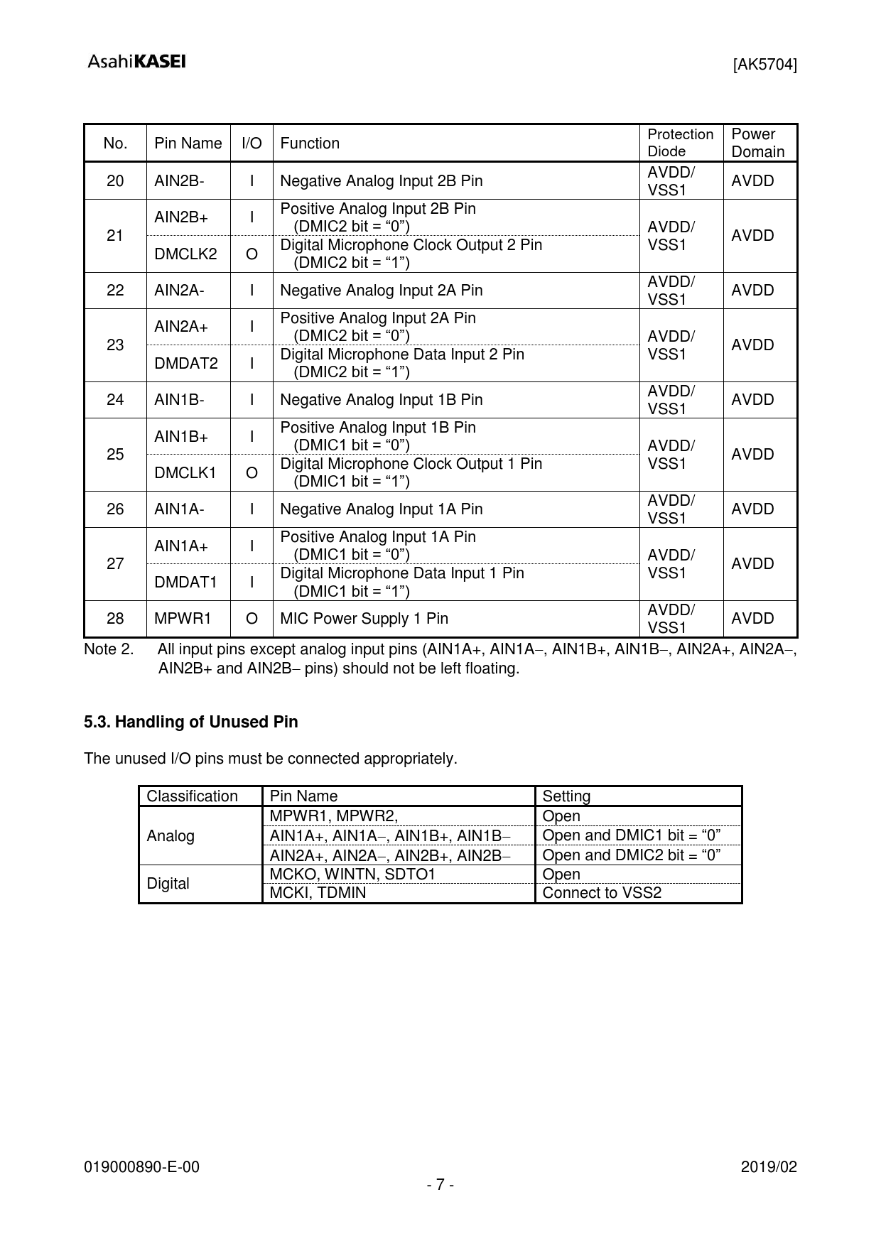

5.3. Handling of Unused Pin
5.3 Handling of Unused Pin
[AK5704] Protection Power No. Pin Name I/O Function Diode Domain AVDD/ 20 AIN2B- I Negative Analog Input 2B Pin AVDD VSS1 Positive Analog Input 2B Pin AIN2B+ I (DMIC2 bit = “0”) AVDD/ 21 AVDD Digital Microphone Clock Output 2 Pin VSS1 DMCLK2 O (DMIC2 bit = “1”) AVDD/ 22 AIN2A- I Negative Analog Input 2A Pin AVDD VSS1 Positive Analog Input 2A Pin AIN2A+ I (DMIC2 bit = “0”) AVDD/ 23 AVDD Digital Microphone Data Input 2 Pin VSS1 DMDAT2 I (DMIC2 bit = “1”) AVDD/ 24 AIN1B- I Negative Analog Input 1B Pin AVDD VSS1 Positive Analog Input 1B Pin AIN1B+ I (DMIC1 bit = “0”) AVDD/ 25 AVDD Digital Microphone Clock Output 1 Pin VSS1 DMCLK1 O (DMIC1 bit = “1”) AVDD/ 26 AIN1A- I Negative Analog Input 1A Pin AVDD VSS1 Positive Analog Input 1A Pin AIN1A+ I (DMIC1 bit = “0”) AVDD/ 27 AVDD Digital Microphone Data Input 1 Pin VSS1 DMDAT1 I (DMIC1 bit = “1”) AVDD/ 28 MPWR1 O MIC Power Supply 1 Pin AVDD VSS1 Note 2. All input pins except analog input pins (AIN1A+, AIN1A, AIN1B+, AIN1B, AIN2A+, AIN2A, AIN2B+ and AIN2B pins) should not be left floating.
The unused I/O pins must be connected appropriately. Classification Pin Name Setting MPWR1, MPWR2, Open Analog AIN1A+, AIN1A, AIN1B+, AIN1B Open and DMIC1 bit = “0” AIN2A+, AIN2A, AIN2B+, AIN2B Open and DMIC2 bit = “0” MCKO, WINTN, SDTO1 Open Digital MCKI, TDMIN Connect to VSS2 019000890-E-00 2019/02 - 7 - Document Outline 1. General Description 2. Features 3. Table of Contents 4. Block Diagram 5. Pin Configurations and Functions 5.1. Pin Configurations 5.2. Functions 5.3. Handling of Unused Pin 5.4. Pin State In Power-down Mode 6. Absolute Maximum Ratings 7. Recommended Operating Conditions 8. Electrical Characteristics 8.1. Microphone & ADC Analog Characteristics (AVDD=3.3V: AVDDL bit = “0”) 8.2. Microphone & ADC Analog Characteristics (AVDD=1.8V: AVDDL bit = “1”) 8.3. Power Supply Current 8.4. Power Consumption for Each Operation Mode 8.5. ADC1/2 Short Delay Sharp Roll-off Filter (ADVF bit = “0”) 8.6. ADC1/2 Digital Filter for Voice (ADVF bit = “1”) 8.7. DC Characteristics 8.8. Switching Characteristics 9. Functional Descriptions 9.1. Internal Pull-down Pin 9.2. LDO Circuit 9.3. System Clock 9.4. PLL 1. PLL Output Frequency (MCKO pin) 2. BCLK Output Frequency 3. Internal Block Diagram of PLL (3-1) PLL Reference Clock Divider (PLD) (3-2) PLL Feedback Clock Divider (PLM) 4. Adaptive Frequencies 5. Example of PLL Frequency Setting 9.5. Audio Interface Format 9.6. Synchronization with audio system (SYNCDET) 9.7. MIC/LINE Input 9.8. Microphone Amplifier Gain 9.9. Microphone Power 9.10. MIC Input Start-Up Time 9.11. ADC1/2 Initialization Cycle 9.12. Mono/Stereo Mode 9.13. Digital Microphone 9.14. Digital Block 9.14.1. Programmable Phase Adjustment 9.14.2. High Pass Filter (ADC1/2) 9.14.3. ADC1/2 Digital Filter 9.14.4. Microphone Sensitivity Adjustment 9.14.5. Monaural (MIX) Selection 9.14.6. High Pass Filter (HPF1/2) 9.14.7. Low Pass Filter (LPF1/2) 9.14.8. ALC Operation 9.14.9. Input Digital Volume (Manual Mode) 9.14.10. ALC 4ch Link Mode Sequence 9.15. Digital Voice Activity Detector 9.15.1. VDLY 9.15.2. HPF, LPF 9.15.3. ABS 9.15.4. NLD (Noise Level Detector) 9.15.5. MAX 9.15.6. MULT (X) 9.15.7. Comparator (>) 9.15.8. Guard Timer 9.15.9. Interrupt Output (WINTN pin) 9.15.10. Output Selector 9.16. I2C-bus Control Interface 9.17. Register Map 9.18. Register Definition 10. Recommended External Circuits 11. Control Sequence 11.1. Clock Set Up 11.1.1. PLL Master Mode 11.1.2. PLL Slave Mode (BCLK pin) 11.1.3. PLL Slave Mode (MCKI pin) 11.1.4. External Slave Mode 11.1.5. External Master Mode 11.2. Voice Activity Detection (1ch Mic) 11.3. Microphone Input Recording (4ch) 11.4. Stop of Clock 11.4.1. PLL Master Mode 11.4.2. PLL Slave Mode (BCLK pin) 11.4.3. PLL Slave Mode (MCKI pin) 11.4.4. External Slave Mode 11.4.5. External Master Mode 11.5. Power Down 12. Package 12.1. Outline Dimensions 12.2. Material & Lead finish 12.3. Marking 13. Ordering Guide 14. Revision History IMPORTANT NOTICE
