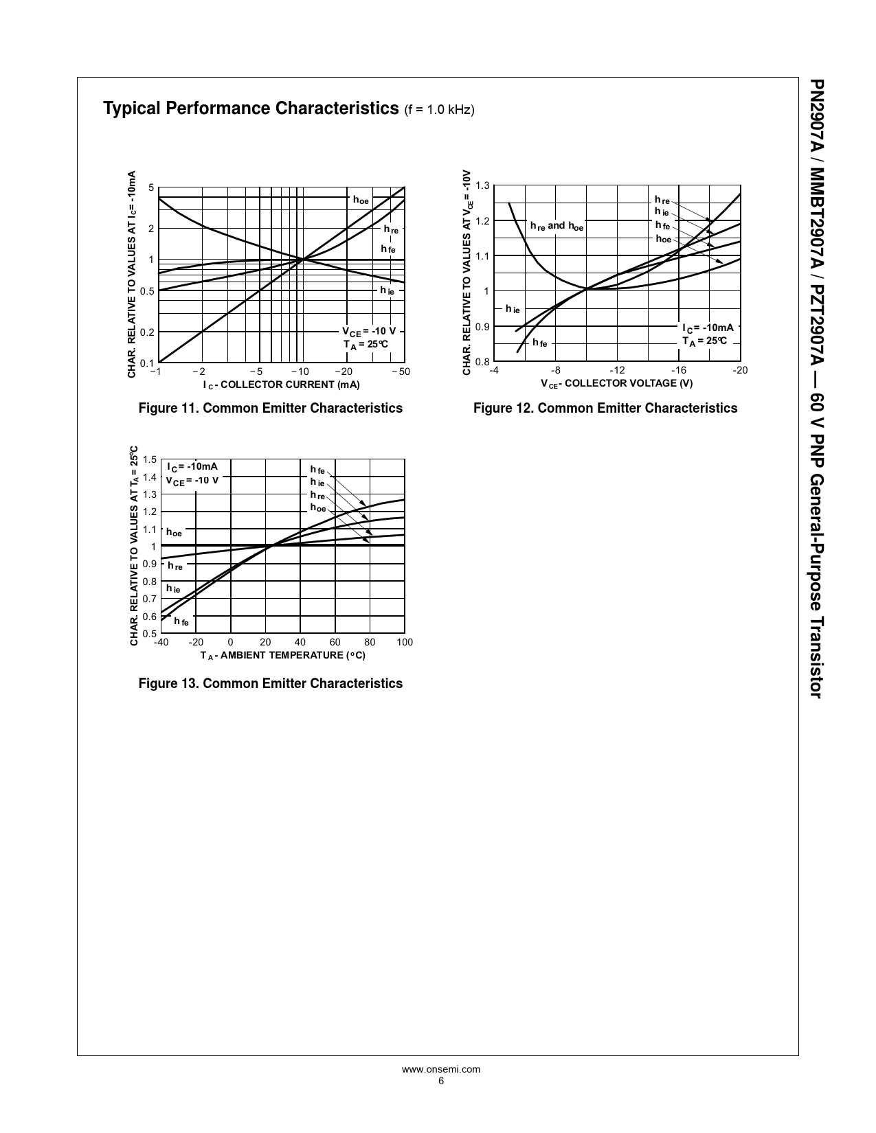

PN290. Typical Performance Characteristics. 7A / MMBT2907A / PZT2. hoe. h re. = CE. h ie. re an. d hoe. h fe. AT I. hre. IVE. 907A — 60. V = -10 V
PN290 Typical Performance Characteristics
(f = 1.0 kHz)
7A / MMBT2907A / PZT2 A V m 0 0
5
1
1.3
- -1 hoe h re = = CE C V h ie T
1.2 2
h re an d hoe h fe AT I hre A S hoe E h ES U fe U L
1
L
1.1
A A V V O O T
0.5
h ie T
1
IVE IVE h T T ie A A 907A — 60 L
0.2 0.9
V = -10 V I = -10mA CE C o h T = 25 C o . RE T = 25 C A . REL fe A AR
0.1
AR
0.8 1 2
_ _
5
_
10
_
20
_
50
_ H C
-4 -8 -12 -16 -20
CH I - V - CE COLLECTOR VOLTAGE (V) C COLLECTOR CURRENT (mA) Figure 11. Common Emitter Characteristics Figure 12. Common Emitter Characteristics V PNP Gene o C
1.5
25 I = -10mA C h fe =A
1.4
V = -10 V T CE h ie T
1.3
h A re
1.2
hoe ES ra LU
1.1
l-Pu A hoe V
1
TO rpose T
0.9
E h re V TI
0.8
h LA ie
0.7
E . R
0.6
R h fe r A ansistor H
0.5
C
-40 -20 0 20 40 60 80 100
T - o A AMBIENT TEMPERATURE ( C) Figure 13. Common Emitter Characteristics
