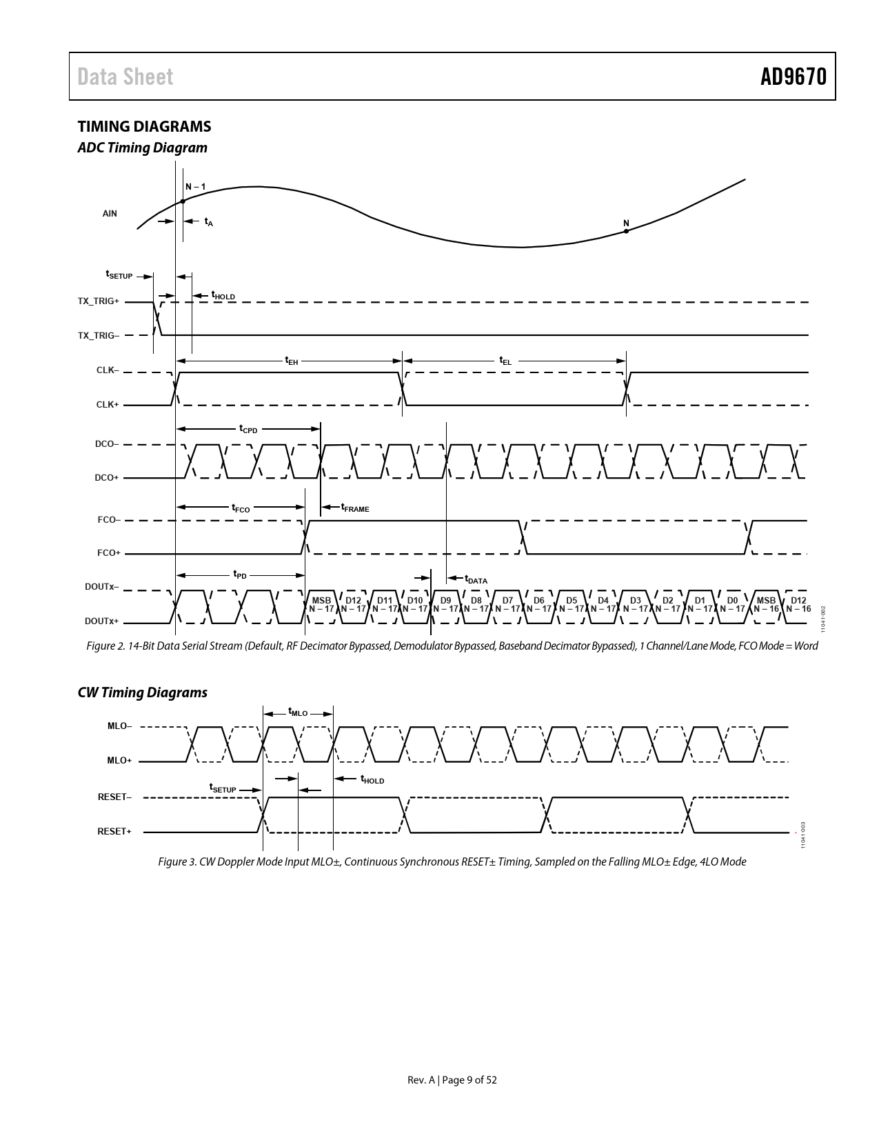

Data Sheet. AD9670. TIMING DIAGRAMS. ADC Timing Diagram. N – 1. AIN. tSETUP. TX_TRIG+. HOLD. TX_TRIG–. tEH. tEL. CLK–. CLK+. tCPD. DCO–. DCO+. FCO. FRAME
Data Sheet AD9670 TIMING DIAGRAMS ADC Timing Diagram N – 1 AIN tSETUP TX_TRIG+ HOLD TX_TRIG– tEH tEL CLK– CLK+ tCPD DCO– DCO+ FCO FRAME
Data Sheet AD9670 TIMING DIAGRAMS ADC Timing Diagram N – 1 AIN tA N tSETUP t TX_TRIG+ HOLD TX_TRIG– tEH tEL CLK– CLK+ tCPD DCO– DCO+ t t FCO FRAME FCO– FCO+ tPD tDATA DOUTx– MSB D12 D11 D10 D9 D8 D7 D6 D5 D4 D3 D2 D1 D0 MSB D12 N – 17 N – 17 N – 17 N – 17 N – 17 N – 17 N – 17 N – 17 N – 17 N – 17 N – 17 N – 17 N – 17 N – 17 N – 16 N – 16
2 00
DOUTx+
1- 04 11 Figure 2. 14-Bit Data Serial Stream (Default, RF Decimator Bypassed, Demodulator Bypassed, Baseband Decimator Bypassed), 1 Channel/Lane Mode, FCO Mode = Word
CW Timing Diagrams tMLO MLO– MLO+ tHOLD tSETUP RESET–
