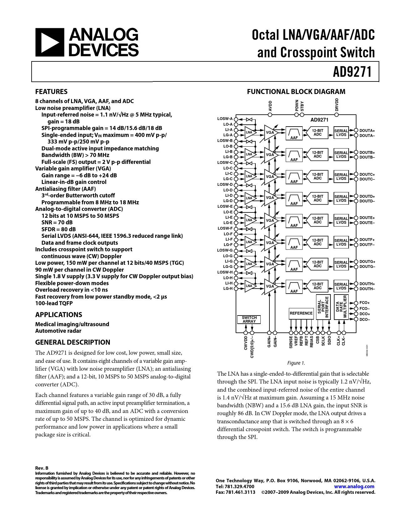

Octal LNA/VGA/AAF/ADC. and Crosspoint Switch. AD9271. FEATURES. FUNCTIONAL BLOCK DIAGRAM. 8 channels of LNA, VGA, AAF, and ADC
Datasheet AD9271 Analog Devices, Revision: B
Octal LNA/VGA/AAF/ADC and Crosspoint Switch AD9271 FEATURES FUNCTIONAL BLOCK DIAGRAM 8 channels of LNA, VGA, AAF, and ADC D N DD D BY V Low noise preamplifier (LNA) AV PDW ST DR Input-referred noise = 1.1 nV/√Hz @ 5 MHz typical, LOSW-A gain = 18 dB AD9271 LO-A SPI-programmable gain = 14 dB/15.6 dB/18 dB LI-A 12-BIT SERIAL DOUTA+ Single-ended input; V LNA VGA IN maximum = 400 mV p-p/ LG-A ADC LVDS DOUTA– AAF 333 mV p-p/250 mV p-p LOSW-B Dual-mode active input impedance matching LO-B LI-B DOUTB+ Bandwidth (BW) > 70 MHz 12-BIT LNA SERIAL VGA LG-B ADC LVDS DOUTB– Full-scale (FS) output = 2 V p-p differential AAF LOSW-C Variable gain amplifier (VGA) LO-C Gain range = −6 dB to +24 dB LI-C 12-BIT DOUTC+ LNA SERIAL VGA LG-C ADC LVDS DOUTC– Linear-in-dB gain control AAF LOSW-D Antialiasing filter (AAF) LO-D 3rd-order Butterworth cutoff LI-D 12-BIT DOUTD+ LNA SERIAL VGA Programmable from 8 MHz to 18 MHz LG-D ADC LVDS DOUTD– AAF Analog-to-digital converter (ADC) LOSW-E LO-E 12 bits at 10 MSPS to 50 MSPS LI-E 12-BIT SERIAL DOUTE+ SNR = 70 dB LNA VGA LG-E ADC LVDS DOUTE– AAF SFDR = 80 dB LOSW-F Serial LVDS (ANSI-644, IEEE 1596.3 reduced range link) LO-F LI-F DOUTF+ Data and frame clock outputs 12-BIT LNA SERIAL VGA LG-F ADC LVDS DOUTF– Includes crosspoint switch to support AAF LOSW-G continuous wave (CW) Doppler LO-G Low power, 150 mW per channel at 12 bits/40 MSPS (TGC) LI-G 12-BIT DOUTG+ LNA SERIAL VGA LG-G ADC LVDS DOUTG– 90 mW per channel in CW Doppler AAF LOSW-H Single 1.8 V supply (3.3 V supply for CW Doppler output bias) LO-H Flexible power-down modes LI-H 12-BIT DOUTH+ LNA SERIAL VGA Overload recovery in <10 ns LG-H ADC LVDS DOUTH– AAF Fast recovery from low power standby mode, <2 μs E R C E 100-lead TQFP L A E LI FCO+ IA A RT F T IP R FCO– PO DA RAT LT APPLICATIONS SER REFERENCE TE U DCO+ IN SWITCH M DCO– ARRAY Medical imaging/ultrasound Automotive radar D + /– B T K + D SE EF F F IO GENERAL DESCRIPTION K K IN IN IAS V N CSB 0]+ VR RE RE SD SCL CL CL GA GA RB SE
01
CW
0 The AD9271 is designed for low cost, low power, small size,
D[5: W
304-
C
06 and ease of use. It contains eight channels of a variable gain amp- Figure 1. lifier (VGA) with low noise preamplifier (LNA); an antialiasing filter (AAF); and a 12-bit, 10 MSPS to 50 MSPS analog-to-digital The LNA has a single-ended-to-differential gain that is selectable converter (ADC). through the SPI. The LNA input noise is typically 1.2 nV/√Hz, and the combined input-referred noise of the entire channel Each channel features a variable gain range of 30 dB, a fully is 1.4 nV/√Hz at maximum gain. Assuming a 15 MHz noise differential signal path, an active input preamplifier termination, a bandwidth (NBW) and a 15.6 dB LNA gain, the input SNR is maximum gain of up to 40 dB, and an ADC with a conversion roughly 86 dB. In CW Doppler mode, the LNA output drives a rate of up to 50 MSPS. The channel is optimized for dynamic transconductance amp that is switched through an 8 × 6 performance and low power in applications where a small differential crosspoint switch. The switch is programmable package size is critical. through the SPI.
