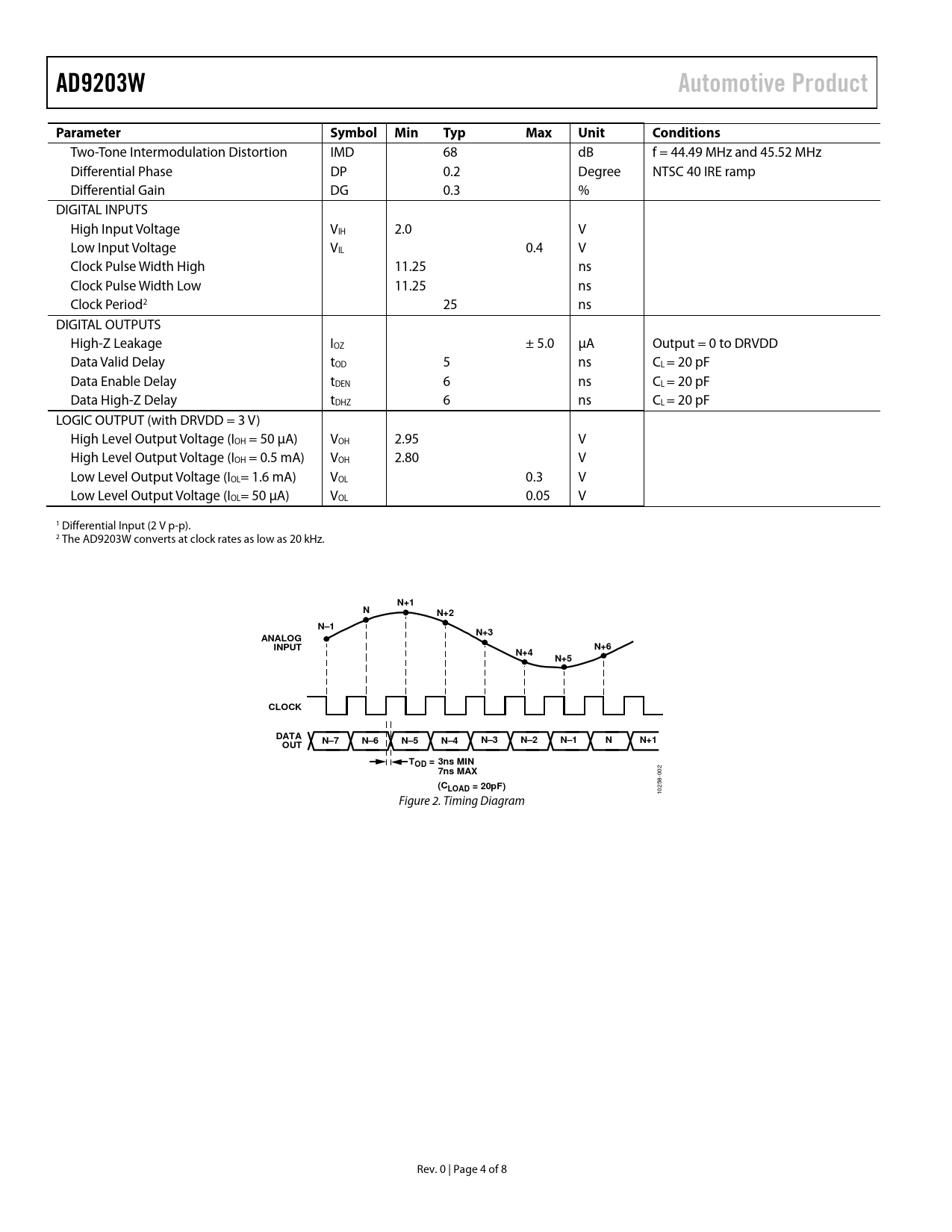

AD9203W Automotive Product Parameter Symbol Min Typ Max Unit Conditions
Two-Tone Intermodulation Distortion IMD 68 dB f = 44.49 MHz and 45.52 MHz Differential Phase DP 0.2 Degree NTSC 40 IRE ramp Differential Gain DG 0.3 % DIGITAL INPUTS High Input Voltage VIH 2.0 V Low Input Voltage VIL 0.4 V Clock Pulse Width High 11.25 ns Clock Pulse Width Low 11.25 ns Clock Period2 25 ns DIGITAL OUTPUTS High-Z Leakage IOZ ± 5.0 μA Output = 0 to DRVDD Data Valid Delay tOD 5 ns CL = 20 pF Data Enable Delay tDEN 6 ns CL = 20 pF Data High-Z Delay tDHZ 6 ns CL = 20 pF LOGIC OUTPUT (with DRVDD = 3 V) High Level Output Voltage (IOH = 50 μA) VOH 2.95 V High Level Output Voltage (IOH = 0.5 mA) VOH 2.80 V Low Level Output Voltage (IOL= 1.6 mA) VOL 0.3 V Low Level Output Voltage (IOL= 50 μA) VOL 0.05 V 1 Differential Input (2 V p-p). 2 The AD9203W converts at clock rates as low as 20 kHz.
N+1 N N+2 N–1 N+3 ANALOG INPUT N+6 N+4 N+5 CLOCK DATA N–7 N–6 N–5 N–4 N–3 N–2 N–1 N N+1 OUT TOD = 3ns MIN
02
7ns MAX
0 58-
(CLOAD = 20pF)
102 Figure 2. Timing Diagram Rev. 0 | Page 4 of 8 Document Outline FEATURES FUNCTIONAL BLOCK DIAGRAM GENERAL DESCRIPTION PRODUCT HIGHLIGHTS SPECIFICATIONS ABSOLUTE MAXIMUM RATINGS THERMAL CHARACTERISTICS ESD CAUTION PIN CONFIGURATION AND FUNCTION DESCRIPTIONS OUTLINE DIMENSIONS ORDERING GUIDE
