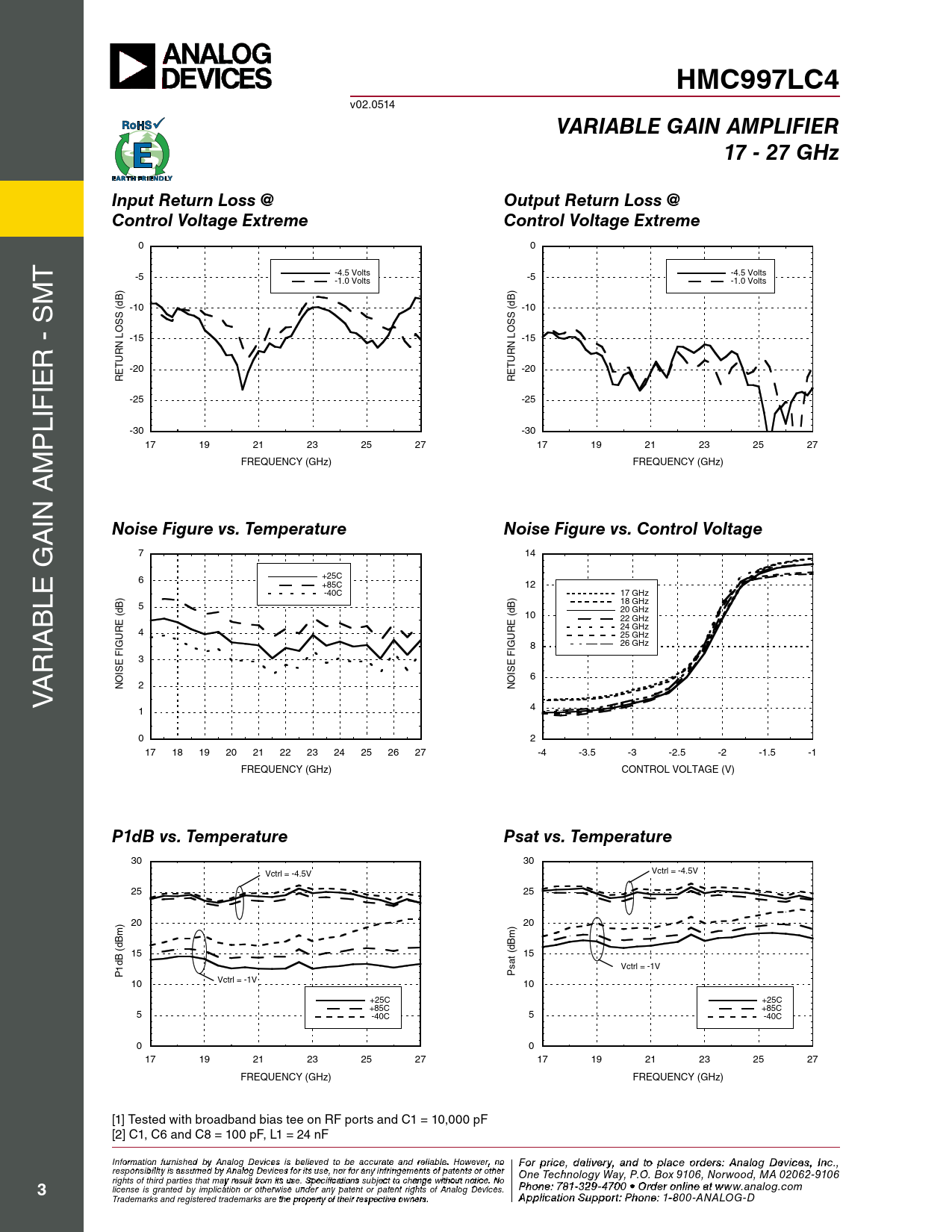

HMC997LC4. VARIABLE GAIN AMPLIFIER. 17 - 27 GHz. Input Return Loss @. Output Return Loss @. Control Voltage Extreme
HMC997LC4 VARIABLE GAIN AMPLIFIER 17 - 27 GHz Input Return Loss @ Output Return Loss @ Control Voltage Extreme
HMC997LC4
v02.0514
VARIABLE GAIN AMPLIFIER 17 - 27 GHz Input Return Loss @ Output Return Loss @ Control Voltage Extreme Control Voltage Extreme
0 0 T -5 -4.5 Volts -5 -4.5 Volts m -1.0 Volts -1.0 Volts (dB) -10 (dB) -10 LOSS -15 LOSS -15 r - S ie -20 -20 RETURN RETURN -25 -25 lif p -30 -30 17 19 21 23 25 27 17 19 21 23 25 27 m FREQUENCY (GHz) FREQUENCY (GHz) a in a
Noise Figure vs. Temperature Noise Figure vs. Control Voltage
7 14 6 +25C le G +85C 12 -40C ) 17 GHz ) 18 GHz b 5 20 GHz (dB (dB 10 E 22 GHz E 24 GHz ia R 4 R U 25 GHz U IG IG 8 26 GHz r F F 3 E E a IS IS O 6 O V N 2 N 1 4 0 2 17 18 19 20 21 22 23 24 25 26 27 -4 -3.5 -3 -2.5 -2 -1.5 -1 FREQUENCY (GHz) CONTROL VOLTAGE (V)
P1dB vs. Temperature Psat vs. Temperature
30 30 Vctrl = -4.5V Vctrl = -4.5V 25 25 20 20 (dBm) 15 (dBm) 15 Vctrl = -1V P1dB Psat 10 Vctrl = -1V 10 +25C +25C +85C +85C 5 -40C 5 -40C 0 0 17 19 21 23 25 27 17 19 21 23 25 27 FREQUENCY (GHz) FREQUENCY (GHz) [1] Tested with broadband bias tee on rf ports and C1 = 10,000 pf [2] C1, C6 and C8 = 100 pf, l1 = 24 nf Inf F or o m r p atio r n ifc ur e n , d ishe e d lbiv y e A r n y a alog n D d t evic o p es is la beclie o eved rd to ebre sa: H ccur iattti e tae M nd re ilicarbloew . H a o ve C wever, o n rp o For price, delivery, and to place orders: Analog Devices, Inc., responsibility is assumed by Analog Devices for its use, nor for any infringements of patents or other oration, 2 Elizabeth Drive, Chelmsford, MA 01824 One Technology Way, P.O. Box 9106, Norwood, MA 02062-9106 Phone: 978-250-3343 Fax: 978-250-3373 O rights of third parties that may result from its use. Specifications subject to change without notice. No P rd hone e r O : 7 n 81- -3li 2n 9 e a -47 t w 0 w 0 • O w rd .h e it r o t niltie n .c e ao t m
