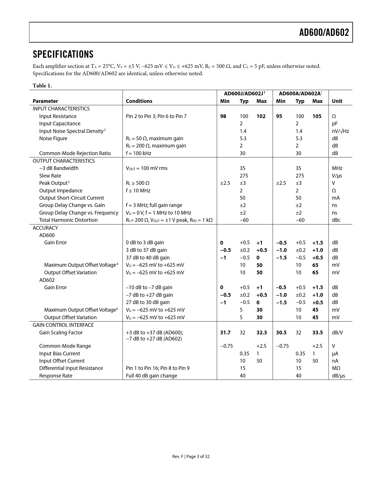

AD600/AD602 SPECIFICATIONS
Each amplifier section at TA = 25°C, VS = ±5 V, −625 mV ≤ VG ≤ +625 mV, RL = 500 Ω, and CL = 5 pF, unless otherwise noted. Specifications for the AD600/AD602 are identical, unless otherwise noted.
Table 1. AD600J/AD602J 1 AD600A/AD602A
1
Parameter Conditions Min Typ Max Min Typ Max Unit
INPUT CHARACTERISTICS Input Resistance Pin 2 to Pin 3; Pin 6 to Pin 7
98
100
102 95
100
105
Ω Input Capacitance 2 2 pF Input Noise Spectral Density2 1.4 1.4 nV/√Hz Noise Figure RS = 50 Ω, maximum gain 5.3 5.3 dB RS = 200 Ω, maximum gain 2 2 dB Common-Mode Rejection Ratio f = 100 kHz 30 30 dB OUTPUT CHARACTERISTICS −3 dB Bandwidth VOUT = 100 mV rms 35 35 MHz Slew Rate 275 275 V/μs Peak Output3 RL ≥ 500 Ω ±2.5 ±3 ±2.5 ±3 V Output Impedance f ≤ 10 MHz 2 2 Ω Output Short-Circuit Current 50 50 mA Group Delay Change vs. Gain f = 3 MHz; full gain range ±2 ±2 ns Group Delay Change vs. Frequency VG = 0 V, f = 1 MHz to 10 MHz ±2 ±2 ns Total Harmonic Distortion RL= 200 Ω, VOUT = ±1 V peak, RPD = 1 kΩ −60 −60 dBc ACCURACY AD600 Gain Error 0 dB to 3 dB gain
