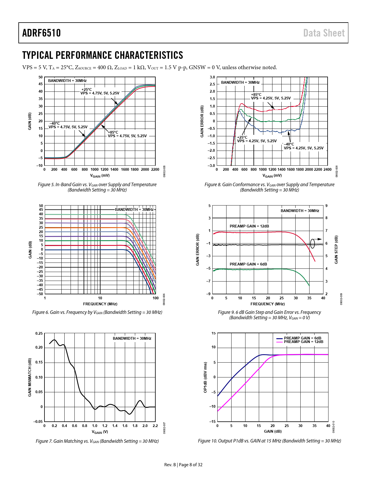

ADRF6510. Data Sheet. TYPICAL PERFORMANCE CHARACTERISTICS. 3.0. BANDWIDTH = 30MHz. 2.5. +25°C. VPS = 4.75V, 5V, 5.25V. 2.0. +85°C. 1.5
ADRF6510 Data Sheet TYPICAL PERFORMANCE CHARACTERISTICS
VPS = 5 V, TA = 25°C, ZSOURCE = 400 Ω, ZLOAD = 1 kΩ, VOUT = 1.5 V p-p, GNSW = 0 V, unless otherwise noted.
50 3.0 BANDWIDTH = 30MHz 45 2.5 BANDWIDTH = 30MHz 40 +25°C VPS = 4.75V, 5V, 5.25V 2.0 +85°C 35 1.5 VPS = 4.25V, 5V, 5.25V 30 1.0 25 (dB) 0.5 R (dB) 20 N –40°C 0 AI ERRO G 15 VPS = 4.75V, 5V, 5.25V –0.5 N +85°C AI 10 VPS = 4.75V, 5V, 5.25V G –1.0 +25°C 5 –1.5 VPS = 4.25V, 5V, 5.25V –40°C 0 –2.0 VPS = 4.25V, 5V, 5.25V –5 –2.5 –10 –3.0 0 200 400 600 800 1000 1200 1400 1600 1800 2000 2200

0 200 400 600 800 1000 1200 1400 1600 1800 2000 2200 2400

VGAIN (mV)

V GAIN (mV)
09002- Figure 5. In-Band Gain vs. VGAIN over Supply and Temperature Figure 8. Gain Conformance vs. VGAIN over Supply and Temperature (Bandwidth Setting = 30 MHz) (Bandwidth Setting = 30 MHz)
50 5 9 45 BANDWIDTH = 30MHz BANDWIDTH = 30MHz 40 35 3 8 30 25 PREAMP GAIN = 12dB 20 1 7 15 ) 10 (dB) B R –1 6 (d (dB) 5 EP N 0 AI –5 ERRO ST G –10 –3 5 N IN A –15 AI G G PREAMP GAIN = 6dB –20 –5 4 –25 –30 –35 –7 3 –40 –45 –50 –9 2 1 10 100

0 5 10 15 20 25 30 35 40

FREQUENCY (MHz)

FREQUENCY (MHz)
09002- Figure 6. Gain vs. Frequency by VGAIN (Bandwidth Setting = 30 MHz) Figure 9. 6 dB Gain Step and Gain Error vs. Frequency (Bandwidth Setting = 30 MHz, VGAIN = 0 V)
0.25 15 BANDWIDTH = 30MHz PREAMP GAIN = 6dB PREAMP GAIN = 12dB 0.20 10 0.15 (dB) 5 CH rms) AT 0.10 0 (dBV ISM B M N P1d AI 0.05 O –5 G 0 –10 –0.05 –15 0 2.2

0.2 0.4 0.6 0.8 1.0 1.2 1.4 1.6 1.8 2.0 0 5 10 15 20 25 30 35 40

VGAIN (V)

GAIN (dB)
09002- Figure 7. Gain Matching vs. VGAIN (Bandwidth Setting = 30 MHz) Figure 10. Output P1dB vs. GAIN at 15 MHz (Bandwidth Setting = 30 MHz) Rev. B | Page 8 of 32 Document Outline FEATURES APPLICATIONS FUNCTIONAL BLOCK DIAGRAM GENERAL DESCRIPTION REVISION HISTORY SPECIFICATIONS TIMING DIAGRAMS ABSOLUTE MAXIMUM RATINGS ESD CAUTION PIN CONFIGURATION AND FUNCTION DESCRIPTIONS TYPICAL PERFORMANCE CHARACTERISTICS THEORY OF OPERATION INPUT BUFFERS PROGRAMMABLE FILTERS VARIABLE GAIN AMPLIFIERS (VGAs) OUTPUT BUFFERS/ADC DRIVERS DC OFFSET COMPENSATION LOOP PROGRAMMING THE FILTERS NOISE CHARACTERISTICS DISTORTION CHARACTERISTICS MAXIMIZING THE DYNAMIC RANGE KEY PARAMETERS FOR QUADRATURE-BASED RECEIVERS APPLICATIONS INFORMATION BASIC CONNECTIONS ERROR VECTOR MAGNITUDE (EVM) PERFORMANCE EVM EFFECT OF FILTER BANDWIDTH ON EVM EFFECT OF OUTPUT VOLTAGE LEVELS ON EVM EFFECT OF COFS ON EVM ANTI-ALIASING FILTER EVALUATION BOARD EVALUATION BOARD CONTROL SOFTWARE SCHEMATICS AND ARTWORK EVALUATION BOARD CONFIGURATION OPTIONS USB Section Configuration Options OUTLINE DIMENSIONS ORDERING GUIDE
