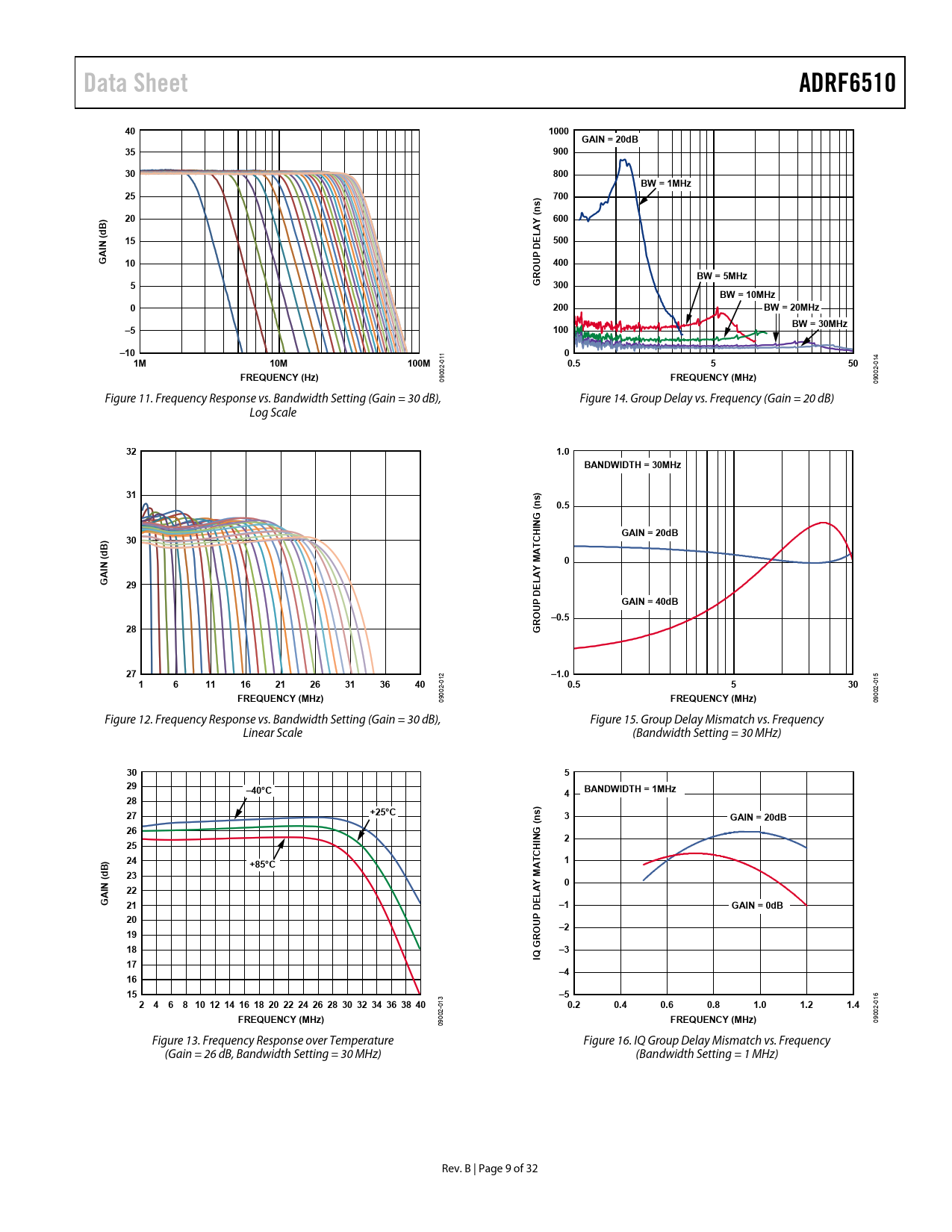

Data Sheet. ADRF6510. 1000 GAIN = 20dB. 900. 800. BW = 1MHz. 700. (ns). 600. (dB). LAY. 500. 400. BW = 5MHz. 300. BW = 10MHz. 200. BW = 20MHz. BW = 30MHz

09002- Figure 11. Frequency Response vs. Bandwidth Setting (Gain = 30 dB), Figure 14. Group Delay vs. Frequency (Gain = 20 dB) Log Scale

09002- Figure 12. Frequency Response vs. Bandwidth Setting (Gain = 30 dB), Figure 15. Group Delay Mismatch vs. Frequency Linear Scale (Bandwidth Setting = 30 MHz)

09002- 09002- Figure 13. Frequency Response over Temperature Figure 16. IQ Group Delay Mismatch vs. Frequency (Gain = 26 dB, Bandwidth Setting = 30 MHz) (Bandwidth Setting = 1 MHz) Rev. B | Page 9 of 32 Document Outline FEATURES APPLICATIONS FUNCTIONAL BLOCK DIAGRAM GENERAL DESCRIPTION REVISION HISTORY SPECIFICATIONS TIMING DIAGRAMS ABSOLUTE MAXIMUM RATINGS ESD CAUTION PIN CONFIGURATION AND FUNCTION DESCRIPTIONS TYPICAL PERFORMANCE CHARACTERISTICS THEORY OF OPERATION INPUT BUFFERS PROGRAMMABLE FILTERS VARIABLE GAIN AMPLIFIERS (VGAs) OUTPUT BUFFERS/ADC DRIVERS DC OFFSET COMPENSATION LOOP PROGRAMMING THE FILTERS NOISE CHARACTERISTICS DISTORTION CHARACTERISTICS MAXIMIZING THE DYNAMIC RANGE KEY PARAMETERS FOR QUADRATURE-BASED RECEIVERS APPLICATIONS INFORMATION BASIC CONNECTIONS ERROR VECTOR MAGNITUDE (EVM) PERFORMANCE EVM EFFECT OF FILTER BANDWIDTH ON EVM EFFECT OF OUTPUT VOLTAGE LEVELS ON EVM EFFECT OF COFS ON EVM ANTI-ALIASING FILTER EVALUATION BOARD EVALUATION BOARD CONTROL SOFTWARE SCHEMATICS AND ARTWORK EVALUATION BOARD CONFIGURATION OPTIONS USB Section Configuration Options OUTLINE DIMENSIONS ORDERING GUIDE
