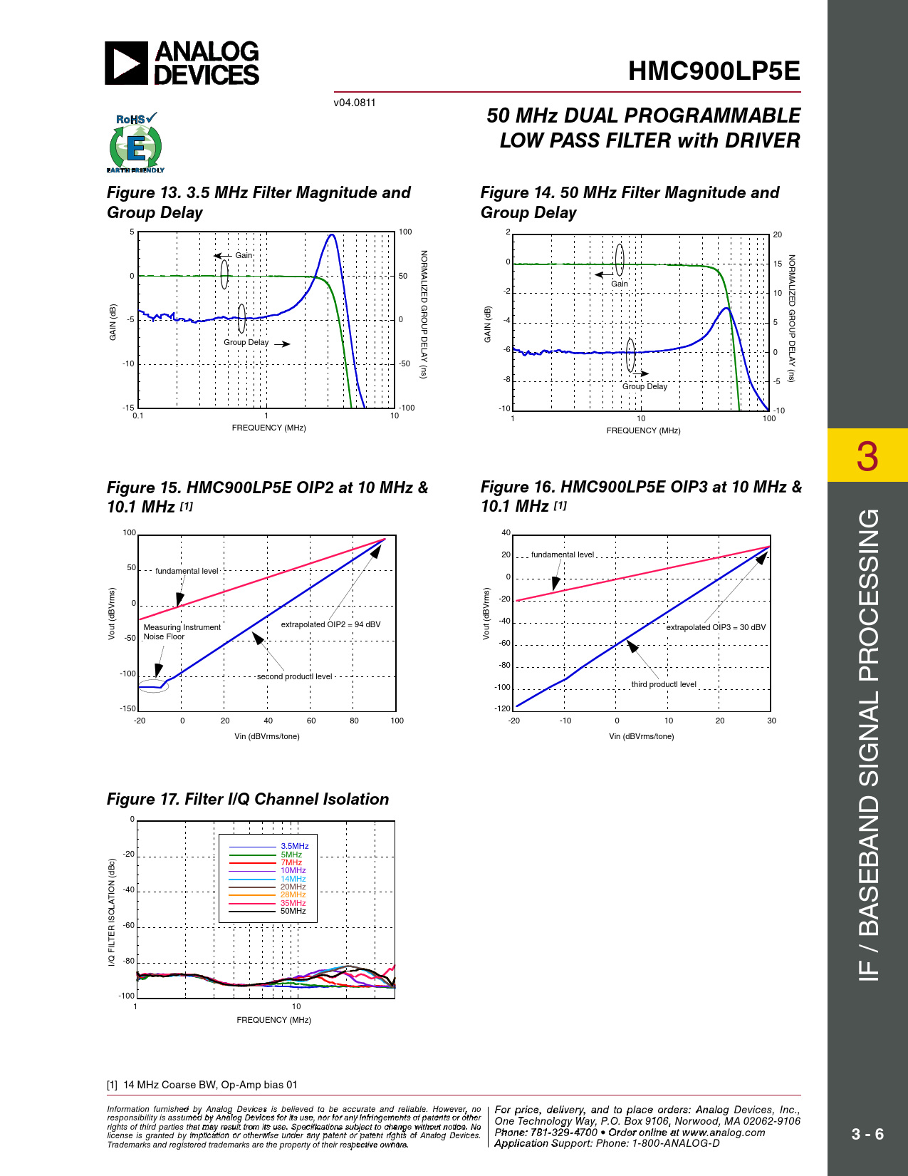

HMC900LP5E. 50 MHz DUAL PROGRAMMABLE. LOW PASS FILTER with DRIVER. Figure 13. 3.5 MHz Filter Magnitude and
HMC900LP5E 50 MHz DUAL PROGRAMMABLE LOW PASS FILTER with DRIVER Figure 13 3.5 MHz Filter Magnitude and
HMC900LP5E
v04.0811
50 MHz DUAL PROGRAMMABLE LOW PASS FILTER with DRIVER Figure 13. 3.5 MHz Filter Magnitude and Figure 14. 50 MHz Filter Magnitude and Group Delay Group Delay
5 100 2 20 N O N Gain R O 0 M 15 R M 0 50 A L A IZ L Gain E I -2 Z D 10 E D ) G B R ) G O B R (d -5 0 U -4 (d O 5 IN P U A IN D A P G E D Group Delay L G E A -6 L Y 0 A Y -10 -50 (n s (n ) s -8 -5 ) Group Delay -15 -100 -10 -10 0.1 1 10 1 10 100 FREQUENCY (MHz) FREQUENCY (MHz) 3
Figure 15. HMC900LP5E OIP2 at 10 MHz & Figure 16. HMC900LP5E OIP3 at 10 MHz & 10.1 MHz [1] 10.1 MHz [1]
g 100 40 20 fundamental level IN 50 fundamental level s 0 ) s s s -20 rm rm 0 V V e B B -40 t (d extrapolated OIP2 = 94 dBV t (d u Measuring Instrument u extrapolated OIP3 = 30 dBV C o o V -50 Noise Floor V -60 O -80 R -100 second productl level -100 third productl level l P -150 -120 -20 0 20 40 60 80 100 -20 -10 0 10 20 30 a Vin (dBVrms/tone) Vin (dBVrms/tone) N Ig s
Figure 17. Filter I/Q Channel Isolation
