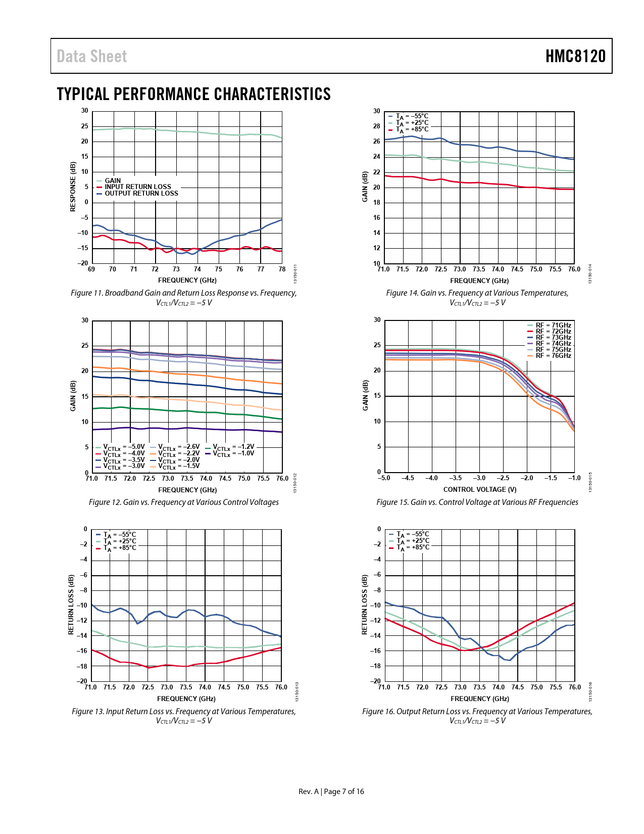

Data Sheet. HMC8120. TYPICAL PERFORMANCE CHARACTERISTICS. TA = –55°C. A = +25°C. TA = +85°C. B) d 10. ) 22. GAIN. INPUT RETURN LOSS. ( 20
Data Sheet HMC8120 TYPICAL PERFORMANCE CHARACTERISTICS 30 30 TA = –55°C 25 T 28 A = +25°C TA = +85°C 20 26 15 24 B) d 10 ( ) 22 E B GAIN d NS 5 INPUT RETURN LOSS ( 20 O IN P OUTPUT RETURN LOSS S 0 GA 18 RE –5 16 –10 14 –15 12 –20
1
10 69 70 71 72 73 74 75 76 77 78
1 -0
71.0 71.5 72.0 72.5 73.0 73.5 74.0 74.5 75.0 75.5 76.0
014 0-
FREQUENCY (GHz) FREQUENCY (GHz)
13150 1315 Figure 11. Broadband Gain and Return Loss Response vs. Frequency, Figure 14. Gain vs. Frequency at Various Temperatures, VCTL1/VCTL2 = −5 V VCTL1/VCTL2 = −5 V
30 30 RF = 71GHz RF = 72GHz RF = 73GHz 25 25 RF = 74GHz RF = 75GHz RF = 76GHz 20 20 ) ) B B d d ( ( 15 15 IN IN A G GA 10 10 5 VCTLx = –5.0V VCTLx = –2.6V VCTLx = –1.2V 5 VCTLx = –4.0V VCTLx = –2.2V VCTLx = –1.0V VCTLx = –3.5V VCTLx = –2.0V VCTLx = –3.0V VCTLx = –1.5V 0 0
2
01
–5.0 –4.5 –4.0 –3.5 –3.0 –2.5 –2.0 –1.5 –1.0
015 50-
FREQUENCY (GHz)
150-
CONTROL VOLTAGE (V)
13 131 Figure 12. Gain vs. Frequency at Various Control Voltages Figure 15. Gain vs. Control Voltage at Various RF Frequencies
0 0 TA = –55°C TA = –55°C –2 TA = +25°C –2 TA = +25°C TA = +85°C TA = +85°C –4 –4 ) –6 ) –6 B B d d ( ( S –8 S –8 S S O O L –10 L –10 RN RN U –12 U T –12 T RE –14 RE –14 –16 –16 –18 –18 –20 –20 71.0 71.5 72.0 72.5 73.0 73.5 74.0 74.5 75.0 75.5 76.0
013
016 0- 0-
