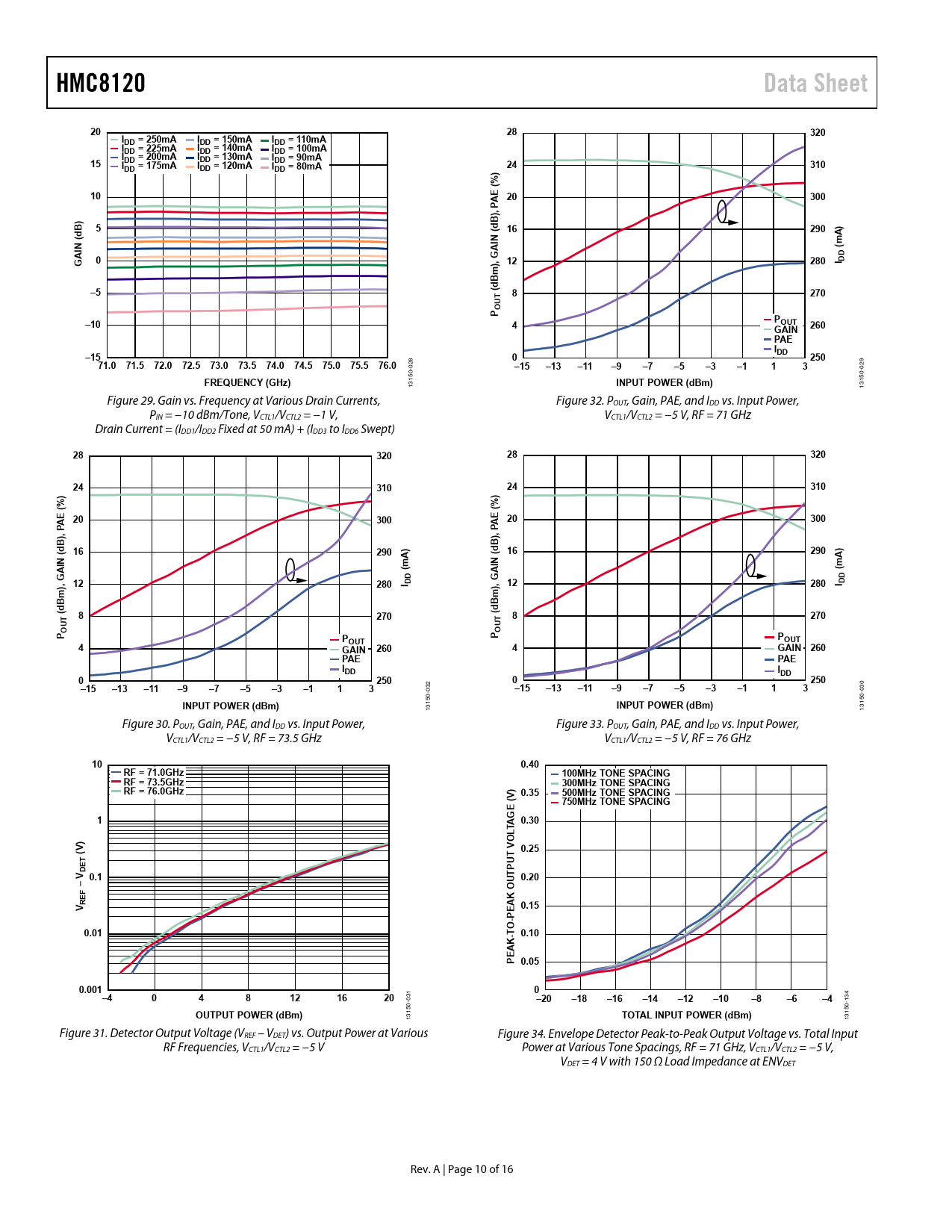

HMC8120. Data Sheet. 320. IDD = 250mA. IDD = 150mA. IDD = 110mA. IDD = 225mA. IDD = 140mA. IDD = 100mA. DD = 200mA. DD = 130mA. DD = 90mA
HMC8120 Data Sheet 320 IDD = 250mA IDD = 150mA IDD = 110mA IDD = 225mA IDD = 140mA IDD = 100mA DD = 200mA DD = 130mA DD = 90mA
HMC8120 Data Sheet 20 28 320 IDD = 250mA IDD = 150mA IDD = 110mA IDD = 225mA IDD = 140mA IDD = 100mA I I I 15 DD = 200mA DD = 130mA DD = 90mA IDD = 175mA IDD = 120mA IDD = 80mA 24 310 ) (% 10 E 20 300 A P ), ) B B 5 ) d 16 290 (d A ( IN IN A (m 0 G GA 12 280 I DD ), m B –5 (d T 8 270 OUP P –10 4 OUT 260 GAIN PAE IDD –15 0 250 71.0 71.5 72.0 72.5 73.0 73.5 74.0 74.5 75.0 75.5 76.0

13150 1315 Figure 29. Gain vs. Frequency at Various Drain Currents, Figure 32. POUT, Gain, PAE, and IDD vs. Input Power, PIN = −10 dBm/Tone, VCTL1/VCTL2 = −1 V, VCTL1/VCTL2 = −5 V, RF = 71 GHz Drain Current = (IDD1/IDD2 Fixed at 50 mA) + (IDD3 to IDD6 Swept)

131 13150 Figure 30. POUT, Gain, PAE, and IDD vs. Input Power, Figure 33. POUT, Gain, PAE, and IDD vs. Input Power, VCTL1/VCTL2 = −5 V, RF = 73.5 GHz VCTL1/VCTL2 = −5 V, RF = 76 GHz

1315 131 Figure 31. Detector Output Voltage (VREF – VDET) vs. Output Power at Various Figure 34. Envelope Detector Peak-to-Peak Output Voltage vs. Total Input RF Frequencies, VCTL1/VCTL2 = −5 V Power at Various Tone Spacings, RF = 71 GHz, VCTL1/VCTL2 = −5 V, VDET = 4 V with 150 Ω Load Impedance at ENVDET Rev. A | Page 10 of 16 Document Outline FEATURES APPLICATIONS GENERAL DESCRIPTION FUNCTIONAL BLOCK DIAGRAM TABLE OF CONTENTS REVISION HISTORY SPECIFICATIONS ABSOLUTE MAXIMUM RATINGS THERMAL RESISTANCE ESD CAUTION PIN CONFIGURATION AND FUNCTION DESCRIPTIONS INTERFACE SCHEMATICS TYPICAL PERFORMANCE CHARACTERISTICS THEORY OF OPERATION TYPICAL APPLICATION CIRCUIT ASSEMBLY DIAGRAM MOUNTING AND BONDING TECHNIQUES FOR MILLIMETERWAVE GaAs MMICS HANDLING PRECAUTIONS Storage Cleanliness Static Sensitivity Transients General Handling MOUNTING Eutectic Die Attach Epoxy Die Attach WIRE BONDING OUTLINE DIMENSIONS ORDERING GUIDE
