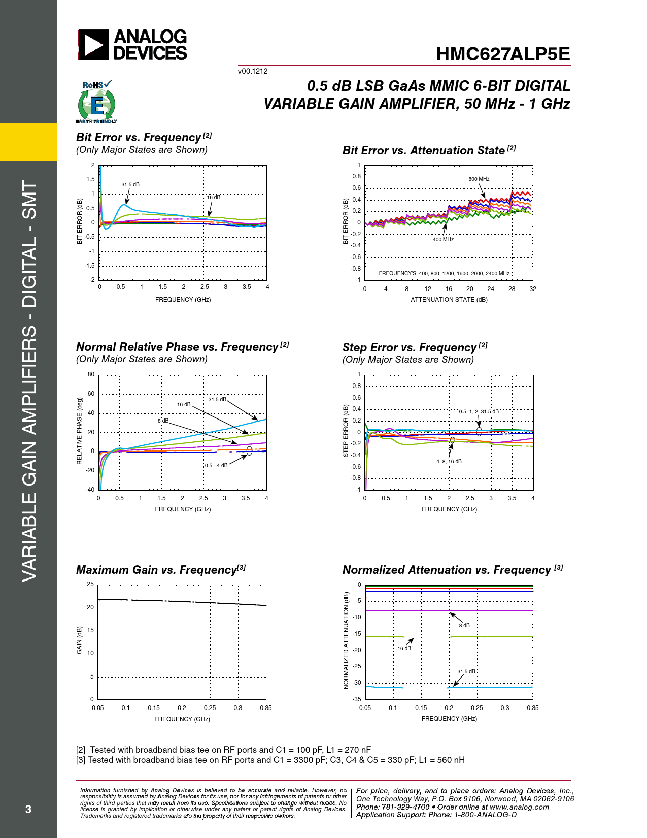

HMC627ALP5E. 0.5 dB LSB GaAs MMIC 6-BIT DIGITAL. VARIABLE GAIN AMPLIFIER, 50 MHz - 1 GHz. Bit Error vs. Frequency [2]
HMC627ALP5E 0.5 dB LSB GaAs MMIC 6-BIT DIGITAL VARIABLE GAIN AMPLIFIER, 50 MHz - 1 GHz Bit Error vs Frequency [2]
HMC627ALP5E
v00.1212
0.5 dB LSB GaAs MMIC 6-BIT DIGITAL VARIABLE GAIN AMPLIFIER, 50 MHz - 1 GHz Bit Error vs. Frequency [2]
(Only Major States are Shown)
Bit Error vs. Attenuation State [2]
2 1 T 0.8 1.5 800 MHz 31.5 dB 0.6 M 1 ) 16 dB ) B 0.4 B d d ( 0.5 ( R 0.2 R O O R 0 R 0 R R L - S E E -0.2 -0.5 IT IT B 400 MHz B -0.4 -1 ITA -0.6 -1.5 -0.8 FREQUENCY'S: 400, 800, 1200, 1600, 2000, 2400 MHz IG -2 -1 0 0.5 1 1.5 2 2.5 3 3.5 4 0 4 8 12 16 20 24 28 32 FREQUENCY (GHz) ATTENUATION STATE (dB) S - D R
Normal Relative Phase vs. Frequency [2] Step Error vs. Frequency [2]
IE (Only Major States are Shown) (Only Major States are Shown) 80 1 LIF 0.8 P 60 ) g 31.5 dB 0.6 e 16 dB M (d B) 0.4 40 0.5, 1, 2, 31.5 dB (d R ASE 8 dB 0.2 O PH R 20 0 ER IN A IVE -0.2 EP AT 0 A ST -0.4 EL R 4, 8, 16 dB 0.5 - 4 dB -0.6 -20 -0.8 -40 -1 LE G 0 0.5 1 1.5 2 2.5 3 3.5 4 0 0.5 1 1.5 2 2.5 3 3.5 4 FREQUENCY (GHz) FREQUENCY (GHz) B IA R A V
Maximum Gain vs. Frequency[3] Normalized Attenuation vs. Frequency [3]
25 0 ) B (d -5 20 N IO T -10 ) UA 8 dB B 15 N d E -15 ( T IN T A A 16 dB G -20 10 D E IZ L -25 A 31.5 dB 5 RM -30 NO 0 -35 0.05 0.1 0.15 0.2 0.25 0.3 0.35 0.05 0.1 0.15 0.2 0.25 0.3 0.35 FREQUENCY (GHz) FREQUENCY (GHz) [2] Tested with broadband bias tee on RF ports and C1 = 100 pF, L1 = 270 nF [3] Tested with broadband bias tee on RF ports and C1 = 3300 pF; C3, C4 & C5 = 330 pF; L1 = 560 nH I F nf o or r p mati r o in cfe ur , d nish e e l d iv b e y r A y a nalo n g d t Devi o p ces i la s c bele o ieve rd d t e o rbs e : H acc iutrtatite e M and ic reli rao bl w e. a H v o e C wever o , nrp o For price, delivery, and to place orders: Analog Devices, Inc., responsibility is assumed by Analog Devices for its use, nor for any infringements of patents or other oration, 2 Elizabeth Drive, Chelmsford, MA 01824 One Technology Way, P.O. Box 9106, Norwood, MA 02062-9106 Phone: 978-250-3343 Fax: 978-250-3373 O rights of third parties that may result from its use. Specifications subject to change without notice. No rd Phoe n r O e: 7 n- 81-li 3 n 2 e a 9-4 t w 70 ww 0 • O . rdh e itt r o it nle i . n co e a m
