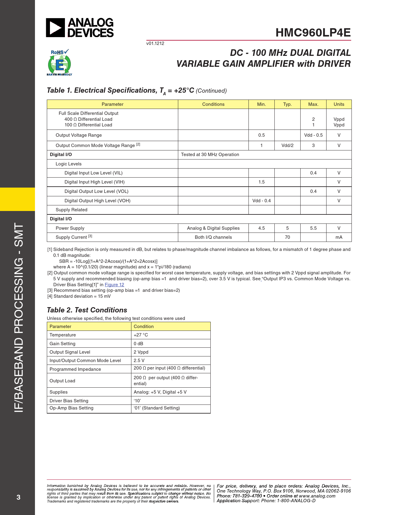

DC - 100 MHz DUAL DigitAL VAriAbLe gAin AMpLifier with DriVer table 1. electrical Specifications, t = +25°C
(Continued)
A
Parameter Conditions Min. Typ. Max. Units Full Scale Differential Output 400 Ω Differential Load 2 Vppd 100 Ω Differential Load 1 Vppd Output Voltage Range 0.5 Vdd - 0.5 V Output Common Mode Voltage Range [2] 1 Vdd/2 3 V
Digital I/O
Tested at 30 MHz Operation Logic Levels Digital Input Low Level (VIL) 0.4 V Digital Input High Level (VIH) 1.5 V Digital Output Low Level (VOL) 0.4 V Digital Output High Level (VOH) Vdd - 0.4 V Supply Related
Digital I/O
T Power Supply Analog & Digital Supplies 4.5 5 5.5 V M Supply Current [3] Both I/Q channels 70 mA S - [1] Sideband Rejection is only measured in dB, but relates to phase/magnitude channel imbalance as follows, for a mismatch of 1 degree phase and 0.1 dB magnitude: G SBR = -10Log[(1+A^2-2Acosx)/(1+A^2+2Acosx)] where A = 10^(0.1/20) (linear magnitude) and x = 1*pi/180 (radians) IN [2] Output common mode voltage range is specified for worst case temperature, supply voltage, and bias settings with 2 Vppd signal amplitude. For S 5 V supply and recommended biasing (op-amp bias =1 and driver bias=2), over 3.5 V is typical. See “Output IP3 vs. Common Mode Voltage vs. S Driver Bias Setting[1]” in Figure 12 E [3] Recommend bias setting (op-amp bias =1 and driver bias=2) [4] Standard deviation = 15 mV C
table 2. test Conditions
RO Unless otherwise specified, the following test conditions were used Parameter Condition P D Temperature +27 °C N Gain Setting 0 dB A Output Signal Level 2 Vppd B Input/Output Common Mode Level 2.5 V E Programmed Impedance 200 Ω per input (400 Ω differential) S 200 Ω per output (400 Ω differ- Output Load A ential) Supplies Analog: +5 V, Digital +5 V Driver Bias Setting ‘10’ IF/B Op-Amp Bias Setting ‘01’ (Standard Setting) Inf F or o m r p atio r n ifc ur e n , d ishe e d lbiv y e Anry a alog n D d t evic o p es is la be c liee o ved rd to e b r e sa: H ccur iattte itae M nd reliic a r bl o e. w H a o v wee C ver, o n rp o For price, delivery, and to place orders: Analog Devices, Inc., responsibility is assumed by Analog Devices for its use, nor for any infringements of patents or other oration, 2 Elizabeth Drive, Chelmsford, MA 01824 One Technology Way, P.O. Box 9106, Norwood, MA 02062-9106
