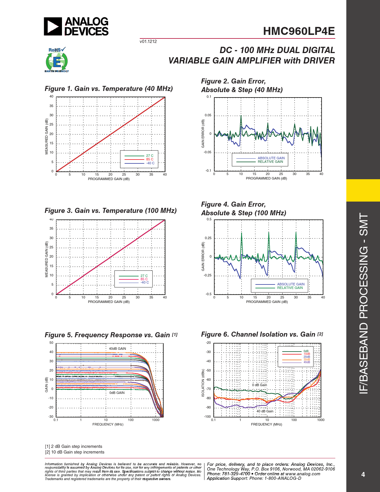

HMC960LP4E. DC - 100 MHz DUAL DigitAL. VAriAbLe gAin AMpLifier with DriVer. figure 2. gain error,
HMC960LP4E DC - 100 MHz DUAL DigitAL VAriAbLe gAin AMpLifier with DriVer figure 2 gain error,
HMC960LP4E
v01.1212
DC - 100 MHz DUAL DigitAL VAriAbLe gAin AMpLifier with DriVer figure 2. gain error, figure 1. gain vs. temperature (40 MHz) Absolute & Step (40 MHz)
40 0.1 35 30 0.05 B) B) (d 25 (d N R AI O G 20 R 0 ED ER R N 15 AI G EASU 10 M -0.05 27 C 85 C ABSOLUTE GAIN 5 RELATIVE GAIN -40 C 0 -0.1 0 5 10 15 20 25 30 35 40 0 5 10 15 20 25 30 35 40 PROGRAMMED GAIN (dB) PROGRAMMED GAIN (dB)
figure 4. gain error, figure 3. gain vs. temperature (100 MHz) Absolute & Step (100 MHz)
40 0.5 T 35 M 30 0.25 S B) B (d 25 (d - N R AI G G 20 0 RRO ED E R 15 IN IN A G EASU S 10 M 27 C -0.25 85 C S -40 C 5 ABSOLUTE GAIN RELATIVE GAIN E 0 -0.5 C 0 5 10 15 20 25 30 35 40 0 5 10 15 20 25 30 35 40 PROGRAMMED GAIN (dB) PROGRAMMED GAIN (dB) RO P D
figure 5. frequency response vs. gain [1] figure 6. Channel isolation vs. gain [2]
N 50 -20 A 40dB GAIN 40 -30 0dB 10dB B 20dB 30dB 30 -40 E 40dB S 20 ) -50 fs B d A B) ( 10 -60 (d ION N T 0 dB Gain AI 0 A -70 G L 0dB GAIN O IS IF/B -10 -80 -20 -90 40 dB Gain -30 -100 0.1 1 10 100 1000 0.1 1 10 100 1000 FREQUENCY (MHz) FREQUENCY (MHz) [1] 2 dB Gain step increments [2] 10 dB Gain step increments Inf F or o m r p atio r n fic ur e n , d ishe e d lbiv y e An ry a alog n Ded t viceo p s is la belciee o ved rd to e b r e sa: H ccur iattte itae M nd rel iic a r bl o e. w H a o v we e C ver, noo For price, delivery, and to place orders: Analog Devices, Inc., responsibility is assumed by Analog Devices for its use, nor for any infringements of patents or other rporation, 2 Elizabeth Drive, Chelmsford, MA 01824 One Technology Way, P.O. Box 9106, Norwood, MA 02062-9106 978-250-3343 tel • 978-250-3373 fax • O rights of third parties that may result from its use. Specifications subject to change without notice. No rd P e hor O ne n : 7 -li 81 n -3e a 29- t w 470 ww. 0 • O h rdit e tit r oe n .lic n om license is granted by implication or otherwise under any patent or patent rights of Analog Devices. e at www.analog.com
