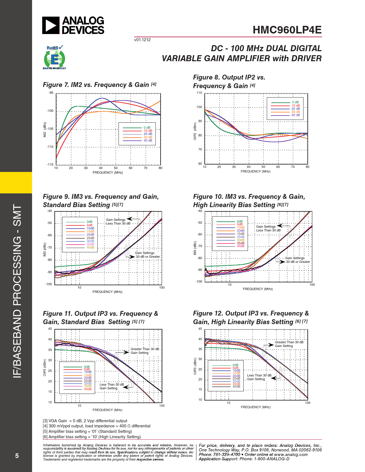

DC - 100 MHz DUAL DigitAL VAriAbLe gAin AMpLifier with DriVer figure 8. Output ip2 vs. figure 7. iM2 vs. frequency & gain [4] frequency & gain [4]
-95 110 0 dB 100 10 dB 20 dB -100 30 dB 40 dB ) 90 c ) B m d -105 0 dB B ( 10 dB 2 (d 20 dB 2 IM 80 30 dB 40 dB OIP -110 70 -115 60 10 20 30 40 50 60 70 80 10 20 30 40 50 60 70 80 FREQUENCY (MHz) FREQUENCY (MHz)
figure 9. iM3 vs. frequency and gain, figure 10. iM3 vs. frequency & gain,
T
Standard bias Setting [5][7] High Linearity bias Setting [6][7]
M -40 -40 S Gain Settings 0dB -50 0dB Less Than 30 dB -50 5dB 5dB - Gain Settings 10dB 10dB 15dB 20dB Less Than 30 dB 15dB G -60 20dB -60 25dB 25dB 30dB 30dB ) c c 35dB 35dB IN B B -70 40dB -70 40dB (d (d 3 S 3 Gain Settings IM IM 30 dB or Greater -80 Gain Settings S -80 30 dB or Greater E -90 -90 C -100 -100 10 100 10 100 FREQUENCY (MHz) RO FREQUENCY (MHz) P D
figure 11. Output ip3 vs. frequency & figure 12. Output ip3 vs. frequency &
N
gain, High Linearity bias Setting [6] [7]
A
gain, Standard bias Setting [5] [7]
B 45 45 E 40 40 Greater Than 30 dB S Gain Setting Greater Than 30 dB 35 A 35 Gain Setting ) 30 30 Bm Bm 0dB 0dB (d (d 5dB IF/B 25 5dB 25 10dB IP3 10dB IP3 O 15dB O 15dB 20dB Less Than 30 dB 20dB 20 25dB Gain Setting 20 25dB 30dB 30dB Less Than 30 dB 35dB 35dB 40dB 40dB Gain Setting 15 15 10 10 10 100 10 100 FREQUENCY (MHz) FREQUENCY (MHz) [3] VGA Gain = 0 dB, 2 Vpp differential output [4] 300 mVppd output, load impedance = 400 Ω differential [5] Amplifier bias setting = ‘01’ (Standard Setting) [6] Amplifier bias setting = ‘10’ (High Linearity Setting) Inf F or o m r p atio r n ifc ur e n , d ishe e d lbiv y e Anry a alog n D d t evic o p es is la be c liee o ved rd to e b r e sa: H ccur iattte itae M nd reliic a r bl o e. w H a o v wee C ver, o n rp o For price, delivery, and to place orders: Analog Devices, Inc., responsibility is assumed by Analog Devices for its use, nor for any infringements of patents or other oration, 2 Elizabeth Drive, Chelmsford, MA 01824 One Technology Way, P.O. Box 9106, Norwood, MA 02062-9106
