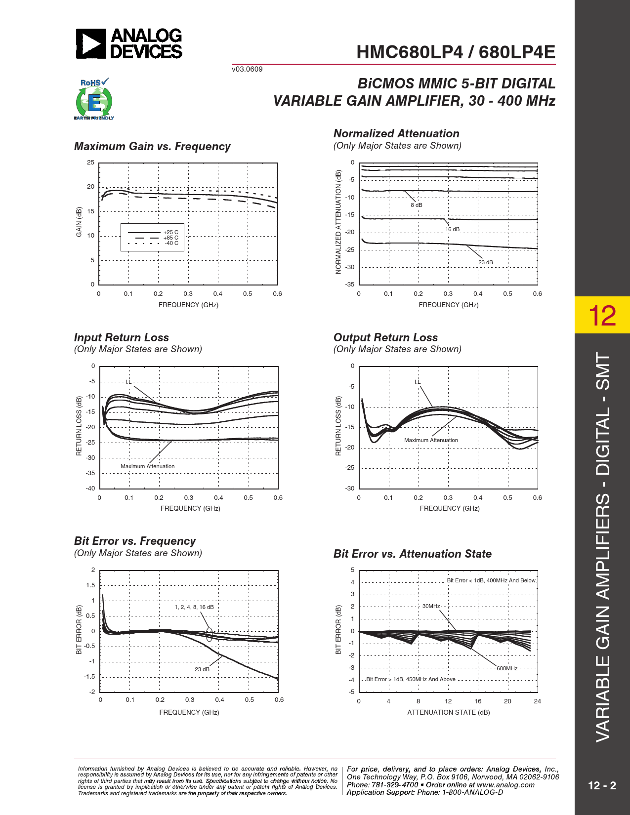

HMC680LP4 / 680LP4E. BiCMOS MMIC 5-BIT DIGITAL. VARIABLE GAIN AMPLIFIER, 30 - 400 MHz. Normalized Attenuation
HMC680LP4 / 680LP4E BiCMOS MMIC 5-BIT DIGITAL VARIABLE GAIN AMPLIFIER, 30 - 400 MHz Normalized Attenuation
HMC680LP4 / 680LP4E
v03.0609
BiCMOS MMIC 5-BIT DIGITAL VARIABLE GAIN AMPLIFIER, 30 - 400 MHz Normalized Attenuation Maximum Gain vs. Frequency
(Only Major States are Shown) 25 0 ) -5 (dB 20 N IO T -10 A U 8 dB 15 N E -15 (dB) T T A +25 C -20 16 dB GAIN 10 D +85 C E -40 C LIZ -25 A M 5 R 23 dB O -30 N 0 -35 0 0.1 0.2 0.3 0.4 0.5 0.6 0 0.1 0.2 0.3 0.4 0.5 0.6 FREQUENCY (GHz) FREQUENCY (GHz) 12
Input Return Loss Output Return Loss
(Only Major States are Shown) (Only Major States are Shown) t 0 0 m -5 I.L I.L -5 s ) -10 ) (dB (dB -10 S -15 S S S l - LO -20 LO -15 N N R R U -25 U Maximum Attenuation T T ita E -20 E R R -30 ig Maximum Attenuation -25 -35 -40 -30 0 0.1 0.2 0.3 0.4 0.5 0.6 0 0.1 0.2 0.3 0.4 0.5 0.6 s - d FREQUENCY (GHz) FREQUENCY (GHz) r ie
Bit Error vs. Frequency
Bit Error vs. Attenuation State
