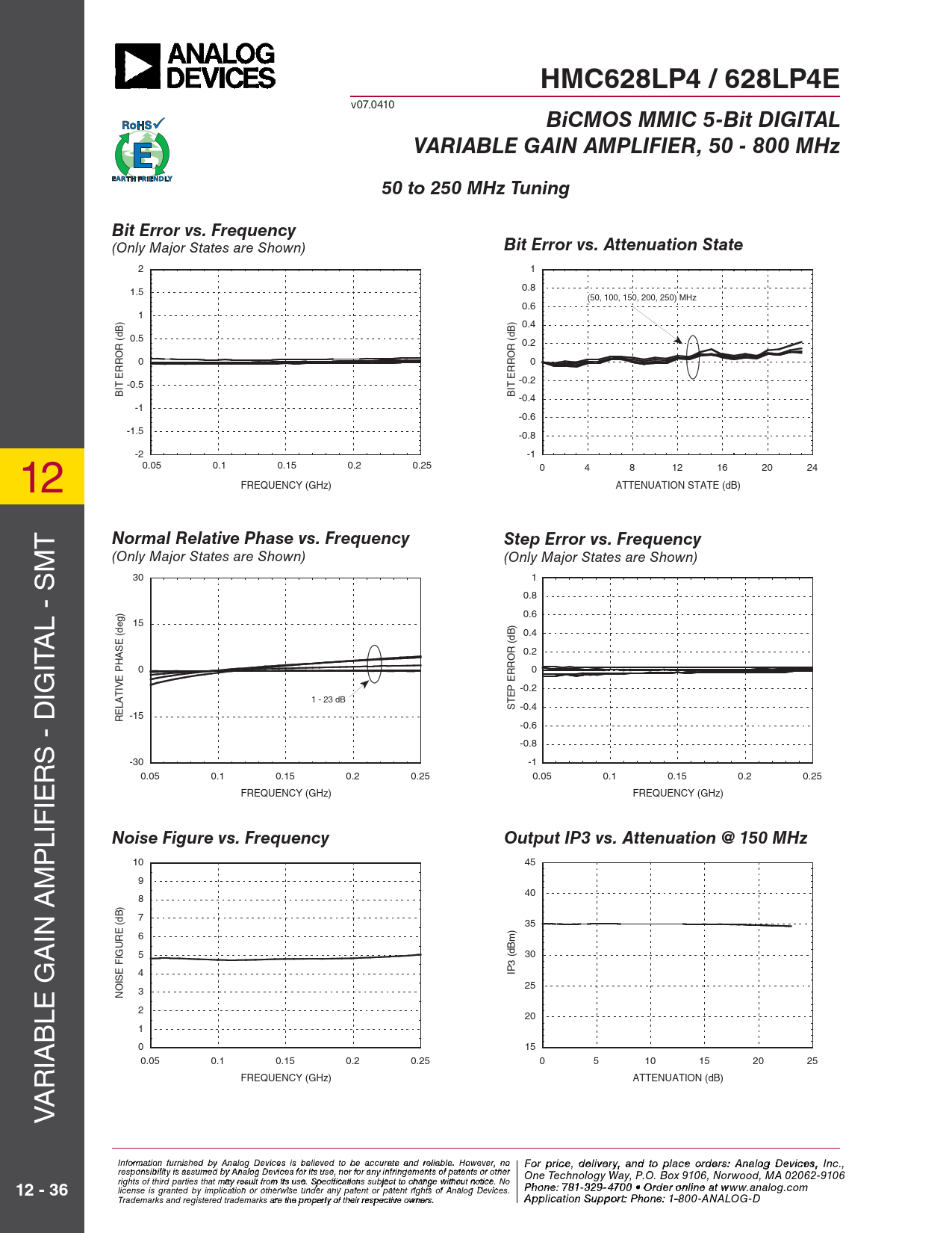

HMC628LP4 / 628LP4E. BiCMOS MMIC 5-Bit DIGITAL. VARIABLE GAIN AMPLIFIER, 50 - 800 MHz. 50 to 250 MHz Tuning
HMC628LP4 / 628LP4E BiCMOS MMIC 5-Bit DIGITAL VARIABLE GAIN AMPLIFIER, 50 - 800 MHz 50 to 250 MHz Tuning
HMC628LP4 / 628LP4E
v07.0410
BiCMOS MMIC 5-Bit DIGITAL VARIABLE GAIN AMPLIFIER, 50 - 800 MHz 50 to 250 MHz Tuning Bit Error vs. Frequency
(Only Major States are Shown)
Bit Error vs. Attenuation State
2 1 0.8 1.5 (50, 100, 150, 200, 250) MHz 0.6 1 0.4 0.5 0.2 0 0 -0.2 T ERROR (dB) -0.5 T ERROR (dB) BI BI -0.4 -1 -0.6 -1.5 -0.8 -2 -1 12 0.05 0.1 0.15 0.2 0.25 0 4 8 12 16 20 24 FREQUENCY (GHz) ATTENUATION STATE (dB) T
Normal Relative Phase vs. Frequency Step Error vs. Frequency
(Only Major States are Shown) (Only Major States are Shown) 30 1 0.8 L - SM 0.6 15 A 0.4 0.2 IT 0 0 IG -0.2 1 - 23 dB STEP ERROR (dB) -0.4 -15 RELATIVE PHASE (deg) - D -0.6 S -0.8 -30 -1 R 0.05 0.1 0.15 0.2 0.25 0.05 0.1 0.15 0.2 0.25 IE FREQUENCY (GHz) FREQUENCY (GHz) IF L
Noise Figure vs. Frequency Output IP3 vs. Attenuation @ 150 MHz
P 10 45 M 9 40 A 8 7 IN 35 6 A GURE (dB) 5 30 G 4 IP3 (dBm) SE FI 25 E 3 NOI L 2 20 B 1 0 15 IA 0.05 0.1 0.15 0.2 0.25 0 5 10 15 20 25 R FREQUENCY (GHz) ATTENUATION (dB) A V Inf F or o m r pr ation ifc ur e, de nished lbiv y e Anry alo a g n D d to p evices is la beclie o eved rde to b r e sa: H ccur iattti e tae M nd reliicr abl ow e. H a o v wee C ver, o n rp o o F roar tiporin c ,e 2 , 0 de A liv lepha R ry, an o d t ad, C o plac h e eolm rdesrfo s: rd, MA 01 Analog Devi 8 c 2 e 4 s, Inc., responsibility is assumed by Analog Devices for its use, nor for any infringements of patents or other One Technology Way, P.O. Box 9106, Norwood, MA 02062-9106 rights of third parties that may result from its use. Specifications subject to change without notice. No
