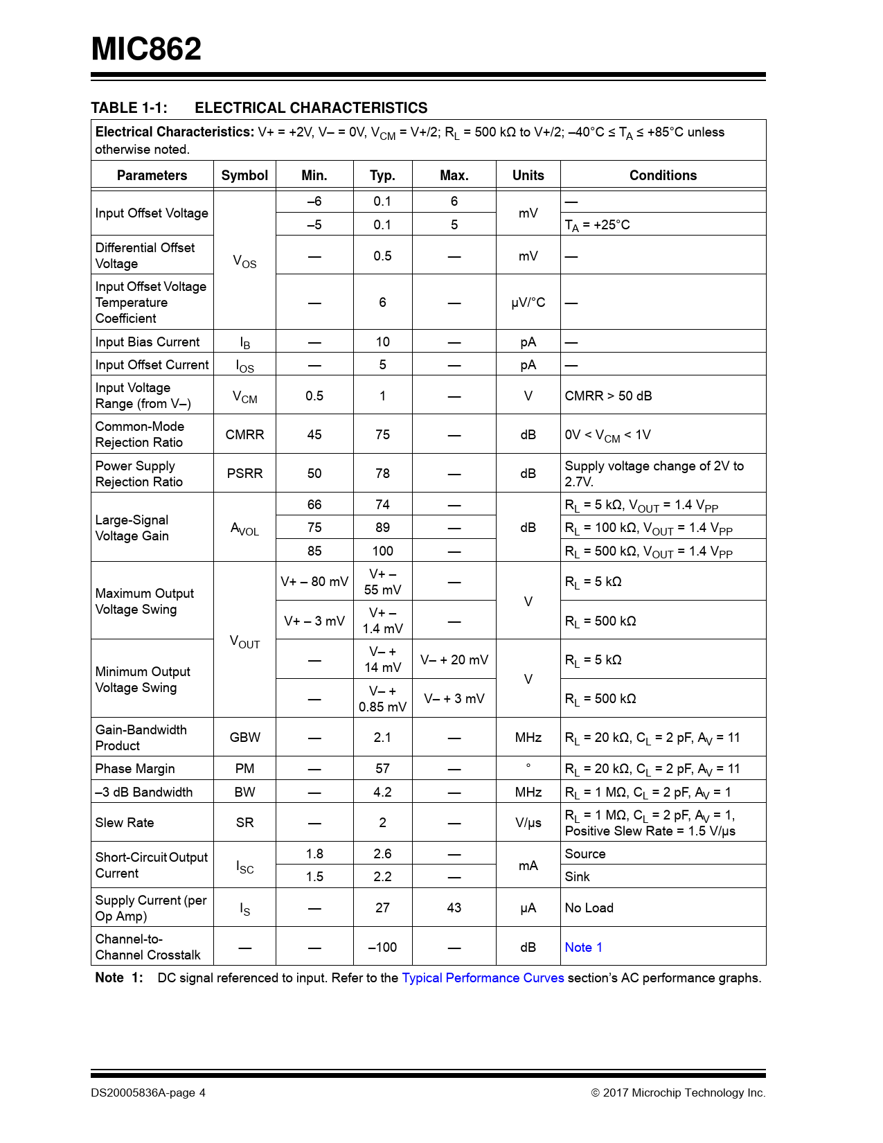

ManufacturerMicrochip
DescriptionThe MIC862 is a dual low-power operational amplifier in an SOT23-8 package
Pages / Page24 / 4 — MIC862. TABLE 1-1:. ELECTRICAL CHARACTERISTICS. Electrical …
MIC862. TABLE 1-1:. ELECTRICAL CHARACTERISTICS. Electrical Characteristics:. Parameters. Symbol. Min. Typ. Max. Units. Conditions. Note 1:
MIC862 TABLE 1-1: ELECTRICAL CHARACTERISTICS Electrical Characteristics: Parameters Symbol Min Typ Max Units Conditions Note 1:
link to page 4 link to page 8
V+ = +2V, V– = 0V, VCM = V+/2; RL = 500 kΩ to V+/2; –40°C ≤ TA ≤ +85°C unless otherwise noted.
Parameters Symbol Min. Typ. Max. Units Conditions
–6 0.1 6 — Input Offset Voltage mV –5 0.1 5 TA = +25°C Differential Offset V — 0.5 — mV — Voltage OS Input Offset Voltage Temperature — 6 — µV/°C — Coefficient Input Bias Current IB — 10 — pA — Input Offset Current IOS — 5 — pA — Input Voltage V Range (from V–) CM 0.5 1 — V CMRR > 50 dB Common-Mode CMRR 45 75 — dB 0V < V Rejection Ratio CM < 1V Power Supply Supply voltage change of 2V to PSRR 50 78 — dB Rejection Ratio 2.7V. 66 74 — RL = 5 kΩ, VOUT = 1.4 VPP Large-Signal A 75 89 — dB R Voltage Gain VOL L = 100 kΩ, VOUT = 1.4 VPP 85 100 — RL = 500 kΩ, VOUT = 1.4 VPP V+ – V+ – 80 mV — RL = 5 kΩ Maximum Output 55 mV V Voltage Swing V+ – V+ – 3 mV — R 1.4 mV L = 500 kΩ VOUT V– + — V– + 20 mV RL = 5 kΩ Minimum Output 14 mV V Voltage Swing V– + — V– + 3 mV R 0.85 mV L = 500 kΩ Gain-Bandwidth GBW — 2.1 — MHz R Product L = 20 kΩ, CL = 2 pF, AV = 11 Phase Margin PM — 57 — ° RL = 20 kΩ, CL = 2 pF, AV = 11 –3 dB Bandwidth BW — 4.2 — MHz RL = 1 MΩ, CL = 2 pF, AV = 1 R Slew Rate SR — 2 — V/µs L = 1 MΩ, CL = 2 pF, AV = 1, Positive Slew Rate = 1.5 V/µs Short-Circuit Output 1.8 2.6 — Source I mA Current SC 1.5 2.2 — Sink Supply Current (per I Op Amp) S — 27 43 µA No Load Channel-to- — — –100 — dB Note 1 Channel Crosstalk
