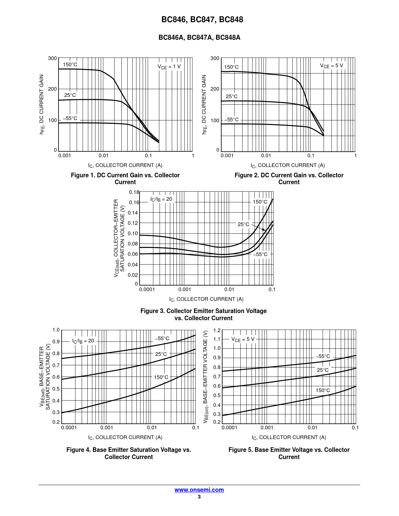

BC846, BC847, BC848. BC846A, BC847A, BC848A. Figure 1. DC Current Gain vs. Collector. Figure 2. DC Current Gain vs. Collector
BC846, BC847, BC848 BC846A, BC847A, BC848A Figure 1 DC Current Gain vs Collector Figure 2 DC Current Gain vs Collector
300 300 150°C V V CE = 1 V CE = 5 V 150°C 200 200 25°C 25°C 100 −55°C 100 −55°C , DC CURRENT GAIN , DC CURRENT GAIN FE FE h h 0 0 0.001 0.01 0.1 1 0.001 0.01 0.1 1 IC, COLLECTOR CURRENT (A) IC, COLLECTOR CURRENT (A)
Figure 1. DC Current Gain vs. Collector Figure 2. DC Current Gain vs. Collector Current Current
0.18 IC/IB = 20 0.16 150°C 0.14 AGE (V) 0.12 T 25°C OR−EMITTER 0.10 0.08 TION VOL 0.06 −55°C , COLLECT TURA 0.04 SA CE(sat)V 0.02 0 0.0001 0.001 0.01 0.1 IC, COLLECTOR CURRENT (A)
Figure 3. Collector Emitter Saturation Voltage vs. Collector Current
1.0 1.2 −55°C 1.1 V 0.9 IC/IB = 20 CE = 5 V AGE (V) 1.0 T 0.8 25°C 0.9 −55°C AGE (V) T 0.7 0.8 25°C 0.6 150°C 0.7 0.6 , BASE−EMITTER TION VOL 0.5 150°C sat) 0.5 BE( TURA 0.4 V , BASE−EMITTER VOL 0.4 SA 0.3 on) 0.3 BE( 0.2 V 0.2 0.0001 0.001 0.01 0.1 0.0001 0.001 0.01 0.1 IC, COLLECTOR CURRENT (A) IC, COLLECTOR CURRENT (A)
Figure 4. Base Emitter Saturation Voltage vs. Figure 5. Base Emitter Voltage vs. Collector Collector Current Current www.onsemi.com 3
