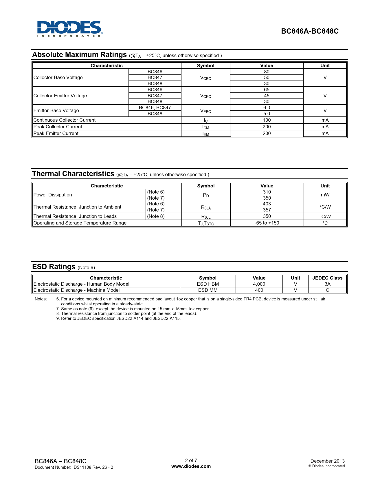

BC846A-BC848C. Absolute Maximum Ratings. Characteristic Symbol. Value. Unit. Thermal Characteristics. ESD Ratings. JEDEC. Class
BC846A-BC848C Absolute Maximum Ratings Characteristic Symbol Value Unit Thermal Characteristics ESD Ratings JEDEC Class
(@TA = +25°C, unless otherwise specified.)
BC846 80 Collector-Base Voltage BC847 VCBO V 50 BC848 30 BC846 65 Collector-Emitter Voltage BC847 VCEO V 45 BC848 30 BC846, BC847 6.0 Emitter-Base Voltage VEBO V BC848 5.0 Continuous Collector Current IC 100 mA Peak Collector Current ICM 200 mA Peak Emitter Current IEM 200 mA
(Note 6) 310 Power Dissipation PD mW (Note 7) 350 (Note 6) 403 Thermal Resistance, Junction to Ambient RθJA C/W (Note 7) 357 Thermal Resistance, Junction to Leads (Note 8) RθJL 350 C/W Operating and Storage Temperature Range TJ,TSTG -65 to +150 C
ESD Ratings
(Note 9)
Characteristic Symbol Value Unit JEDEC Class
Electrostatic Discharge - Human Body Model ESD HBM 4,000 V 3A Electrostatic Discharge - Machine Model ESD MM 400 V C Notes: 6. For a device mounted on minimum recommended pad layout 1oz copper that is on a single-sided FR4 PCB; device is measured under still air conditions whilst operating in a steady-state. 7. Same as note (6), except the device is mounted on 15 mm x 15mm 1oz copper. 8. Thermal resistance from junction to solder-point (at the end of the leads). 9. Refer to JEDEC specification JESD22-A114 and JESD22-A115. BC846A – BC848C 2 of 7 December 2013 Document Number: DS11108 Rev. 26 - 2
