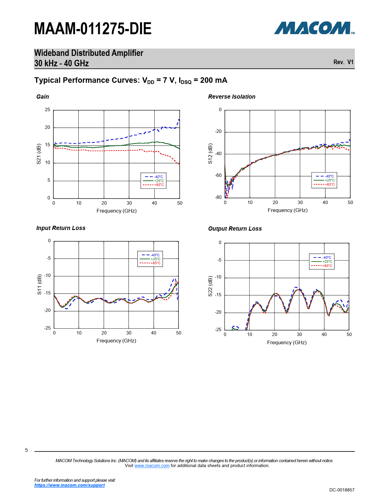

Pages / Page10 / 5 — MAAM-011275-DIE. Wideband Distributed Amplifier. 30 kHz - 40 GHz. Rev. …
MAAM-011275-DIE. Wideband Distributed Amplifier. 30 kHz - 40 GHz. Rev. V1. Typical Performance Curves: VDD = 7 V, IDSQ = 200 mA
MAAM-011275-DIE Wideband Distributed Amplifier 30 kHz - 40 GHz Rev V1 Typical Performance Curves: VDD = 7 V, IDSQ = 200 mA
MAAM-011275-DIE Wideband Distributed Amplifier 30 kHz - 40 GHz Rev. V1 Typical Performance Curves: VDD = 7 V, IDSQ = 200 mA Gain Reverse Isolation
25 0 20 -20 15 B) B) (d (d -40 21 12 S 10 S -40°C -60 -40°C 5 +25°C +25°C +85°C +85°C 0 -80 0 10 20 30 40 50 0 10 20 30 40 50 Frequency (GHz) Frequency (GHz)
Input Return Loss Output Return Loss
0 0 -40°C -5 +25°C -5 -40°C +85°C +25°C +85°C -10 B) -10 B) (d (d 11 2 S -15 2 S -15 -20 -20 -25 -25 0 10 20 30 40 50 0 10 20 30 40 50 Frequency (GHz) Frequency (GHz) 5 MACOM Technology Solutions Inc. (MACOM) and its affiliates reserve the right to make changes to the product(s) or information contained herein without notice.
