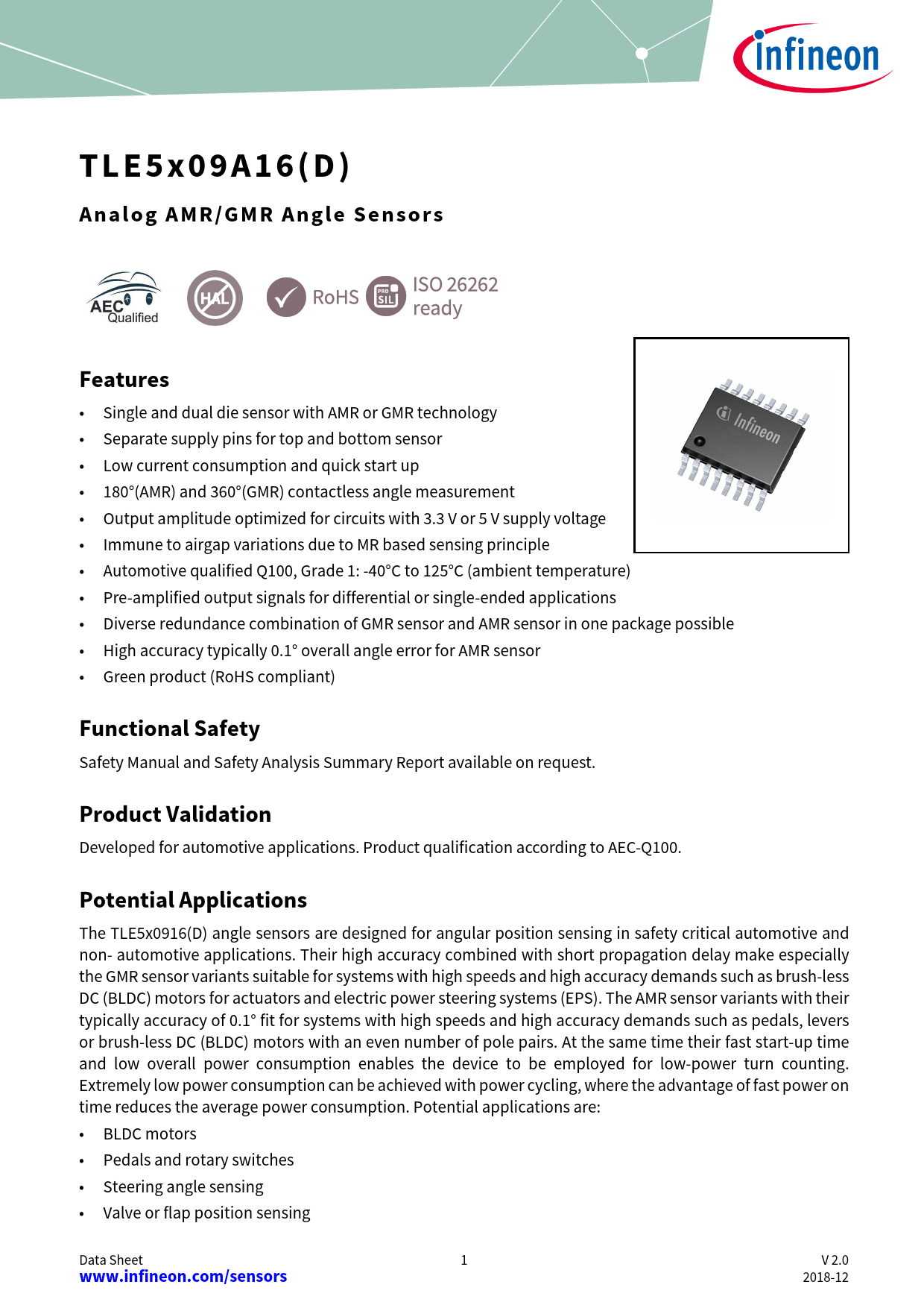

T L E 5 x 0 9 A 1 6 ( D ). A n a l o g A M R / G M R A n g l e S e n s o r s. Features. Functional Safety. Product Validation
Datasheet TLE5x09A16(D) Infineon, Revision: 02_00
T L E 5 x 0 9 A 1 6 ( D ) A n a l o g A M R / G M R A n g l e S e n s o r s Features
• Single and dual die sensor with AMR or GMR technology • Separate supply pins for top and bottom sensor • Low current consumption and quick start up • 180°(AMR) and 360°(GMR) contactless angle measurement • Output amplitude optimized for circuits with 3.3 V or 5 V supply voltage • Immune to airgap variations due to MR based sensing principle • Automotive qualified Q100, Grade 1: -40°C to 125°C (ambient temperature) • Pre-amplified output signals for differential or single-ended applications • Diverse redundance combination of GMR sensor and AMR sensor in one package possible • High accuracy typically 0.1° overall angle error for AMR sensor • Green product (RoHS compliant)
Functional Safety
Safety Manual and Safety Analysis Summary Report available on request.
Product Validation
Developed for automotive applications. Product qualification according to AEC-Q100.
Potential Applications
The TLE5x0916(D) angle sensors are designed for angular position sensing in safety critical automotive and non- automotive applications. Their high accuracy combined with short propagation delay make especially the GMR sensor variants suitable for systems with high speeds and high accuracy demands such as brush-less DC (BLDC) motors for actuators and electric power steering systems (EPS). The AMR sensor variants with their typically accuracy of 0.1° fit for systems with high speeds and high accuracy demands such as pedals, levers or brush-less DC (BLDC) motors with an even number of pole pairs. At the same time their fast start-up time and low overall power consumption enables the device to be employed for low-power turn counting. Extremely low power consumption can be achieved with power cycling, where the advantage of fast power on time reduces the average power consumption. Potential applications are: • BLD C motors • Pedals and rotary switches • Steering angle sensing • Valve or flap position sensing Data Sheet 1 V 2.0
