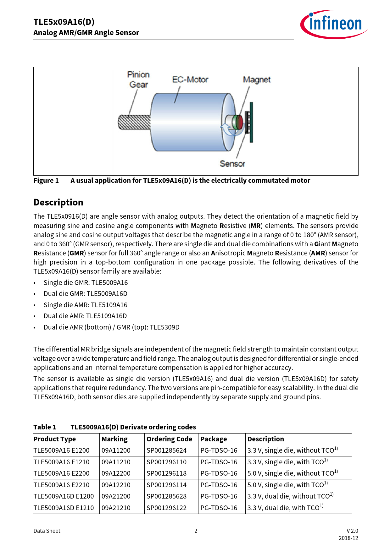

TLE5x09A16(D) Analog AMR/GMR Angle Sensor Figure 1 A usual application for TLE5x09A16(D) is the electrically commutated motor Description
