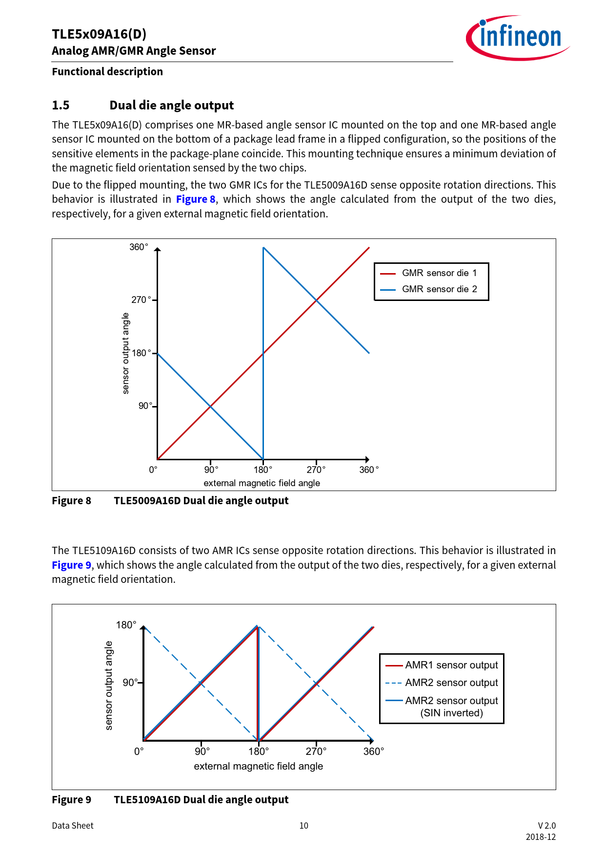

TLE5x09A16(D) Analog AMR/GMR Angle Sensor Functional description 1.5 Dual die angle output
The TLE5x09A16(D) comprises one MR-based angle sensor IC mounted on the top and one MR-based angle sensor IC mounted on the bottom of a package lead frame in a flipped configuration, so the positions of the sensitive elements in the package-plane coincide. This mounting technique ensures a minimum deviation of the magnetic field orientation sensed by the two chips. Due to the flipped mounting, the two GMR ICs for the TLE5009A16D sense opposite rotation directions. This behavior is illustrated in
Figure 8
, which shows the angle calculated from the output of the two dies, respectively, for a given external magnetic field orientation. 360° GMR sensor die 1 GMR sensor die 2 270 ° le ng t a 180 ° utpu o or ns se 90° 0° 90° 180° 270° 360 ° external magnetic field angle
Figure 8 TLE5009A16D Dual die angle output
The TLE5109A16D consists of two AMR ICs sense opposite rotation directions. This behavior is illustrated in
Figure 9
, which shows the angle calculated from the output of the two dies, respectively, for a given external magnetic field orientation. 180° AMR1 sensor output 90° AMR2 sensor output AMR2 sensor output (SIN inverted) sensor output angle 0° 90° 180° 270° 360° external magnetic field angle
Figure 9 TLE5109A16D Dual die angle output
