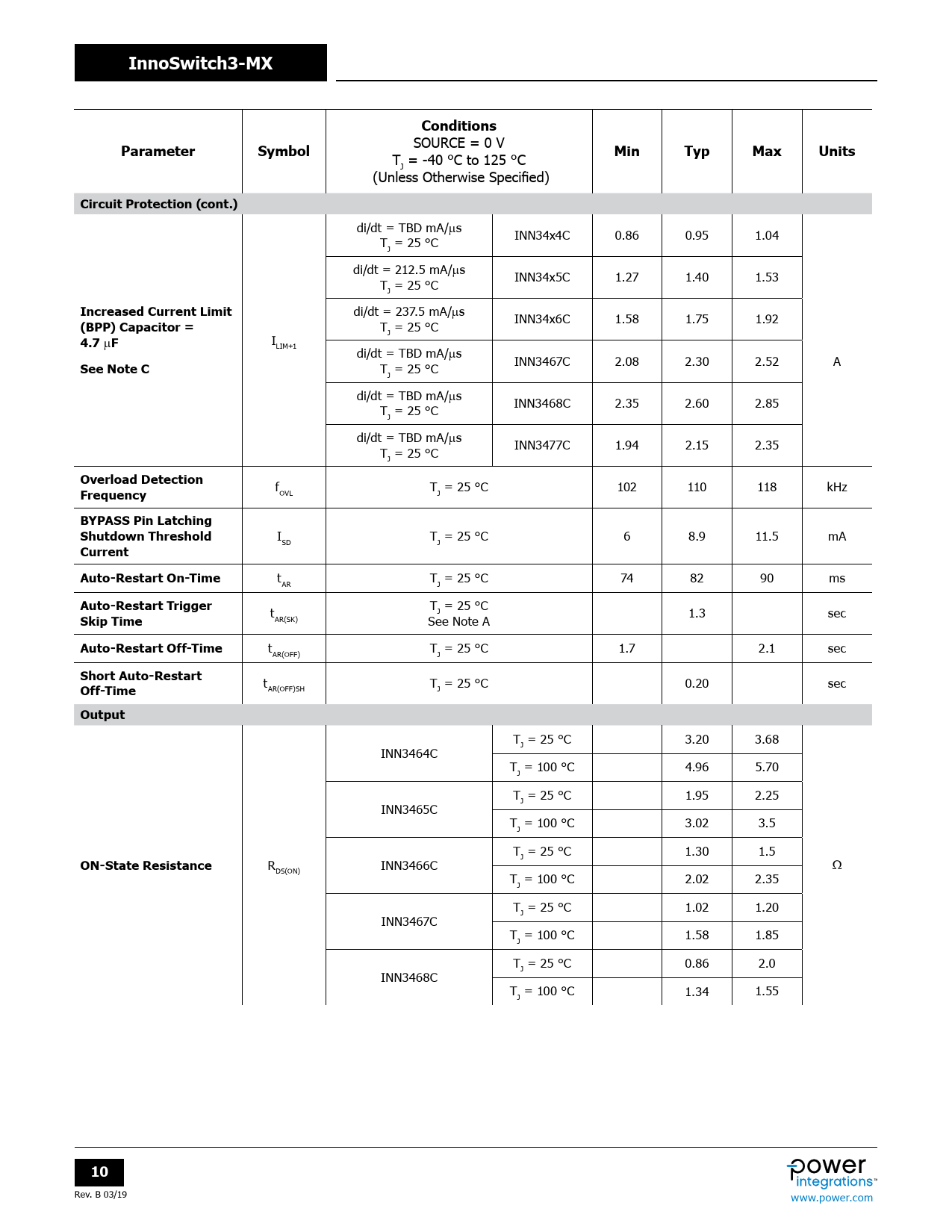

DescriptionOff-Line Multiple Output QR Flyback Switcher IC with Integrated 650 V or 725 V Switch, Synchronous Rectification and FluxLink Feedback
Pages / Page16 / 10 — InnoSwitch3-MX. Conditions. Parameter. Symbol. Min. Typ. Max. Units. …
InnoSwitch3-MX. Conditions. Parameter. Symbol. Min. Typ. Max. Units. Circuit Protection (cont.). Increased Current Limit. (BPP) Capacitor =
InnoSwitch3-MX Conditions Parameter Symbol Min Typ Max Units Circuit Protection (cont.) Increased Current Limit (BPP) Capacitor =
SOURCE = 0 V T = -40 °C to 125 °C
Min Typ Max Units
J (Unless Otherwise Specified)
di/dt = TBD mA/µs T = 25 °C INN34x4C 0.86 0.95 1.04 J di/dt = 212.5 mA/µs T = 25 °C INN34x5C 1.27 1.40 1.53 J
di/dt = 237.5 mA/µs
(BPP) Capacitor =
T = 25 °C INN34x6C 1.58 1.75 1.92 J
4.7
µ
F
ILIM+1 di/dt = TBD mA/µs
See Note C
A T = 25 °C INN3467C 2.08 2.30 2.52 J di/dt = TBD mA/µs T = 25 °C INN3468C 2.35 2.60 2.85 J di/dt = TBD mA/µs T = 25 °C INN3477C 1.94 2.15 2.35 J
Overload Detection Frequency
f T = 25 °C 102 110 118 kHz OVL J
BYPASS Pin Latching Shutdown Threshold
I T = 25 °C 6 8.9 11.5 mA SD J
Current Auto-Restart On-Time
t T = 25 °C 74 82 90 ms AR J
Auto-Restart Trigger
T = 25 °C J
Skip Time
tAR(SK) See Note A 1.3 sec
Auto-Restart Off-Time
t T = 25 °C 1.7 2.1 sec AR(OFF) J
Short Auto-Restart Off-Time
t T = 25 °C 0.20 sec AR(OFF)SH J
Output
T = 25 °C 3.20 3.68 INN3464C J T = 100 °C 4.96 5.70 J T = 25 °C 1.95 2.25 INN3465C J T = 100 °C 3.02 3.5 J T = 25 °C 1.30 1.5
ON-State Resistance
R INN3466C J Ω DS(ON) T = 100 °C 2.02 2.35 J T = 25 °C 1.02 1.20 INN3467C J T = 100 °C 1.58 1.85 J T = 25 °C 0.86 2.0 INN3468C J T = 100 °C 1.34 1.55 J
