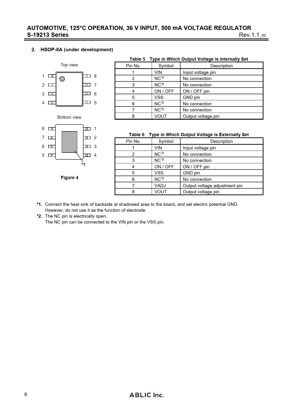

AUTOMOTIVE, 125°C OPERATION, 36 V INPUT, 500 mA VOLTAGE REGULATOR S-19213 Series. 2. HSOP-8A (under development)
AUTOMOTIVE, 125°C OPERATION, 36 V INPUT, 500 mA VOLTAGE REGULATOR S-19213 Series 2 HSOP-8A (under development)
Rev.1.1_00
2. HSOP-8A (under development) Table 5 Type in Which Output Voltage is Internally Set
Top view Pin No. Symbol Description 1 VIN Input voltage pin 1 8 2 NC
*2
No connection 2 7 3 NC
*2
No connection 4 ON / OFF ON / OFF pin 3 6 5 VSS GND pin 4 5 6 NC
*2
No connection 7 NC
*2
No connection Bottom view 8 VOUT Output voltage pin
8 1
Table 6 Type in Which Output Voltage is Externally Set
7 2 Pin No. Symbol Description 6 3 1 VIN Input voltage pin 5 4 2 NC
*2
No connection 3 NC
*2
No connection
*1
4 ON / OFF ON / OFF pin 5 VSS GND pin
Figure 4
6 NC
*2
No connection 7 VADJ Output voltage adjustment pin 8 VOUT Output voltage pin
*1.
Connect the heat sink of backside at shadowed area to the board, and set electric potential GND. However, do not use it as the function of electrode.
*2.
The NC pin is electrically open. The NC pin can be connected to the VIN pin or the VSS pin. 6
