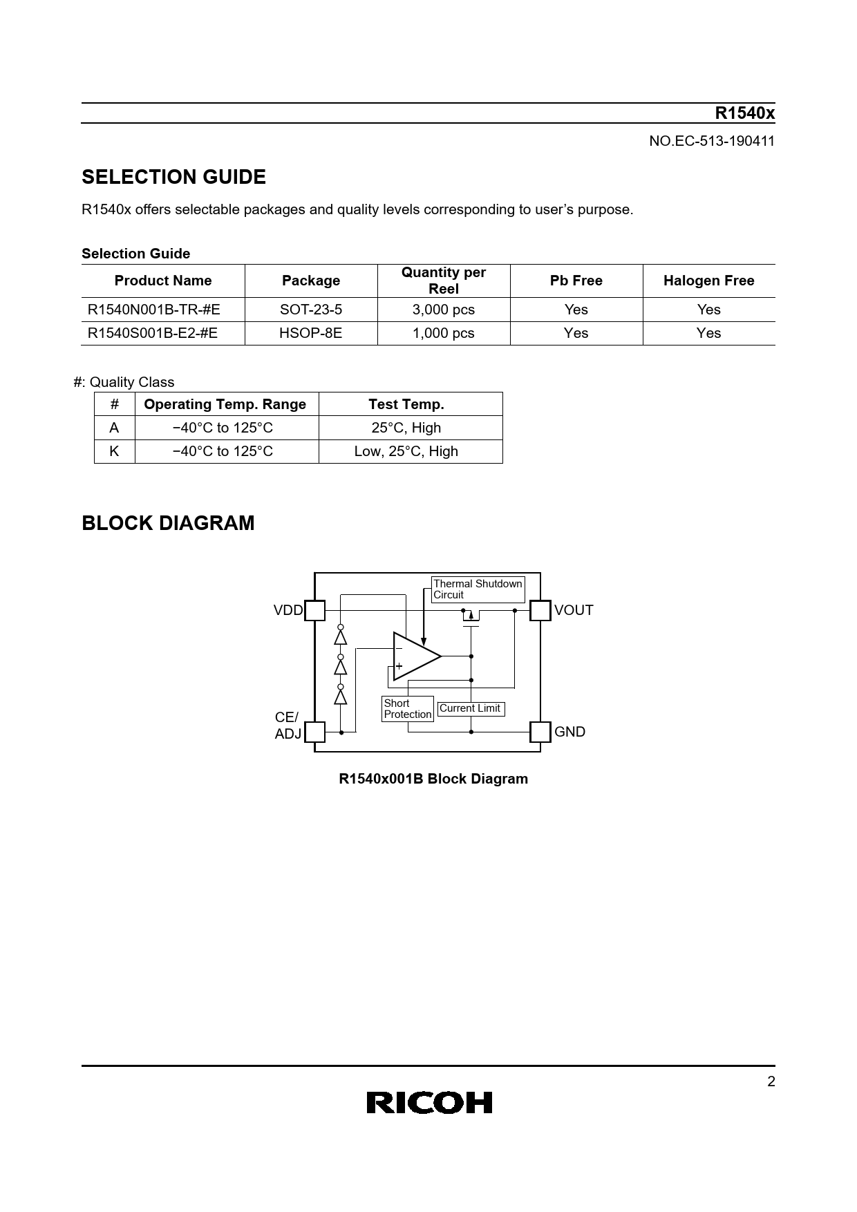

R1540x. SELECTION GUIDE. Selection Guide. Quantity per. Product Name. Package. Pb Free. Halogen Free. Reel. Operating Temp. Range
R1540x
NO.EC-513-190411
SELECTION GUIDE
R1540x offers selectable packages and quality levels corresponding to user’s purpose.
Selection Guide Quantity per Product Name Package Pb Free Halogen Free Reel
R1540N001B-TR-#E SOT-23-5 3,000 pcs Yes Yes R1540S001B-E2-#E HSOP-8E 1,000 pcs Yes Yes #: Quality Class #
Operating Temp. Range Test Temp.
A −40°C to 125°C 25°C, High K −40°C to 125°C Low, 25°C, High
BLOCK DIAGRAM
Thermal Shutdown Circuit VDD VOUT Short Current Limit CE/ Protection ADJ GND
R1540x001B Block Diagram
2
