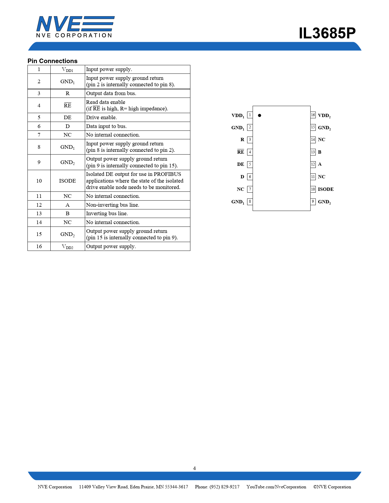

Pages / Page13 / 4 — IL3685P. Pin Connections. VDD. GND. ISODE
File Format / SizePDF / 507 Kb
IL3685P Pin Connections VDD GND ISODE
1 V DD1 Input power supply. Input power supply ground return 2 GND1 (pin 2 is internally connected to pin 8). 3 R Output data from bus. Read data enable 4 RE (if RE is high, R= high impedance). 5 DE Drive enable. 1 16
VDD VDD 1 2
6 D Data input to bus. 2 15
GND GND 1 2
7 NC No internal connection.
R
3 14
NC
Input power supply ground return 8 GND1 (pin 8 is internally connected to pin 2).
RE
4 13
B
Output power supply ground return 9 GND2 (pin 9 is internally connected to pin 15).
DE
5 12
A
Isolated DE output for use in PROFIBUS
D
6 11
NC
10 ISODE applications where the state of the isolated drive enable node needs to be monitored.
NC
7 10
ISODE
11 NC No internal connection. 12 A Non-inverting bus line.
GND
8 9
GND 1 2
13 B Inverting bus line. 14 NC No internal connection. Output power supply ground return 15 GND2 (pin 15 is internally connected to pin 9). 16 VDD2 Output power supply. 4 NVE Corporation 11409 Valley View Road, Eden Prairie, MN 55344-3617 Phone: (952) 829-9217 YouTube.com/NveCorporation ©NVE Corporation
