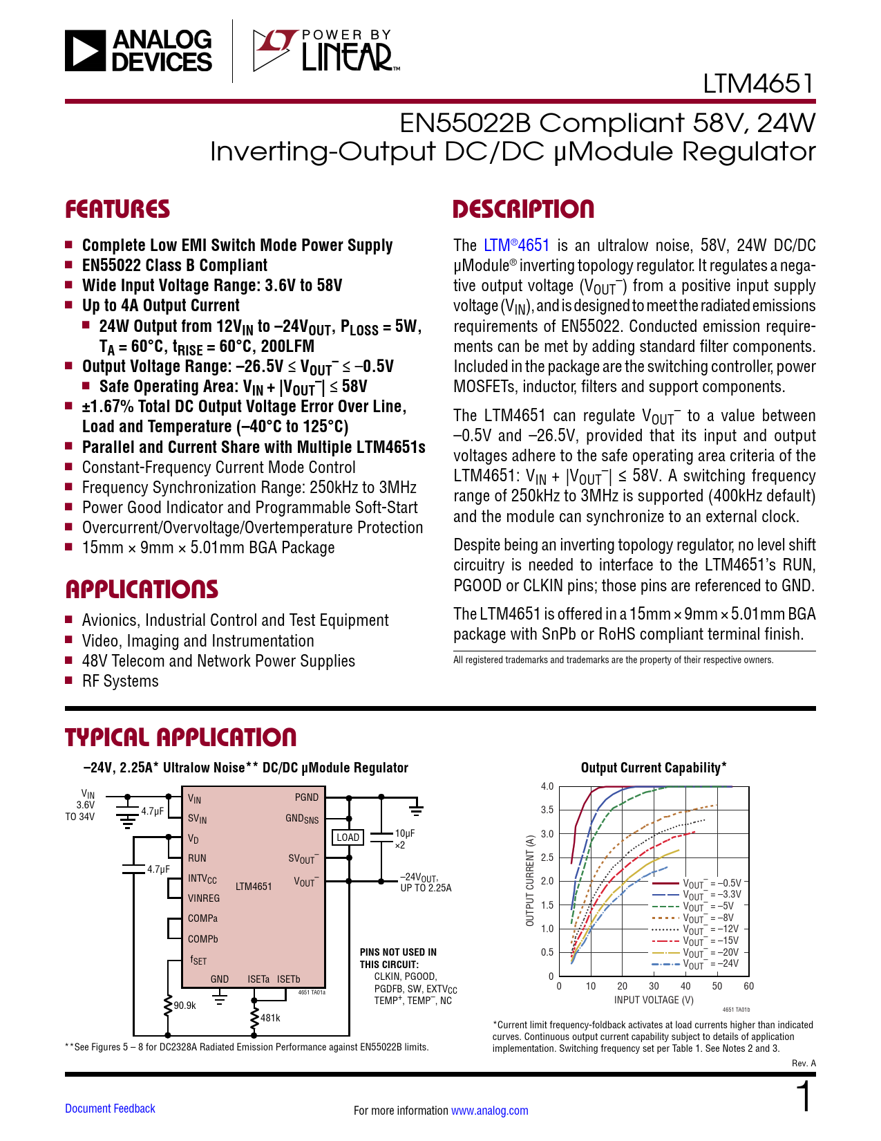

TYPICAL APPLICATION –24V, 2.25A* Ultralow Noise** DC/DC μModule Regulator Output Current Capability*
4.0 VIN VIN PGND 3.6V 4.7μF 3.5 TO 34V SVIN GNDSNS V 10µF 3.0 D LOAD ×2 RUN SV – OUT 2.5 4.7μF INTVCC V – –24V OUT OUT, – LTM4651 2.0 UP TO 2.25A VOUT = –0.5V – VINREG VOUT = –3.3V 1.5 V – OUT = –5V COMPa – OUTPUT CURRENT (A) VOUT = –8V 1.0 V – OUT = –12V COMPb V – OUT = –15V
PINS NOT USED IN
0.5 V – = –20V f OUT SET
THIS CIRCUIT:
V – OUT = –24V CLKIN, PGOOD, GND ISETa ISETb 0 0 10 20 30 40 50 60 4651 TA01a PGDFB, SW, EXTVCC TEMP+, TEMP–, NC 90.9k INPUT VOLTAGE (V) 4651 TA01b 481k *Current limit frequency-foldback activates at load currents higher than indicated curves. Continuous output current capability subject to details of application **See Figures 5 – 8 for DC2328A Radiated Emission Performance against EN55022B limits. implementation. Switching frequency set per Table 1. See Notes 2 and 3. Rev. A Document Feedback For more information www.analog.com 1 Document Outline Features Applications Typical Application Description Absolute Maximum Ratings Order Information Pin Configuration Electrical Characteristics Typical Performance Characteristics Pin Functions Simplified Block Diagram Test Circuit Decoupling Requirements Operation Applications Information Typical Applications Package Photograph Package Description Typical Application Related Parts
