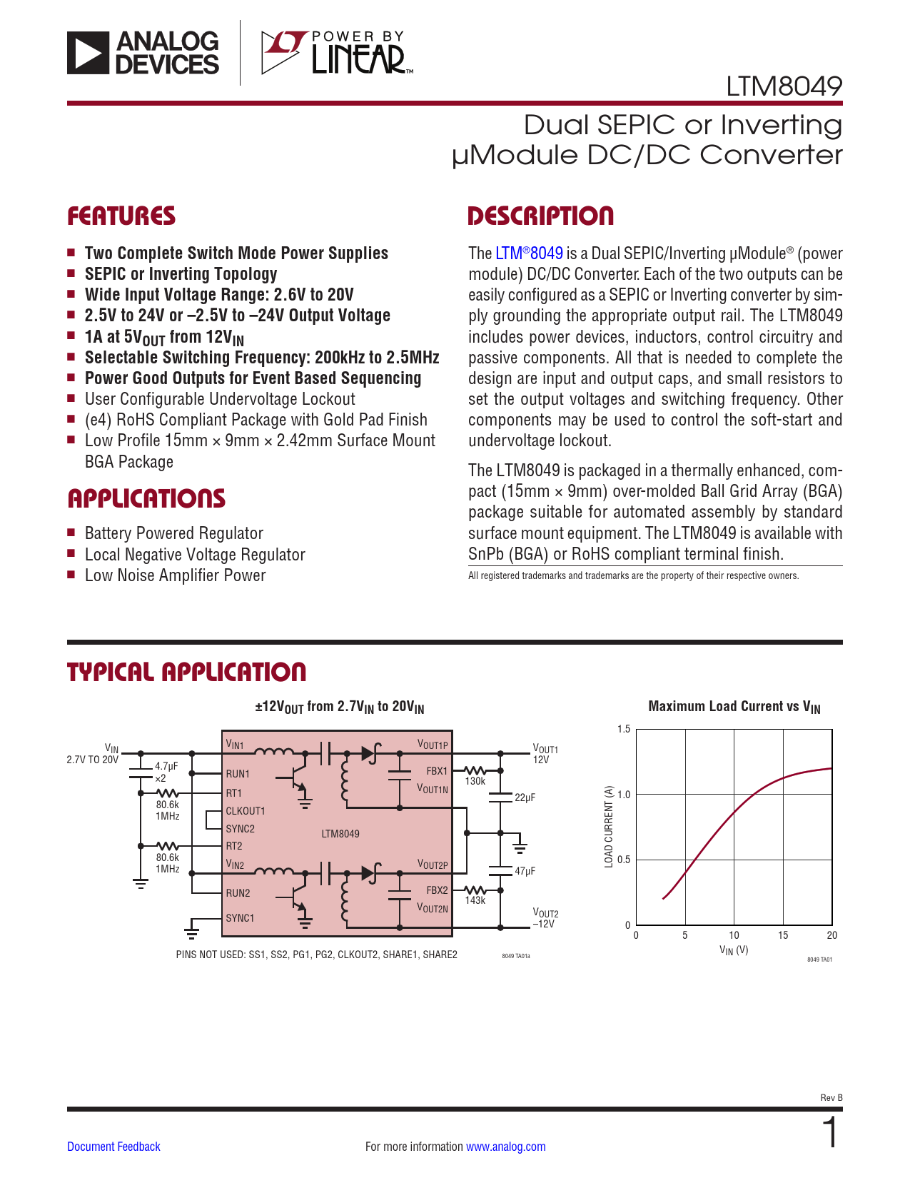

TYPICAL APPLICATION ±12VOUT from 2.7VIN to 20VIN Maximum Load Current vs VIN
1.5 V V IN1 VOUT1P IN VOUT1 2.7V TO 20V 12V 4.7µF RUN1 FBX1 ×2 130k VOUT1N RT1 1.0 22µF 80.6k 1MHz CLKOUT1 SYNC2 LTM8049 RT2 80.6k 0.5 VIN2 VOUT2P LOAD CURRENT (A) 1MHz 47µF RUN2 FBX2 143k VOUT2N VOUT2 SYNC1 –12V 0 0 5 10 15 20 VIN (V) PINS NOT USED: SS1, SS2, PG1, PG2, CLKOUT2, SHARE1, SHARE2 8049 TA01a 8049 TA01 Rev B Document Feedback For more information www.analog.com 1 Document Outline Features Applications Typical Application Description Absolute Maximum Ratings Order Information Pin Configuration Electrical Characteristics Typical Performance Characteristics Pin Functions Block Diagram Operation Applications Information Typical Applications Package Description Package Photo Revision History Typical Application Related Parts
