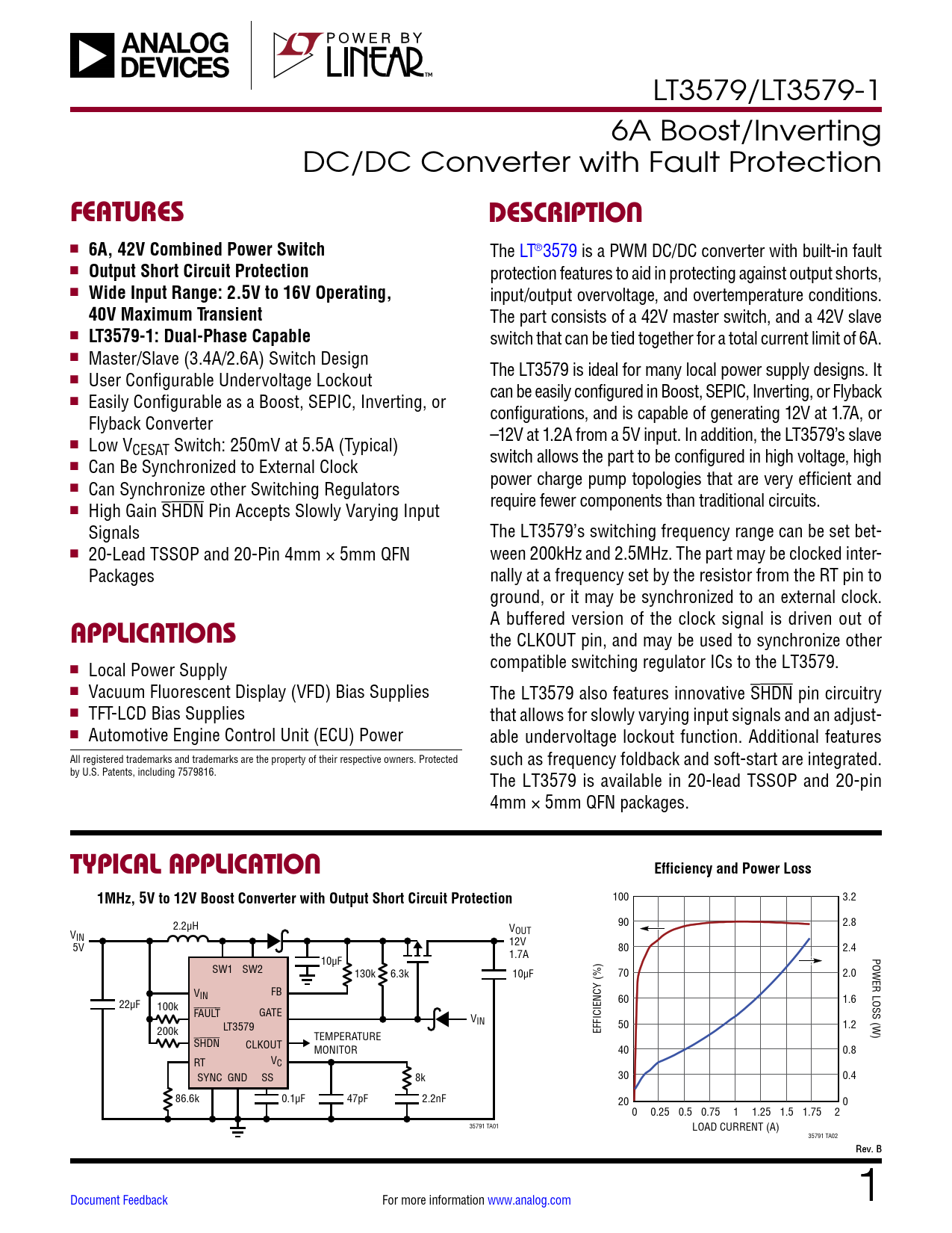

TYPICAL APPLICATION Efficiency and Power Loss 1MHz, 5V to 12V Boost Converter with Output Short Circuit Protection
100 3.2 2.2µH 90 2.8 V VOUT IN 5V 12V 1.7A 80 2.4 10µF POWER LOSS (W) SW1 SW2 130k 6.3k 10µF 70 2.0 V FB IN 22µF 60 1.6 100k FAULT GATE VIN 200k LT3579 EFFICIENCY (%) 50 1.2 SHDN TEMPERATURE CLKOUT MONITOR 40 0.8 RT VC SYNC GND SS 8k 30 0.4 86.6k 0.1µF 47pF 2.2nF 20 0 0 0.25 0.5 0.75 1 1.25 1.5 1.75 2 35791 TA01 LOAD CURRENT (A) 35791 TA02 Rev. B Document Feedback 1 For more information www.analog.com Document Outline Features Applications Description Typical Application Absolute Maximum Ratings Pin Configuration Order Information Electrical Characteristics Typical Performance Characteristics Pin Functions Block Diagram State Diagram Operation Applications Information Appendix Typical Application Package Description Typical Application Related Parts Features Applications Typical Application Description Absolute Maximum Ratings Pin Configuration Order Information Electrical Characteristics Typical Performance Characteristics Pin Functions Block Diagram State Diagram Operation Applications Information Appendix Typical Application Package Description Revision History Typical Application Related Parts
