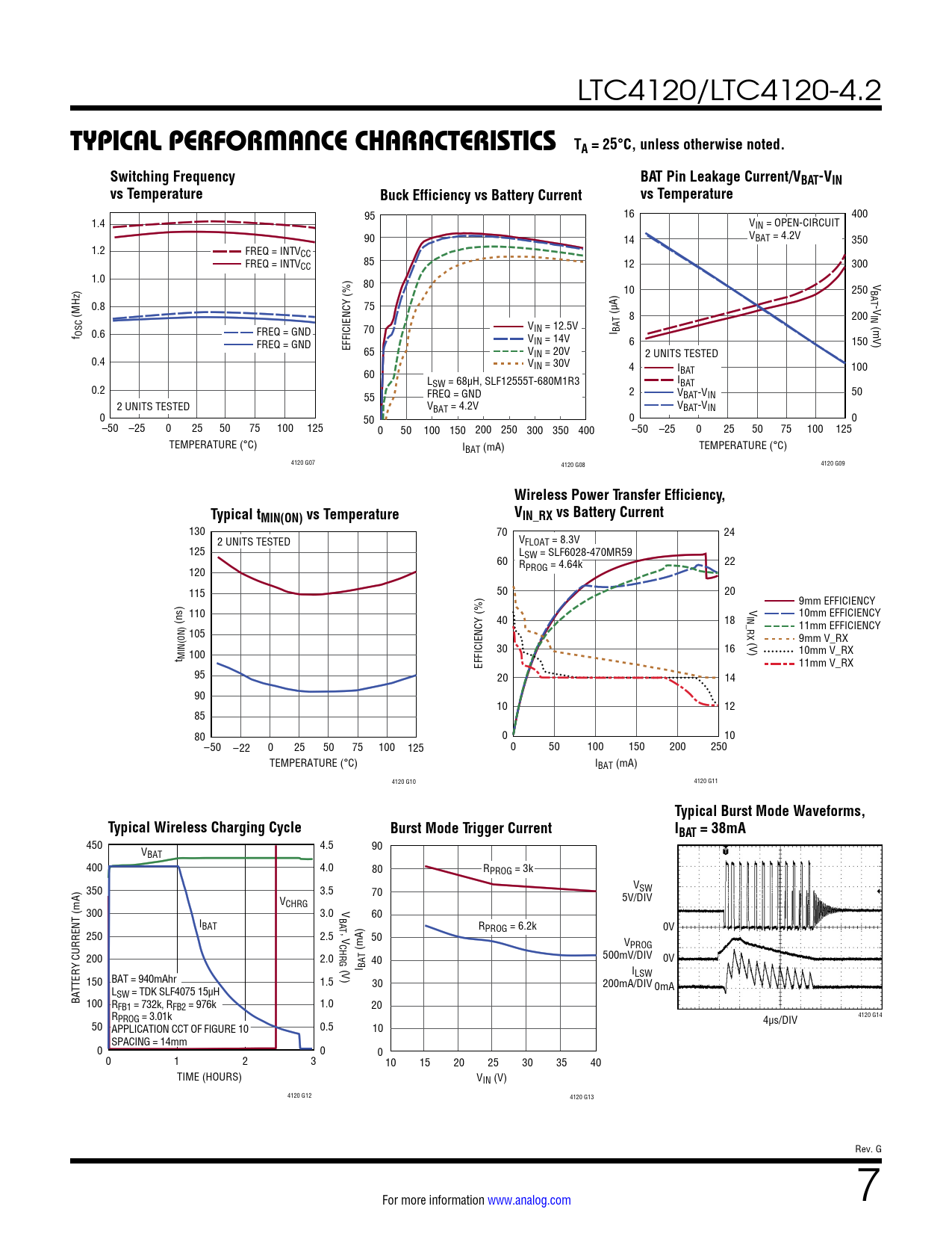

TYPICAL PERFORMANCE CHARACTERISTICS TA = 25°C, unless otherwise noted. Switching Frequency
LTC4120/LTC4120-4.2
TYPICAL PERFORMANCE CHARACTERISTICS TA = 25°C, unless otherwise noted. Switching Frequency BAT Pin Leakage Current/VBAT-VIN vs Temperature Buck Efficiency vs Battery Current vs Temperature
95 16 400 1.4 VIN = OPEN-CIRCUIT 90 14 VBAT = 4.2V 350 1.2 FREQ = INTVCC FREQ = INTVCC 85 12 300 1.0 80 VBAT 10 250 0.8 75 -V (MHz) (µA) IN 8 200 V (mV) f OSC 0.6 FREQ = GND 70 IN = 12.5V I BAT FREQ = GND V EFFICIENCY (%) IN = 14V 6 150 65 VIN = 20V 2 UNITS TESTED 0.4 VIN = 30V 4 I 100 60 BAT L IBAT 0.2 SW = 68µH, SLF12555T-680M1R3 55 FREQ = GND 2 V 50 BAT-VIN 2 UNITS TESTED VBAT = 4.2V VBAT-VIN 0 50 0 0 –50 –25 0 25 50 75 100 125 0 50 100 150 200 250 300 350 400 –50 –25 0 25 50 75 100 125 TEMPERATURE (°C) IBAT (mA) TEMPERATURE (°C) 4120 G07 4120 G08 4120 G09
Wireless Power Transfer Efficiency, Typical tMIN(ON) vs Temperature VIN_RX vs Battery Current
130 70 24 2 UNITS TESTED VFLOAT = 8.3V 125 L 60 SW = SLF6028-470MR59 22 R 120 PROG = 4.64k 115 50 20 V 9mm EFFICIENCY 110 IN_RX 10mm EFFICIENCY (ns) 40 18 11mm EFFICIENCY 105 (V) 9mm V_RX 30 16 10mm V_RX t MIN(0N) 100 EFFICIENCY (%) 11mm V_RX 95 20 14 90 10 12 85 80 0 10 –50 –22 0 25 50 75 100 125 0 50 100 150 200 250 TEMPERATURE (°C) IBAT (mA) 4120 G10 4120 G11
Typical Burst Mode Waveforms, Typical Wireless Charging Cycle Burst Mode Trigger Current IBAT = 38mA
