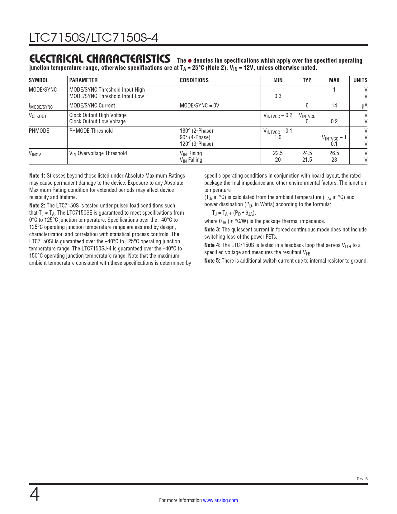

denotes the specifications which apply over the specified operating junction temperature range, otherwise specifications are at TA = 25°C (Note 2). VIN = 12V, unless otherwise noted. SYMBOL PARAMETER CONDITIONS MIN TYP MAX UNITS
MODE/SYNC MODE/SYNC Threshold Input High 1 V MODE/SYNC Threshold Input Low 0.3 V IMODE/SYNC MODE/SYNC Current MODE/SYNC = 0V 6 14 µA VCLKOUT Clock Output High Voltage VINTVCC – 0.2 VINTVCC V Clock Output Low Voltage 0 0.2 V PHMODE PHMODE Threshold 180° (2-Phase) VINTVCC – 0.1 V 90° (4-Phase) 1.0 VINTVCC – 1 V 120° (3-Phase) 0.1 V VINOV VIN Overvoltage Threshold VIN Rising 22.5 24.5 26.5 V VIN Falling 20 21.5 23 V
Note 1:
Stresses beyond those listed under Absolute Maximum Ratings specific operating conditions in conjunction with board layout, the rated may cause permanent damage to the device. Exposure to any Absolute package thermal impedance and other environmental factors. The junction Maximum Rating condition for extended periods may affect device temperature reliability and lifetime. (TJ, in °C) is calculated from the ambient temperature (TA, in °C) and
Note 2:
The LTC7150S is tested under pulsed load conditions such power dissipation (PD, in Watts) according to the formula: that TJ ≈ TA. The LTC7150SE is guaranteed to meet specifications from TJ = TA + (PD • θJA), 0°C to 125°C junction temperature. Specifications over the –40°C to where θJA (in °C/W) is the package thermal impedance. 125°C operating junction temperature range are assured by design,
Note 3:
The quiescent current in forced continuous mode does not include characterization and correlation with statistical process controls. The switching loss of the power FETs. LTC7150SI is guaranteed over the –40°C to 125°C operating junction temperature range. The LTC7150SJ-4 is guaranteed over the –40°C to
Note 4:
The LTC7150S is tested in a feedback loop that servos VITH to a 150°C operating junction temperature range. Note that the maximum specified voltage and measures the resultant VFB. ambient temperature consistent with these specifications is determined by
Note 5:
There is additional switch current due to internal resistor to ground. Rev. B 4 For more information www.analog.com Document Outline Features Applications Typical Application Description Absolute Maximum Ratings Order Information Pin Configuration Electrical Characteristics Electrical Characteristics Typical Performance Characteristics Pin Functions Block Diagram Operation Typical Applications Package Photo Revision History Typical Application Related Parts
