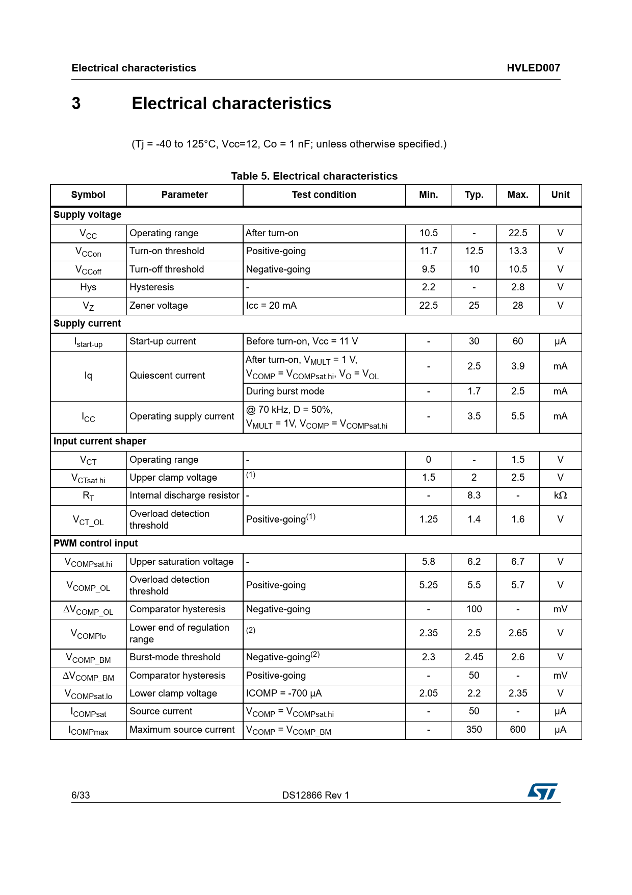

DescriptionTransition mode PFC controller for flyback converters
Pages / Page33 / 6 — Electrical characteristics. HVLED007. Table 5. Electrical …
Electrical characteristics. HVLED007. Table 5. Electrical characteristics. Symbol. Parameter. Test condition. Min. Typ. Max. Unit
Electrical characteristics HVLED007 Table 5 Electrical characteristics Symbol Parameter Test condition Min Typ Max Unit
link to page 8 link to page 8
Electrical characteristics HVLED007 3 Electrical characteristics
(Tj = -40 to 125°C, Vcc=12, Co = 1 nF; unless otherwise specified.)
Table 5. Electrical characteristics Symbol Parameter Test condition Min. Typ. Max. Unit Supply voltage
VCC Operating range After turn-on 10.5 - 22.5 V VCCon Turn-on threshold Positive-going 11.7 12.5 13.3 V VCCoff Turn-off threshold Negative-going 9.5 10 10.5 V Hys Hysteresis - 2.2 - 2.8 V VZ Zener voltage Icc = 20 mA 22.5 25 28 V
Supply current
Istart-up Start-up current Before turn-on, Vcc = 11 V - 30 60 μA After turn-on, VMULT = 1 V, - 2.5 3.9 mA Iq Quiescent current VCOMP = VCOMPsat.hi, VO = VOL During burst mode - 1.7 2.5 mA @ 70 kHz, D = 50%, ICC Operating supply current - 3.5 5.5 mA VMULT = 1V, VCOMP = VCOMPsat.hi
Input current shaper
VCT Operating range - 0 - 1.5 V VCTsat.hi Upper clamp voltage (1) 1.5 2 2.5 V RT Internal discharge resistor - - 8.3 - k Overload detection VCT_OL Positive-going(1) 1.25 1.4 1.6 V threshold
PWM control input
VCOMPsat.hi Upper saturation voltage - 5.8 6.2 6.7 V Overload detection VCOMP_OL Positive-going 5.25 5.5 5.7 V threshold VCOMP_OL Comparator hysteresis Negative-going - 100 - mV Lower end of regulation V (2) COMPlo 2.35 2.5 2.65 V range VCOMP_BM Burst-mode threshold Negative-going(2) 2.3 2.45 2.6 V VCOMP_BM Comparator hysteresis Positive-going - 50 - mV VCOMPsat.lo Lower clamp voltage ICOMP = -700 μA 2.05 2.2 2.35 V ICOMPsat Source current VCOMP = VCOMPsat.hi - 50 - μA ICOMPmax Maximum source current VCOMP = VCOMP_BM - 350 600 μA 6/33 DS12866 Rev 1 Document Outline Table 1. Device summary 1 Block diagram Figure 1. Block diagram Table 2. Absolute maximum ratings 2 Pin connections Figure 2. Pin connection (top view) Table 3. Thermal data Table 4. Pin functions (continued) 3 Electrical characteristics Table 5. Electrical characteristics (continued) 4 Application information 4.1 Introduction Figure 3. Input current distortion in Hi-PF QR flyback converters with traditional TM control: current shape and resulting total harmonic distortion and power factor vs. Kv (= Vinpk/VR) ratio 4.2 Input current shaping function - operating principle Figure 4. Hi-PF QR flyback converter with the traditional TM control: current waveforms Figure 5. Input current shaper (ICS) block and its interconnection with HVLED007 control Figure 6. Key waveforms of the ICS circuit in figure 5 Figure 7. Shape of the current reference Vcsref(θ) (5) at different input voltages (i.e. Kv values) 4.3 Operation of a Hi-PF QR flyback converter based on the HVLED007 Table 6. Timing quantities in a HVLED007-based Hi-PF QR flyback converter Table 7. Control quantities in a HVLED007-based Hi-PF QR flyback converter Table 8. Electrical quantities in a HVLED007-based Hi-PF QR flyback converter 4.4 Shaping capacitor (Ct) selection (pin CT) 4.5 Control input for isolated feedback and optocoupler driving (pin COMP) Figure 8. Output characteristic of pin COMP and significant levels 4.6 Multiplier input for input voltage sensing (pin MULT) 4.7 Current sensing input (pin CS). Sense resistor (Rs) selection Figure 9. Effect of ripple on Ct on current sense signal: a) within linear dynamics, close to clamp level; b) signal slightly exceeding clamp level; c) signal exceeding clamp level, with OCP activation 4.8 Zero current detection and triggering block (pin ZCD); starter 4.9 Overload and short-circuit protection (OCP function) Figure 10. Functional schematic of the overload and short-circuit protection function 4.10 Overvoltage protection (OVP function) Figure 11. Functional schematic of the OVP function 4.11 Soft-restart function Figure 12. Functional schematic of the soft restart function 4.12 Suggested step-by-step design procedure of a Hi-PF QR flyback converter based on the HVLED0007 Table 9. Basic electrical specification and key parameters of a Hi-PF QR flyback Figure 13. Typical application schematic (reference for suggested design procedure) 5 Referenced documents 6 Package information Table 10. SO-8 mechanical data Figure 14. Package dimensions 7 Revision history Table 11. Document history
