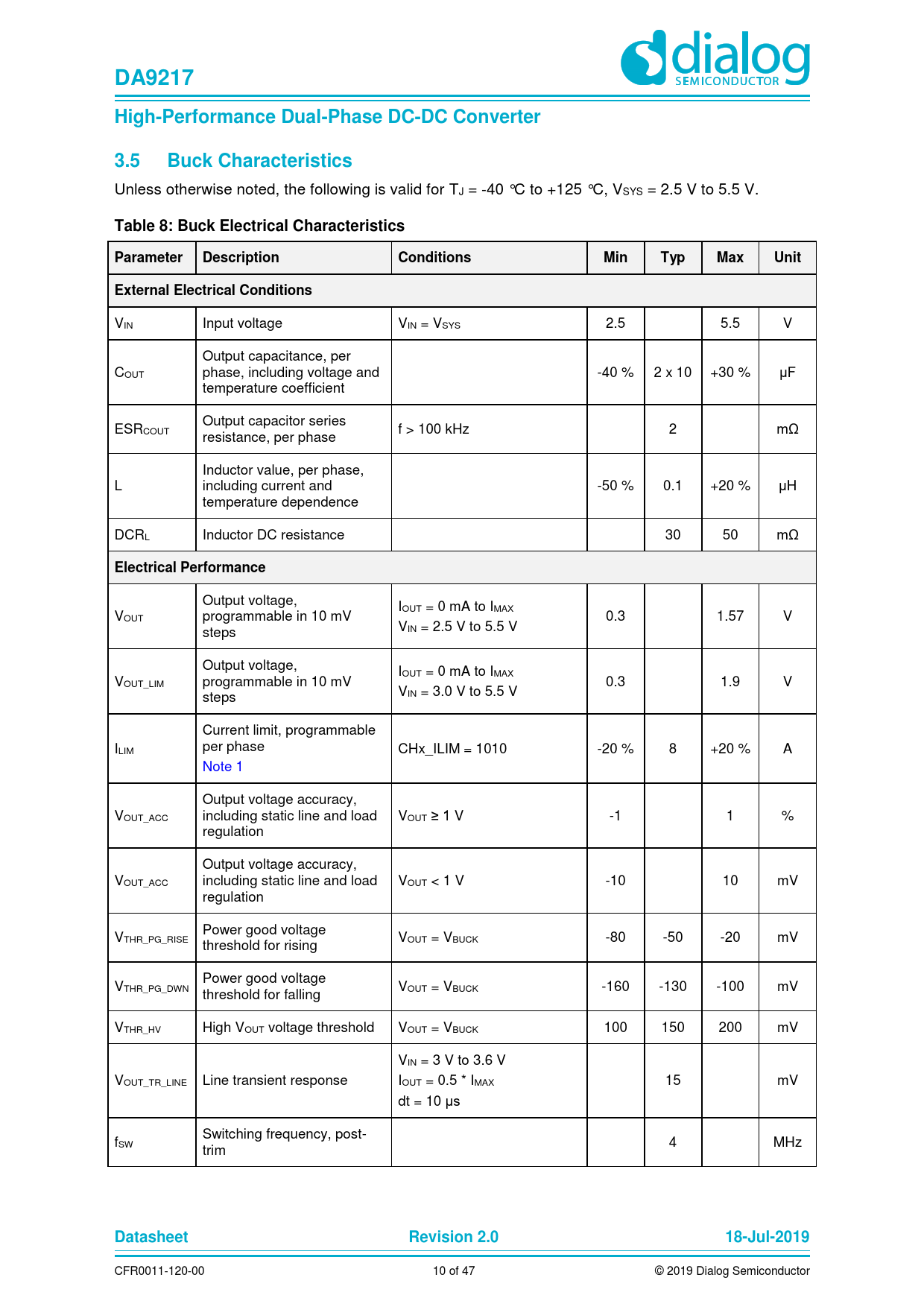

DA9217. High-Performance Dual-Phase DC-DC Converter. 3.5. Buck Characteristics. Table 8: Buck Electrical Characteristics
link to page 11
DA9217 High-Performance Dual-Phase DC-DC Converter 3.5 Buck Characteristics
Unless otherwise noted, the following is valid for TJ = -40 °C to +125 °C, VSYS = 2.5 V to 5.5 V.
Table 8: Buck Electrical Characteristics Parameter Description Conditions Min Typ Max Unit External Electrical Conditions
VIN Input voltage VIN = VSYS 2.5 5.5 V Output capacitance, per COUT phase, including voltage and -40 % 2 x 10 +30 % μF temperature coefficient Output capacitor series ESRCOUT f > 100 kHz 2 mΩ resistance, per phase Inductor value, per phase, L including current and -50 % 0.1 +20 % μH temperature dependence DCRL Inductor DC resistance 30 50 mΩ
Electrical Performance
Output voltage, IOUT = 0 mA to IMAX VOUT programmable in 10 mV 0.3 1.57 V steps VIN = 2.5 V to 5.5 V Output voltage, IOUT = 0 mA to IMAX VOUT_LIM programmable in 10 mV 0.3 1.9 V steps VIN = 3.0 V to 5.5 V Current limit, programmable ILIM per phase CHx_ILIM = 1010 -20 % 8 +20 % A Note 1 Output voltage accuracy, VOUT_ACC including static line and load VOUT ≥ 1 V -1 1 % regulation Output voltage accuracy, VOUT_ACC including static line and load VOUT < 1 V -10 10 mV regulation Power good voltage VTHR_PG_RISE V threshold for rising OUT = VBUCK -80 -50 -20 mV Power good voltage VTHR_PG_DWN V threshold for falling OUT = VBUCK -160 -130 -100 mV VTHR_HV High VOUT voltage threshold VOUT = VBUCK 100 150 200 mV VIN = 3 V to 3.6 V VOUT_TR_LINE Line transient response IOUT = 0.5 * IMAX 15 mV dt = 10 μs Switching frequency, post- fSW 4 MHz trim
