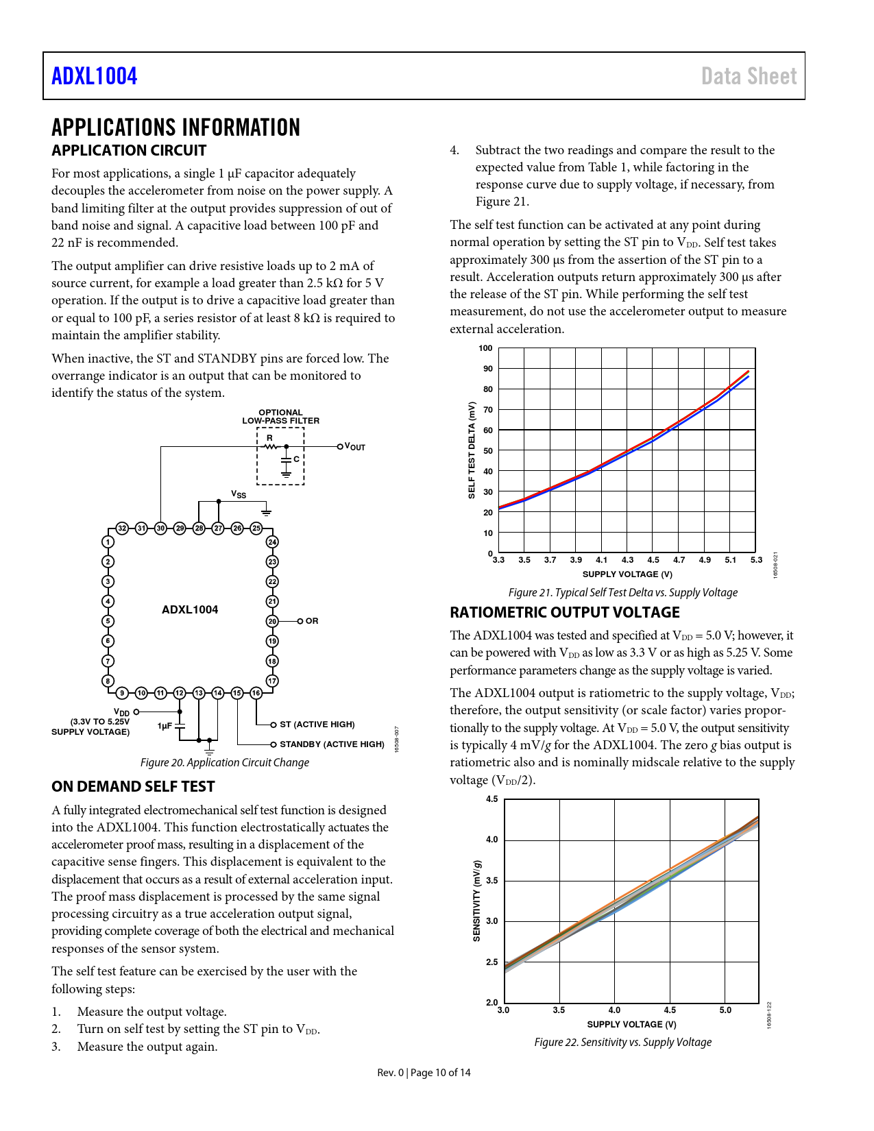

ADXL1004. Data Sheet. APPLICATIONS INFORMATION APPLICATION CIRCUIT. 100. OPTIONAL. LOW-PASS FILTER. (m A. LT E. VOUT. EST. T F. SEL
ADXL1004 Data Sheet APPLICATIONS INFORMATION APPLICATION CIRCUIT 100 OPTIONAL LOW-PASS FILTER (m A LT E VOUT EST T F SEL
link to page 3 link to page 10
4. Subtract the two readings and compare the result to the For most applications, a single 1 µF capacitor adequately expected value from Table 1, while factoring in the decouples the accelerometer from noise on the power supply. A response curve due to supply voltage, if necessary, from band limiting filter at the output provides suppression of out of Figure 21. band noise and signal. A capacitive load between 100 pF and The self test function can be activated at any point during 22 nF is recommended. normal operation by setting the ST pin to VDD. Self test takes The output amplifier can drive resistive loads up to 2 mA of approximately 300 µs from the assertion of the ST pin to a source current, for example a load greater than 2.5 kΩ for 5 V result. Acceleration outputs return approximately 300 µs after operation. If the output is to drive a capacitive load greater than the release of the ST pin. While performing the self test or equal to 100 pF, a series resistor of at least 8 kΩ is required to measurement, do not use the accelerometer output to measure maintain the amplifier stability. external acceleration.
100
When inactive, the ST and STANDBY pins are forced low. The overrange indicator is an output that can be monitored to
90
identify the status of the system.
80 V) OPTIONAL 70 LOW-PASS FILTER (m A 60 R LT E VOUT D 50 C EST 40 T F V 30 SS SEL 20 10 03.3 3.5 3.7 3.9 4.1 4.3 4.5 4.7 4.9 5.1 5.3
021
SUPPLY VOLTAGE (V)
16508- Figure 21. Typical Self Test Delta vs. Supply Voltage
ADXL1004 RATIOMETRIC OUTPUT VOLTAGE OR
The ADXL1004 was tested and specified at VDD = 5.0 V; however, it can be powered with VDD as low as 3.3 V or as high as 5.25 V. Some performance parameters change as the supply voltage is varied. The ADXL1004 output is ratiometric to the supply voltage, VDD;
V
therefore, the output sensitivity (or scale factor) varies propor-
DD (3.3V TO 5.25V 1µF ST (ACTIVE HIGH)
tional y to the supply voltage. At V
SUPPLY VOLTAGE)
DD = 5.0 V, the output sensitivity 007
STANDBY (ACTIVE HIGH)
is typically 4 mV/g for the ADXL1004. The zero g bias output is 16508- Figure 20. Application Circuit Change ratiometric also and is nominally midscale relative to the supply
ON DEMAND SELF TEST
voltage (VDD/2).
4.5
A fully integrated electromechanical self test function is designed into the ADXL1004. This function electrostatical y actuates the accelerometer proof mass, resulting in a displacement of the
4.0
capacitive sense fingers. This displacement is equivalent to the
) g
displacement that occurs as a result of external acceleration input.
V/ 3.5 (m
The proof mass displacement is processed by the same signal
Y T
processing circuitry as a true acceleration output signal,
IVI T SI 3.0
providing complete coverage of both the electrical and mechanical
SEN
responses of the sensor system.
2.5
The self test feature can be exercised by the user with the following steps:
2.0
1. Measure the output voltage.
3.0 3.5 4.0 4.5 5.0
122 2. Turn on self test by setting the ST pin to V
SUPPLY VOLTAGE (V)
DD. 16508- 3. Measure the output again. Figure 22. Sensitivity vs. Supply Voltage Rev. 0 | Page 10 of 14 Document Outline Features Applications Functional Block Diagram General Description Revision History Specifications Absolute Maximum Ratings Thermal Resistance Recommended Soldering Profile ESD Caution Pin Configuration and Function Descriptions Typical Performance Characteristics Theory of Operation Mechanical Device Operation Operating Modes Measurement Mode Standby Mode Bandwidth Applications Information Application Circuit On Demand Self Test Ratiometric Output Voltage Interfacing Analog Output Below 10 kHz Interfacing Analog Output Beyond 10 kHz Overrange Mechanical Considerations for Mounting Layout and Design Recommendations Outline Dimensions Ordering Guide Untitled
