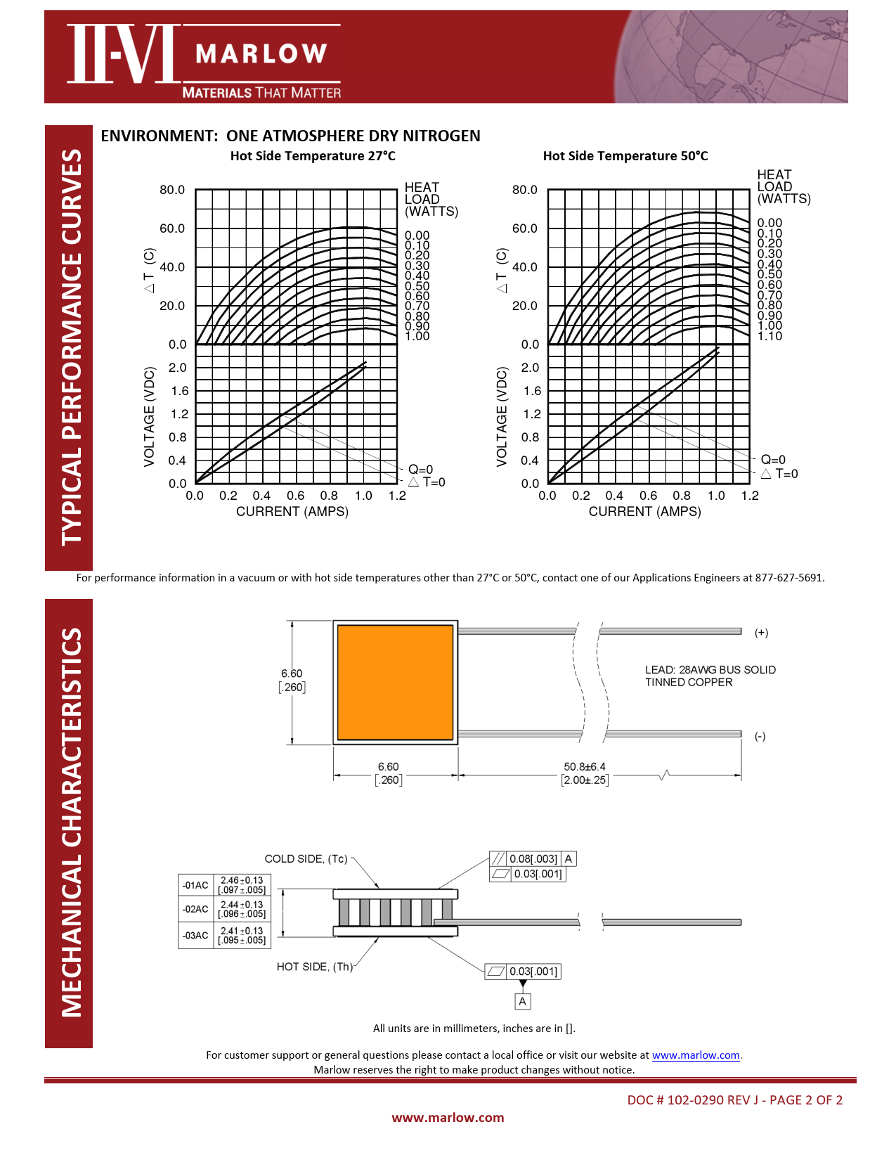

Pages / Page2 / 2 — ENVIRONMENT: ONE ATMOSPHERE DRY NITROGEN. S E. Hot Side Temperature 27°C. …
ENVIRONMENT: ONE ATMOSPHERE DRY NITROGEN. S E. Hot Side Temperature 27°C. Hot Side Temperature 50°C. S IC T IS R E T AC AR H
ENVIRONMENT: ONE ATMOSPHERE DRY NITROGEN S E Hot Side Temperature 27°C Hot Side Temperature 50°C S IC T IS R E T AC AR H
ENVIRONMENT: ONE ATMOSPHERE DRY NITROGEN S E Hot Side Temperature 27°C Hot Side Temperature 50°C V
HEAT 80.0 HEAT 80.0 LOAD
R
LOAD (WATTS)
U
(WATTS) 0.00 60.0 60.0
C
0.00 0.10 ) 0.10 0.20
E
) 0.20 0.30
C
(C 40.0 0.30 0.40 (C 40.0 T 0.40 T 0.50 0.50 0.60 0.60 0.70
AN
20.0 0.70 20.0 0.80 0.80 0.90
M
0.90 1.00 1.00 1.10
R
0.0 0.0
O
) 2.0 ) 2.0
F
C C D D
R
1.6 1.6 (V (V
E
E E G 1.2 G 1.2
P
A A T 0.8 T 0.8 L L O O
AL
V 0.4 0.4 Q=0 V Q=0 T=0
IC
0.0 T=0 0.0
P
0.0 0.2 0.4 0.6 0.8 1.0 1.2 0.0 0.2 0.4 0.6 0.8 1.0 1.2
Y
CURRENT (AMPS) CURRENT (AMPS)
T
For performance information in a vacuum or with hot side temperatures other than 27°C or 50°C, contact one of our Applications Engineers at 877-627-5691.
S IC T IS R E T AC AR H C AL IC AN H C E M
All units are in millimeters, inches are in [].
For customer support or general questions please contact a local office or visit our website at www.marlow.com. Marlow reserves the right to make product changes without notice. DOC # 102-0290 REV J - PAGE 2 OF 2
