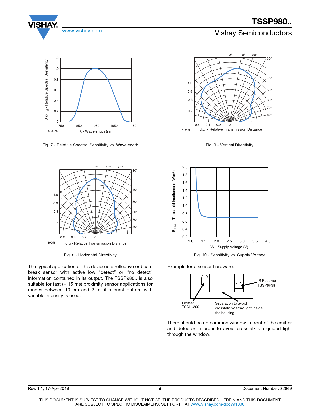

TSSP980..
www.vishay.com Vishay Semiconductors 0° 10° 20° 1.2 30° 1.0 0.8 40° 1.0 0.6 0.9 50° 0.4 0.8 60° - Relative Spectral Sensitivity 70° 0.2 0.7 λ) rel 80° S ( 0 750 850 950 1050 1150 0.6 0.4 0.2 0 d 94 8408 λ - Wavelength (nm) 19259 rel - Relative Transmission Distance Fig. 7 - Relative Spectral Sensitivity vs. Wavelength Fig. 9 - Vertical Directivity Axis Title 0° 10° 20° 2.0 10000 30° )2 1.8 /m W 1.6 (m 40° 1.4 1000 ance 1.0 ine 1.2 ne ne rradi 0.9 50° d I 2nd l 1.0 1st li 2nd li 0.8 60° 0.8 100 hreshol 70° T - 0.6 0.7 80° e min. 0.4 E 0.6 0.4 0.2 0 0.2 10 1.0 1.5 2.0 2.5 3.0 3.5 4.0 19258 drel - Relative Transmission Distance V - Supply Voltage (V) S Fig. 8 - Horizontal Directivity Fig. 10 - Sensitivity vs. Supply Voltage The typical application of this device is a reflective or beam Example for a sensor hardware: break sensor with active low “detect” or “no detect” information contained in its output. The TSSP980.. is also IR Receiver suitable for fast (~ 15 ms) proximity sensor applications for TSSP6P38 ranges between 10 cm and 2 m, if a burst pattern with variable intensity is used. Emitter Separation to avoid TSAL6200 crosstalk by stray light inside the housing There should be no common window in front of the emitter and detector in order to avoid crosstalk via guided light through the window. Rev. 1.1, 17-Apr-2019
