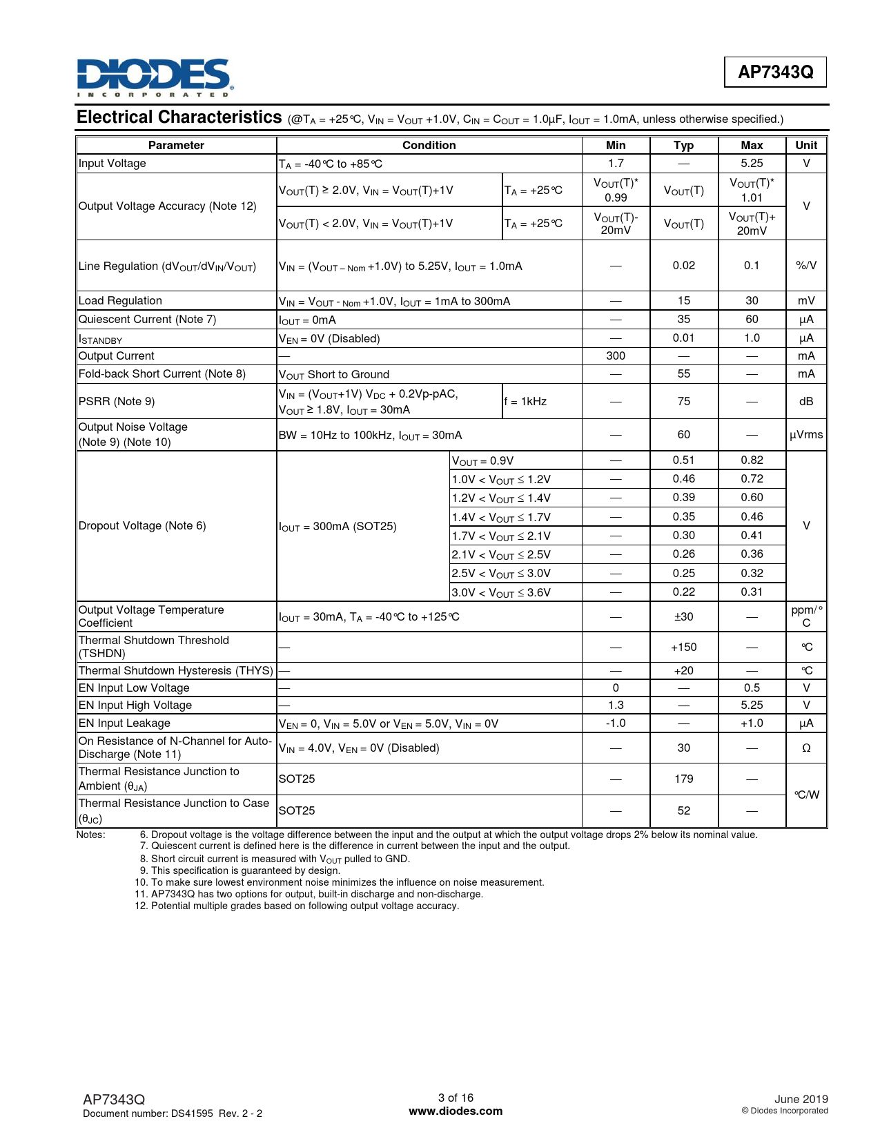

AP7343Q. Electrical Characteristics. Parameter. Condition. Min. Typ. Max. Unit. www.diodes.com
AP7343Q Electrical Characteristics
(@TA = +25°C, VIN = VOUT +1.0V, CIN = COUT = 1.0µF, IOUT = 1.0mA, unless otherwise specified.)
Parameter Condition Min Typ Max Unit
Input Voltage TA = -40°C to +85°C 1.7 — 5.25 V V V V OUT(T)* OUT(T)* OUT(T) ≥ 2.0V, VIN = VOUT(T)+1V TA = +25°C V 0.99 OUT(T) 1.01 Output Voltage Accuracy (Note 12) V V V V OUT(T)- OUT(T)+ OUT(T) < 2.0V, VIN = VOUT(T)+1V TA = +25°C V 20mV OUT(T) 20mV Line Regulation (dVOUT/dVIN/VOUT) VIN = (VOUT – Nom +1.0V) to 5.25V, IOUT = 1.0mA — 0.02 0.1 %/V Load Regulation VIN = VOUT - Nom +1.0V, IOUT = 1mA to 300mA — 15 30 mV Quiescent Current (Note 7) IOUT = 0mA — 35 60 µA ISTANDBY VEN = 0V (Disabled) — 0.01 1.0 µA Output Current — 300 — — mA Fold-back Short Current (Note 8) VOUT Short to Ground — 55 — mA VIN = (VOUT+1V) VDC + 0.2Vp-pAC, PSRR (Note 9) f = 1kHz — 75 — dB VOUT ≥ 1.8V, IOUT = 30mA Output Noise Voltage BW = 10Hz to 100kHz, I (Note 9) (Note 10) OUT = 30mA — 60 — µVrms VOUT = 0.9V — 0.51 0.82 1.0V < VOUT 1.2V — 0.46 0.72 1.2V < VOUT 1.4V — 0.39 0.60 1.4V < VOUT 1.7V — 0.35 0.46 Dropout Voltage (Note 6) IOUT = 300mA (SOT25) V 1.7V < VOUT 2.1V — 0.30 0.41 2.1V < VOUT 2.5V — 0.26 0.36 2.5V < VOUT 3.0V — 0.25 0.32 3.0V < VOUT 3.6V — 0.22 0.31 Output Voltage Temperature ppm/° I Coefficient OUT = 30mA, TA = -40° C to +125°C — ±30 — C Thermal Shutdown Threshold — — +150 — °C (TSHDN) Thermal Shutdown Hysteresis (THYS) — — +20 — °C EN Input Low Voltage — 0 — 0.5 V EN Input High Voltage — 1.3 — 5.25 V EN Input Leakage VEN = 0, VIN = 5.0V or VEN = 5.0V, VIN = 0V -1.0 — +1.0 µA On Resistance of N-Channel for Auto- V Discharge (Note 11) IN = 4.0V, VEN = 0V (Disabled) — 30 — Ω Thermal Resistance Junction to SOT25 — 179 — Ambient (JA) °C/W Thermal Resistance Junction to Case SOT25 — 52 — (JC) Notes: 6. Dropout voltage is the voltage difference between the input and the output at which the output voltage drops 2% below its nominal value. 7. Quiescent current is defined here is the difference in current between the input and the output. 8. Short circuit current is measured with VOUT pulled to GND. 9. This specification is guaranteed by design. 10. To make sure lowest environment noise minimizes the influence on noise measurement. 11. AP7343Q has two options for output, built-in discharge and non-discharge. 12. Potential multiple grades based on following output voltage accuracy. AP7343Q 3 of 16 June 2019 Document number: DS41595 Rev. 2 - 2
