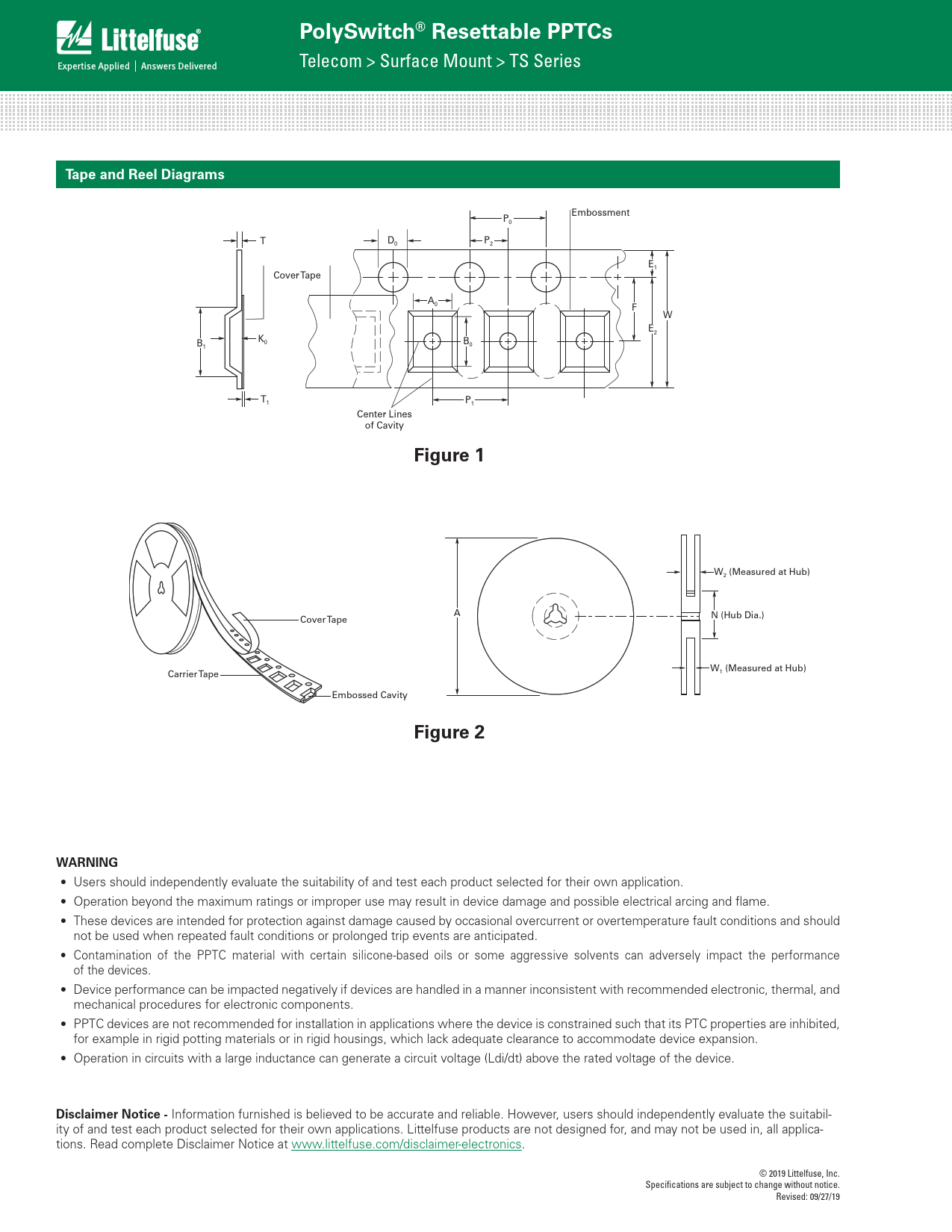

Tape and Reel Diagrams
P Embossment 0 T D0 P2 E1 Cover Tape A0 F W E2 B K0 B0 1 T1 P1 Center Lines of Cavity
Figure 1
W (Measured at Hub) 2 A Cover Tape N (Hub Dia.) W (Measured at Hub) Carrier Tape 1 Embossed Cavity
Figure 2 WARNING
