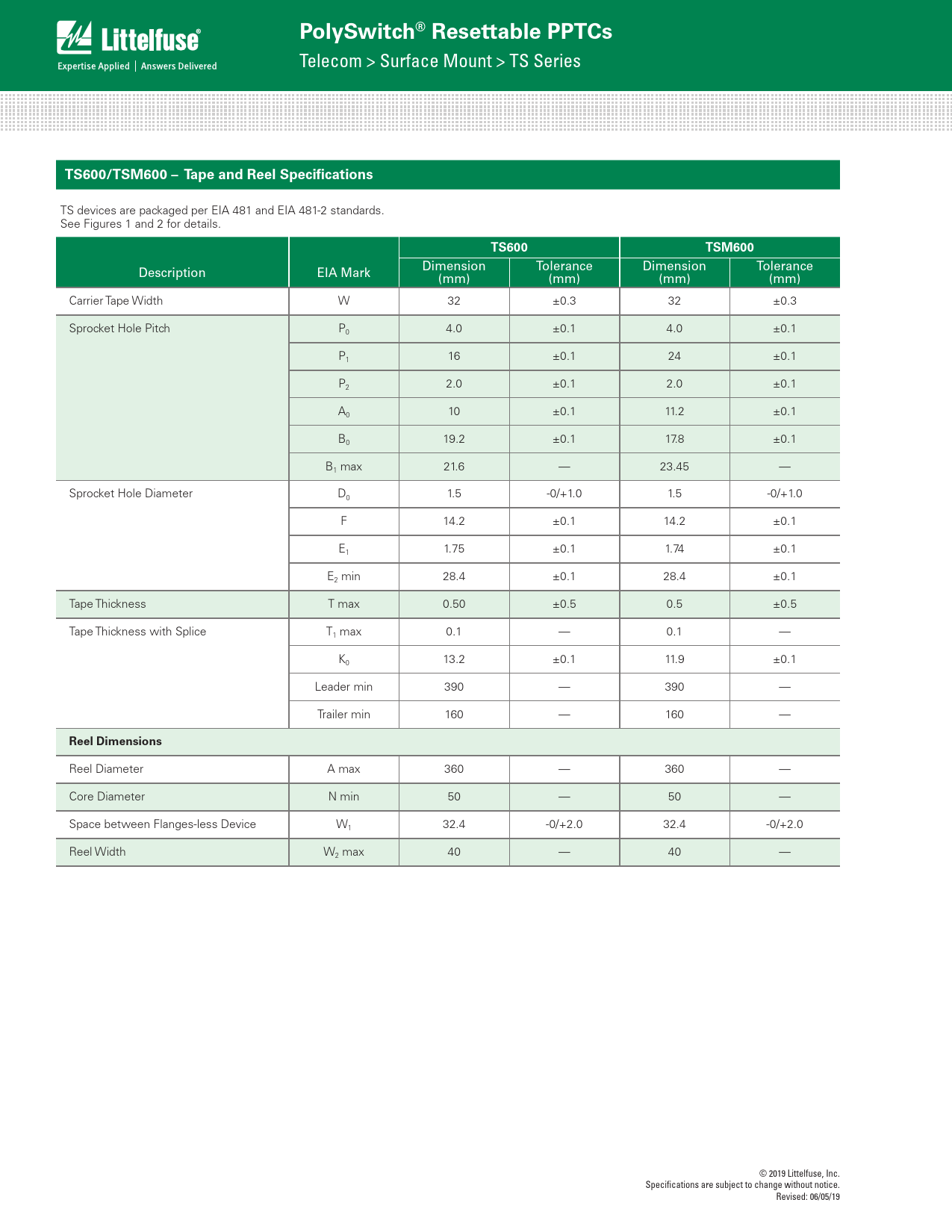

PolySwitch® Resettable PPTCs. TS600/TSM600 – Tape and Reel Specifications. TS600. TSM600. Reel Dimensions
Telecom > Surface Mount > TS Series
TS devices are packaged per EIA 481 and EIA 481-2 standards. See Figures 1 and 2 for details.
TS600 TSM600
Description EIA Mark Dimension Tolerance Dimension Tolerance (mm) (mm) (mm) (mm) Carrier Tape Width W 32 ±0.3 32 ±0.3 Sprocket Hole Pitch P0 4.0 ±0.1 4.0 ±0.1 P1 16 ±0.1 24 ±0.1 P2 2.0 ±0.1 2.0 ±0.1 A0 10 ±0.1 11.2 ±0.1 B0 19.2 ±0.1 17.8 ±0.1 B1 max 21.6 — 23.45 — Sprocket Hole Diameter D0 1.5 -0/+1.0 1.5 -0/+1.0 F 14.2 ±0.1 14.2 ±0.1 E1 1.75 ±0.1 1.74 ±0.1 E2 min 28.4 ±0.1 28.4 ±0.1 Tape Thickness T max 0.50 ±0.5 0.5 ±0.5 Tape Thickness with Splice T1 max 0.1 — 0.1 — K0 13.2 ±0.1 11.9 ±0.1 Leader min 390 — 390 — Trailer min 160 — 160 —
Reel Dimensions
Reel Diameter A max 360 — 360 — Core Diameter N min 50 — 50 — Space between Flanges-less Device W1 32.4 -0/+2.0 32.4 -0/+2.0 Reel Width W2 max 40 — 40 — © 2019 Littelfuse, Inc. Specifications are subject to change without notice. Revised: 06/05/19
