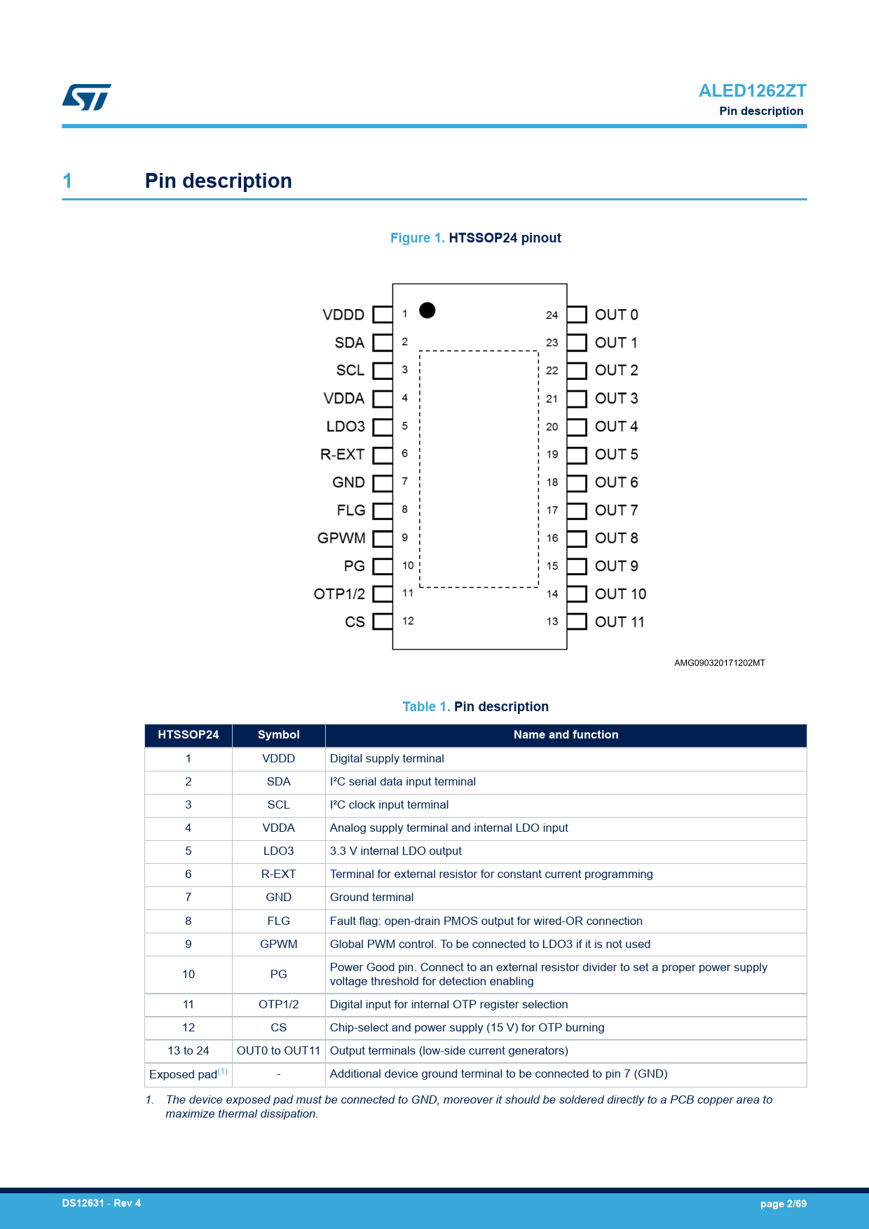

ALED1262ZT Pin description 1 Pin description Figure 1. HTSSOP24 pinout Table 1. Pin description HTSSOP24 Symbol Name and function
1 VDDD Digital supply terminal 2 SDA I²C serial data input terminal 3 SCL I²C clock input terminal 4 VDDA Analog supply terminal and internal LDO input 5 LDO3 3.3 V internal LDO output 6 R-EXT Terminal for external resistor for constant current programming 7 GND Ground terminal 8 FLG Fault flag: open-drain PMOS output for wired-OR connection 9 GPWM Global PWM control. To be connected to LDO3 if it is not used Power Good pin. Connect to an external resistor divider to set a proper power supply 10 PG voltage threshold for detection enabling 11 OTP1/2 Digital input for internal OTP register selection 12 CS Chip-select and power supply (15 V) for OTP burning 13 to 24 OUT0 to OUT11 Output terminals (low-side current generators) Exposed pad(1) - Additional device ground terminal to be connected to pin 7 (GND) 1. The device exposed pad must be connected to GND, moreover it should be soldered directly to a PCB copper area to maximize thermal dissipation.
