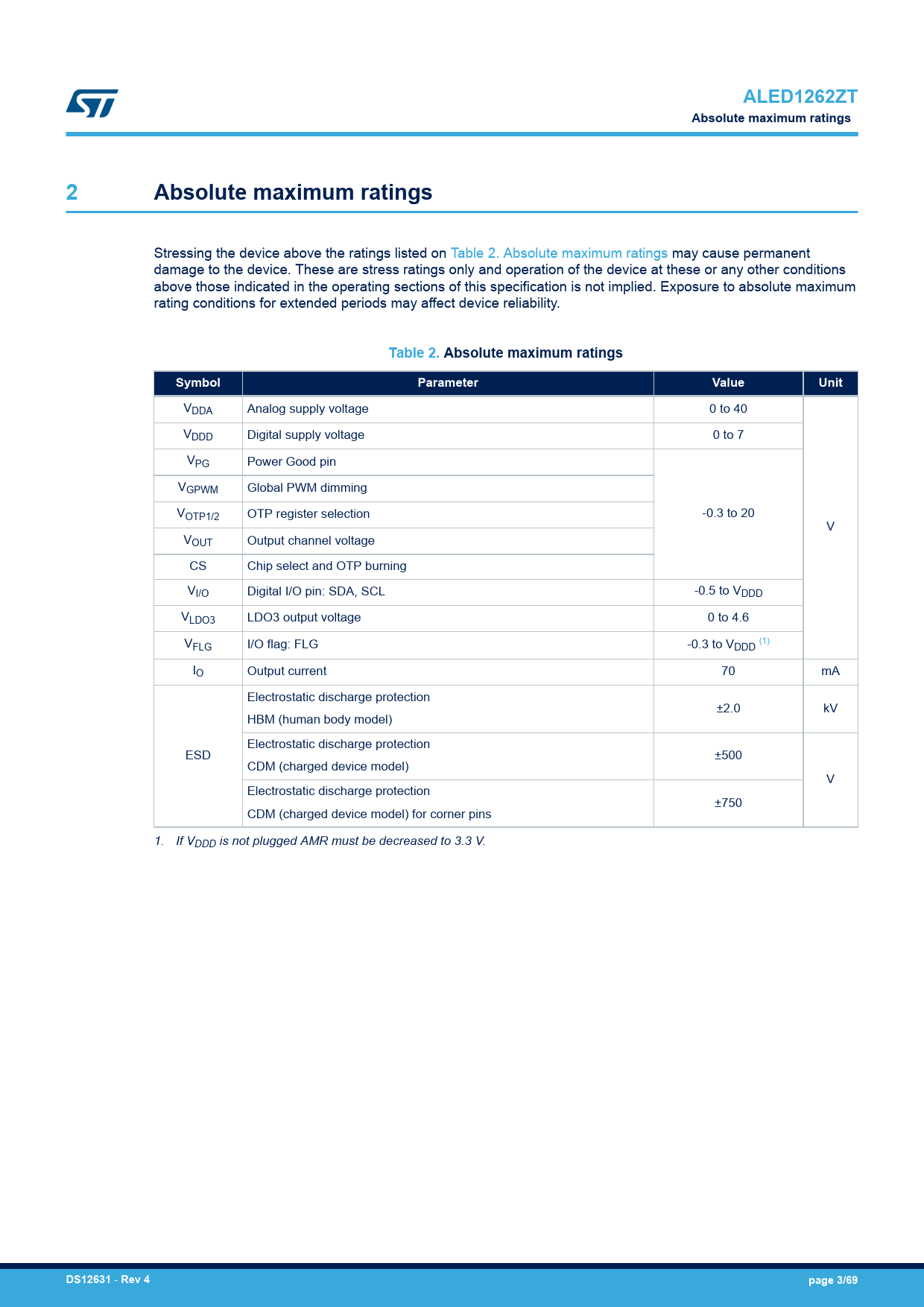

ALED1262ZT Absolute maximum ratings 2 Absolute maximum ratings
Stressing the device above the ratings listed on Table 2. Absolute maximum ratings may cause permanent damage to the device. These are stress ratings only and operation of the device at these or any other conditions above those indicated in the operating sections of this specification is not implied. Exposure to absolute maximum rating conditions for extended periods may affect device reliability.
Table 2. Absolute maximum ratings Symbol Parameter Value Unit
VDDA Analog supply voltage 0 to 40 VDDD Digital supply voltage 0 to 7 VPG Power Good pin VGPWM Global PWM dimming VOTP1/2 OTP register selection -0.3 to 20 V VOUT Output channel voltage CS Chip select and OTP burning VI/O Digital I/O pin: SDA, SCL -0.5 to VDDD VLDO3 LDO3 output voltage 0 to 4.6 VFLG I/O flag: FLG -0.3 to VDDD (1) IO Output current 70 mA Electrostatic discharge protection ±2.0 kV HBM (human body model) Electrostatic discharge protection ESD ±500 CDM (charged device model) V Electrostatic discharge protection ±750 CDM (charged device model) for corner pins 1. If VDDD is not plugged AMR must be decreased to 3.3 V.
