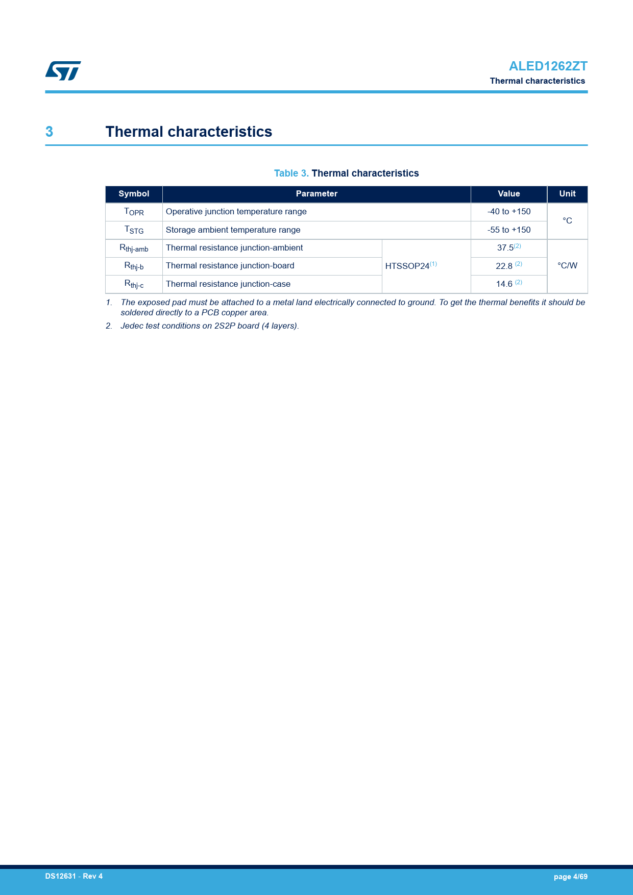

ALED1262ZT Thermal characteristics 3 Thermal characteristics Table 3. Thermal characteristics Symbol Parameter Value Unit
TOPR Operative junction temperature range -40 to +150 °C TSTG Storage ambient temperature range -55 to +150 Rthj-amb Thermal resistance junction-ambient 37.5(2) Rthj-b Thermal resistance junction-board HTSSOP24(1) 22.8 (2) °C/W Rthj-c Thermal resistance junction-case 14.6 (2) 1. The exposed pad must be attached to a metal land electrically connected to ground. To get the thermal benefits it should be soldered directly to a PCB copper area. 2. Jedec test conditions on 2S2P board (4 layers).
