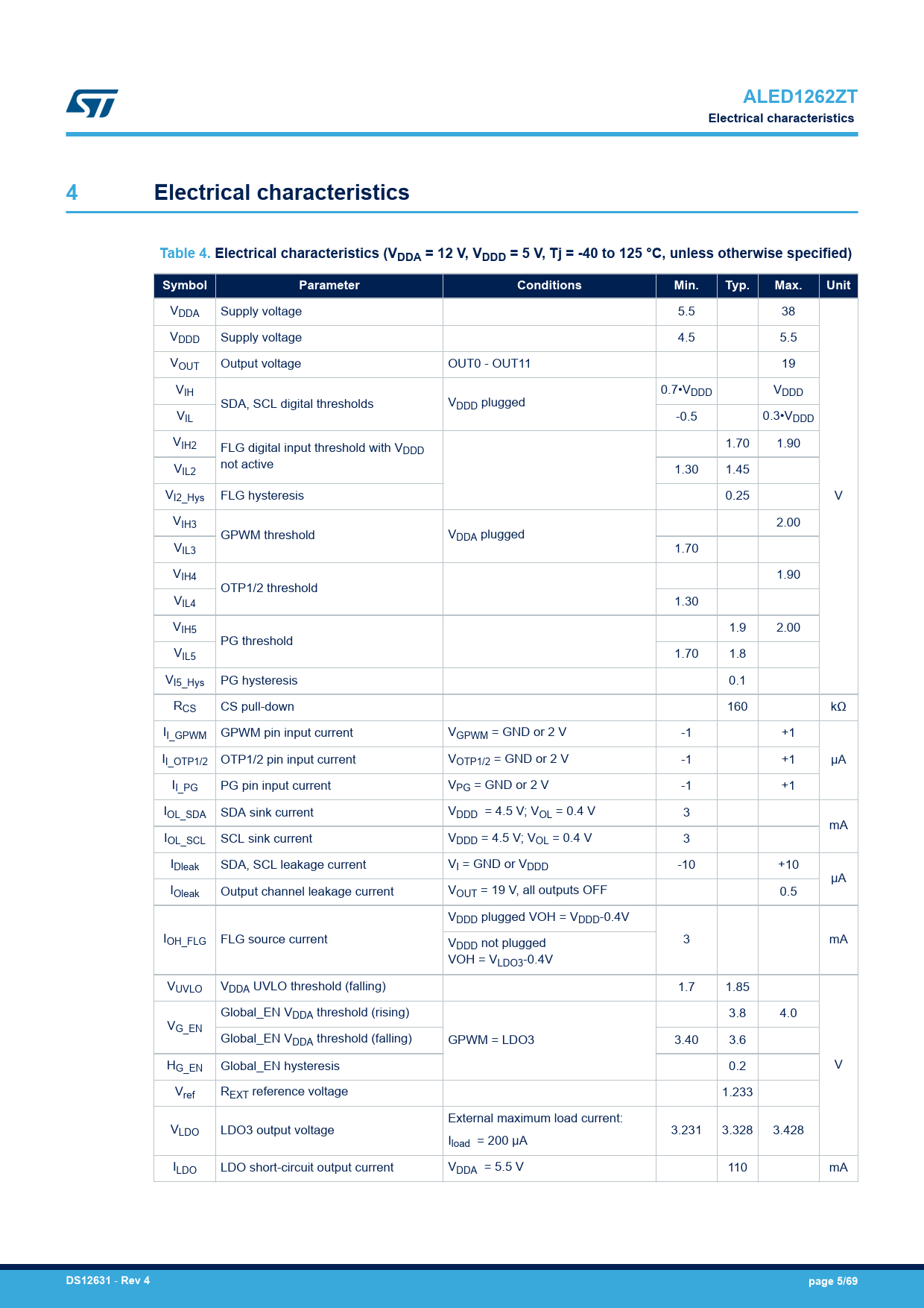

ALED1262ZT Electrical characteristics 4 Electrical characteristics Table 4. Electrical characteristics (VDDA = 12 V, VDDD = 5 V, Tj = -40 to 125 °C, unless otherwise specified) Symbol Parameter Conditions Min. Typ. Max. Unit
VDDA Supply voltage 5.5 38 VDDD Supply voltage 4.5 5.5 VOUT Output voltage OUT0 - OUT11 19 VIH 0.7•VDDD VDDD SDA, SCL digital thresholds VDDD plugged VIL -0.5 0.3•VDDD VIH2 FLG digital input threshold with V 1.70 1.90 DDD not active VIL2 1.30 1.45 VI2_Hys FLG hysteresis 0.25 V VIH3 2.00 GPWM threshold VDDA plugged VIL3 1.70 VIH4 1.90 OTP1/2 threshold VIL4 1.30 VIH5 1.9 2.00 PG threshold VIL5 1.70 1.8 VI5_Hys PG hysteresis 0.1 RCS CS pull-down 160 kΩ II_GPWM GPWM pin input current VGPWM = GND or 2 V -1 +1 II_OTP1/2 OTP1/2 pin input current VOTP1/2 = GND or 2 V -1 +1 µA II_PG PG pin input current VPG = GND or 2 V -1 +1 IOL_SDA SDA sink current VDDD = 4.5 V; VOL = 0.4 V 3 mA IOL_SCL SCL sink current VDDD = 4.5 V; VOL = 0.4 V 3 IDleak SDA, SCL leakage current VI = GND or VDDD -10 +10 µA IOleak Output channel leakage current VOUT = 19 V, all outputs OFF 0.5 VDDD plugged VOH = VDDD-0.4V IOH_FLG FLG source current 3 mA VDDD not plugged VOH = VLDO3-0.4V VUVLO VDDA UVLO threshold (falling) 1.7 1.85 Global_EN VDDA threshold (rising) 3.8 4.0 VG_EN Global_EN VDDA threshold (falling) GPWM = LDO3 3.40 3.6 H V G_EN Global_EN hysteresis 0.2 Vref REXT reference voltage 1.233 External maximum load current: VLDO LDO3 output voltage 3.231 3.328 3.428 Iload = 200 µA ILDO LDO short-circuit output current VDDA = 5.5 V 110 mA
