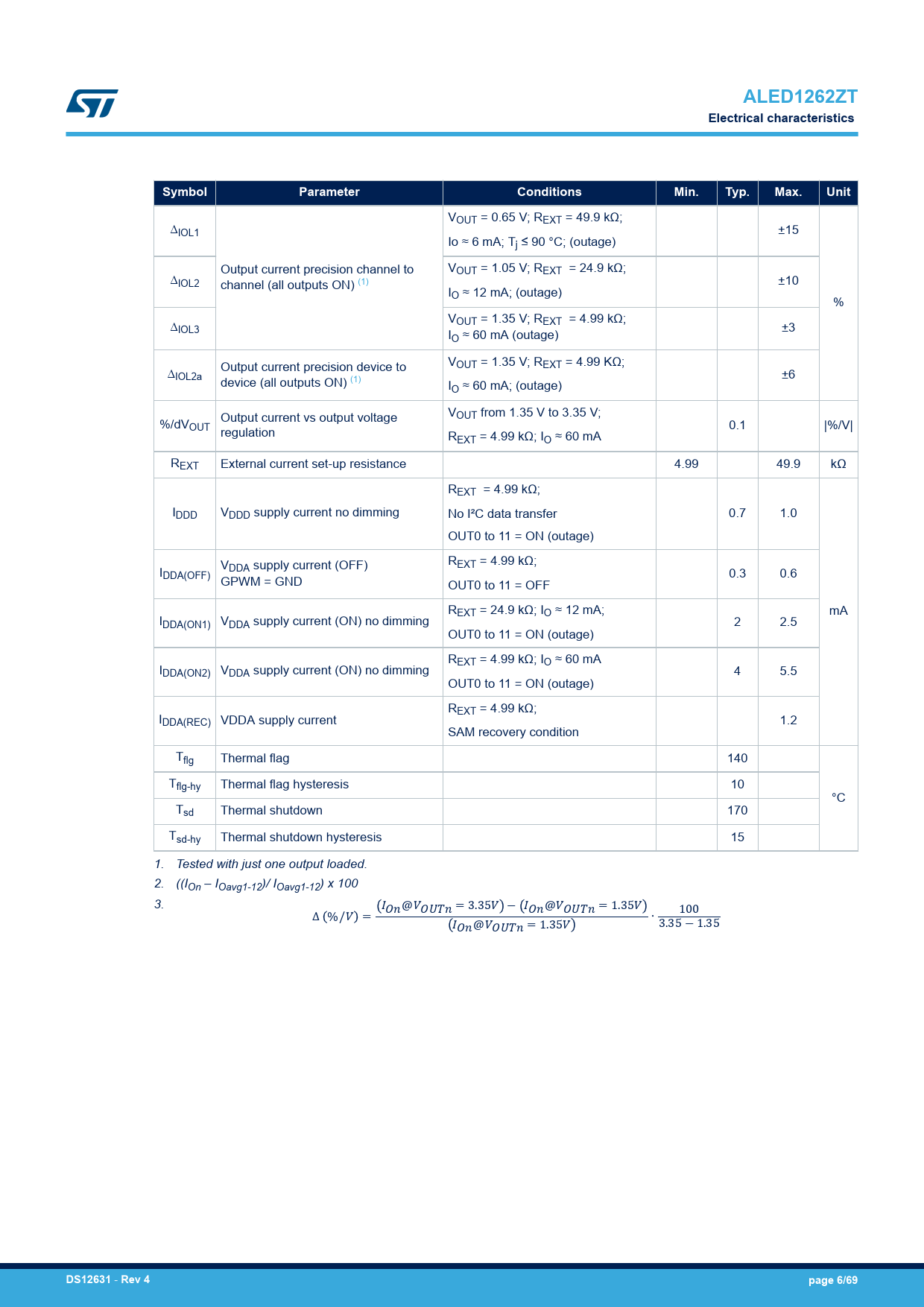

ALED1262ZT. Electrical characteristics. Symbol. Parameter. Conditions. Min. Typ. Max. Unit. DS12631. Rev 4. page 6/69
link to page 6 link to page 6
ALED1262ZT Electrical characteristics Symbol Parameter Conditions Min. Typ. Max. Unit
VOUT = 0.65 V; REXT = 49.9 kΩ; ∆IOL1 ±15 Io ≈ 6 mA; Tj ≤ 90 °C; (outage) Output current precision channel to VOUT = 1.05 V; REXT = 24.9 kΩ; ∆IOL2 channel (all outputs ON) (1) ±10 IO ≈ 12 mA; (outage) % V ∆ OUT = 1.35 V; REXT = 4.99 kΩ; IOL3 ±3 IO ≈ 60 mA (outage) Output current precision device to VOUT = 1.35 V; REXT = 4.99 KΩ; ∆IOL2a ±6 device (all outputs ON) (1) IO ≈ 60 mA; (outage) VOUT from 1.35 V to 3.35 V; %/dV Output current vs output voltage OUT 0.1 |%/V| regulation REXT = 4.99 kΩ; IO ≈ 60 mA REXT External current set-up resistance 4.99 49.9 kΩ REXT = 4.99 kΩ; IDDD VDDD supply current no dimming No I²C data transfer 0.7 1.0 OUT0 to 11 = ON (outage) V REXT = 4.99 kΩ; I DDA supply current (OFF) DDA(OFF) 0.3 0.6 GPWM = GND OUT0 to 11 = OFF REXT = 24.9 kΩ; IO ≈ 12 mA; mA IDDA(ON1) VDDA supply current (ON) no dimming 2 2.5 OUT0 to 11 = ON (outage) REXT = 4.99 kΩ; IO ≈ 60 mA IDDA(ON2) VDDA supply current (ON) no dimming 4 5.5 OUT0 to 11 = ON (outage) REXT = 4.99 kΩ; IDDA(REC) VDDA supply current 1.2 SAM recovery condition Tflg Thermal flag 140 Tflg-hy Thermal flag hysteresis 10 °C Tsd Thermal shutdown 170 Tsd-hy Thermal shutdown hysteresis 15 1. Tested with just one output loaded. 2. ((IOn – IOavg1-12)/ IOavg1-12) x 100 3. I ∆ %/V = On@VOUTn = 3.35V − IOn@VOUTn = 1.35V IOn@VOUTn = 1.35V ∙ 100 3.35 − 1.35
