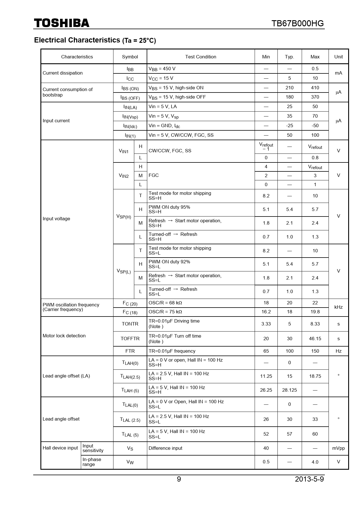

| Manufacturer | Toshiba |
| Description | Bi-CMOS Power Integrated Circuit Multi-Chip Package (MCP). High voltage 3-Phase Full-Wave Sine-Wave PWM Brushless Motor Driver |
| Pages / Page | 32 / 9 — Electrical Characteristics (Ta = 25°C) |
| File Format / Size | PDF / 464 Kb |
TB67B000HG
Characteristics Symbol Test Condition Min Typ. Max Unit IBB VBB = 450 V ― ― 0.5 Current dissipation mA ICC VCC = 15 V ― 5 10 IBS (ON) VBS = 15 V, high-side ON ― 210 410 Current consumption of bootstrap μA IBS (OFF) VBS = 15 V, high-side OFF ― 180 370 IIN(LA) Vin = 5 V, LA ― 25 50 IIN(Vsp) Vin = 5 V, Vsp ― 35 70 Input current μA IIN(Idc) Vin = GND, Idc ― -25 -50 IIN(1) Vin = 5 V, CW/CCW, FGC, SS ― 50 100 H Vrefout − 1 ― Vrefout VIN1 CW/CCW, FGC, SS V L 0 ― 0.8 H 4 ― Vrefout VIN2 M 2 FGC ― 3 V L 0 ― 1 T Test mode for motor shipping SS=H 8.2 ― 10 H PWM ON duty 95% SS=H 5.1 5.4 5.7 VSP(H) V Input voltage M Refresh → Start motor operation, SS=H 1.8 2.1 2.4 L Turned-off → Refresh SS=H 0.7 1.0 1.3 T Test mode for motor shipping SS=L 8.2 ― 10 H PWM ON duty 92% SS=L 5.1 5.4 5.7 VSP(L) V M Refresh → Start motor operation, SS=L 1.8 2.1 2.4 L Turned-off → Refresh SS=L 0.7 1.0 1.3 FC (20) OSC/R = 68 kΩ 18 20 22 PWM oscillation frequency (Carrier frequency) kHz FC (18) OSC/R = 75 kΩ 16.2 18 19.8 TR=0.01μF Driving time TONTR 3.33 5 8.33 s (Note ) Motor lock detection TR=0.01μF Turn off time TOFFTR 20 30 46.15 s (Note ) FTR TR=0.01μF frequency 65 100 150 Hz TLAH(0) LA = 0 V or open, Hall IN = 100 Hz SS=H ― 0 ― Lead angle offset (LA) TLAH(2.5) LA = 2.5 V, Hall IN = 100 Hz SS=H 11.25 15 18.75 ° TLAH (5) LA = 5 V, Hall IN = 100 Hz SS=H 26.25 28.125 ― LA = 0 V or Open, Hall IN = 100 Hz TLAL(0) SS=L ― 0 ― LA = 2.5 V, Hall IN = 100 Hz Lead angle offset TLAL (2.5) 26 30 33 ° SS=L LA = 5 V, Hall IN = 100 Hz TLAL (5) 52 57 60 SS=L Input Hall device input sensitivity VS Difference input 40 ― ― mVpp In-phase range VW 0.5 ― 4.0 V 9 2013-5-9 Document Outline TOSHIBA Bi-CMOS Power Integrated Circuit Multi-Chip Package (MCP) Features Block Diagram Pin Assignment Pin Description Absolute Maximum Ratings (Ta = 25°C) Operating conditions (Ta = 25°C) Package Power Dissipation Electrical Characteristics (Ta = 25°C) Functional Description Timing Chart of FG Signal Timing Chart 1: Output waveform of sine-wave PWM drive Timing Chart 2: Output waveform of sine-wave PWM drive Timing Chart 3: Output waveform of wide-angle commutation Timing Chart 4: Output waveform of wide-angle commutation Timing Chart 5: Output waveform of square-wave drive Timing Chart 6: Output waveform of square-wave drive Timing Chart 7: Output waveform of square-wave drive Timing Chart 8: Output waveform of square-wave drive Application Circuit External Parts Package Dimensions
