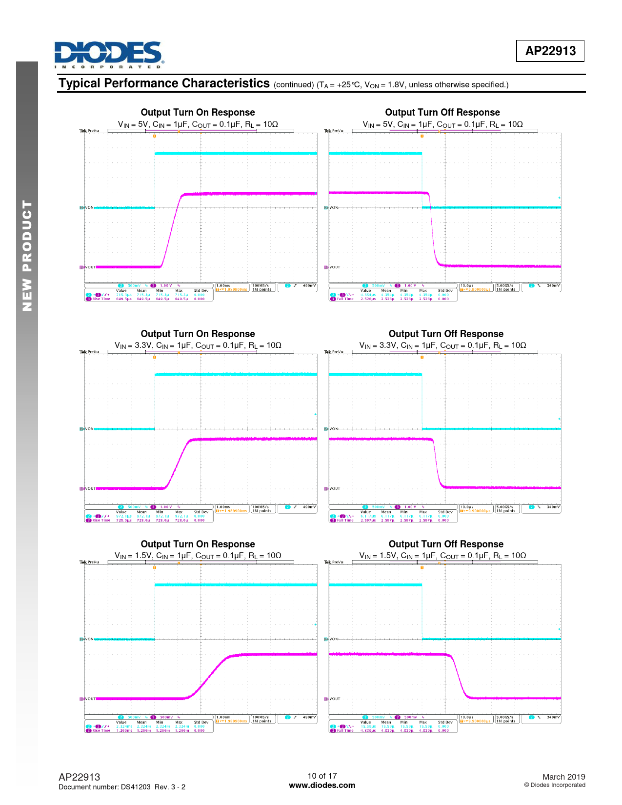

AP22913. Typical Performance Characteristics. Output Turn On Response. Output Turn Off Response. T C U D O R P W E N
AP22913 Typical Performance Characteristics Output Turn On Response Output Turn Off Response T C U D O R P W E N
(continued) (TA = +25°C, VON = 1.8V, unless otherwise specified.)
VIN = 5V, CIN = 1μF, COUT = 0.1μF, RL = 10Ω VIN = 5V, CIN = 1μF, COUT = 0.1μF, RL = 10Ω
T C U D O R P W E N Output Turn On Response Output Turn Off Response
VIN = 3.3V, CIN = 1μF, COUT = 0.1μF, RL = 10Ω VIN = 3.3V, CIN = 1μF, COUT = 0.1μF, RL = 10Ω
VIN = 1.5V, CIN = 1μF, COUT = 0.1μF, RL = 10Ω VIN = 1.5V, CIN = 1μF, COUT = 0.1μF, RL = 10Ω AP22913 10 of 17 March 2019 Document number: DS41203 Rev. 3 - 2
